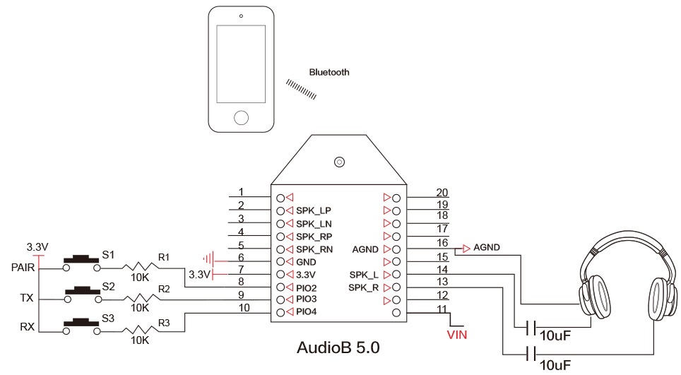

Problem solved it was enough to use a 10k resistor between KEYMOTE and VOL + (PIO2) by hitting the pin twice. I followed the image that was on the tinyshop store of the tsa6175
Now if I would like the pairing to always be active what should I change in PSTools?
Thanks for help
![AudioB5-2.jpg](https://www.tinyosshop.com/image/data/Audio/Audio%20receiver/AudioB5-2.jpg)
Now if I would like the pairing to always be active what should I change in PSTools?Thanks for help
Haven't really tried to have the module always being being in paring mode, but I think if you follow the two steps shown in the attached pictures that you can make it work. Just tick the boxes circled in red and remove the tick from the circle in orange (if you got that setting enabled). I think this will always set the bt module in paring mode, but I think the first one that connects to the module will be the desired source. This is why it's helpful to be able to reset the paring list. Give it a go and let us know how it went.

Hi! How to MUTE control the amplifier (TPA3116D2) from CSR8675 BT?
Many ways, depends on the amplifier, it it has LOW og HIGH logic for the mute. You can chose any GPIO. There is a setting for MUTE, so that the module will pull it high when the amplifier is muted. For the TPA311x you have to pull MUTE LOW. So an easier way is to connect it with a 1k to one of the LED outputs. Then use the "A2DP steaming" settings under LED events. This will mute the amplifer when you're not streaming music.
