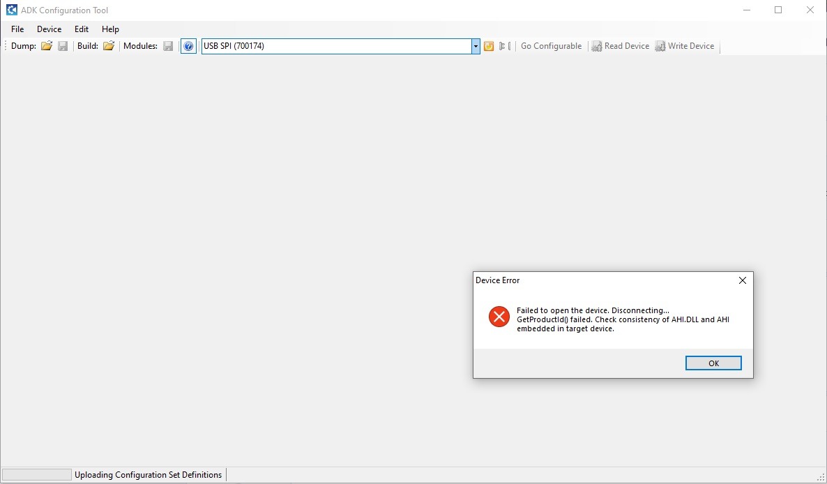

Well I was trying to connect to ADK and I get error:

Your error message literally tells you to check versions. Probably firmware was compiled with ADK different from that you're using.Well I was trying to connect to ADK and I get

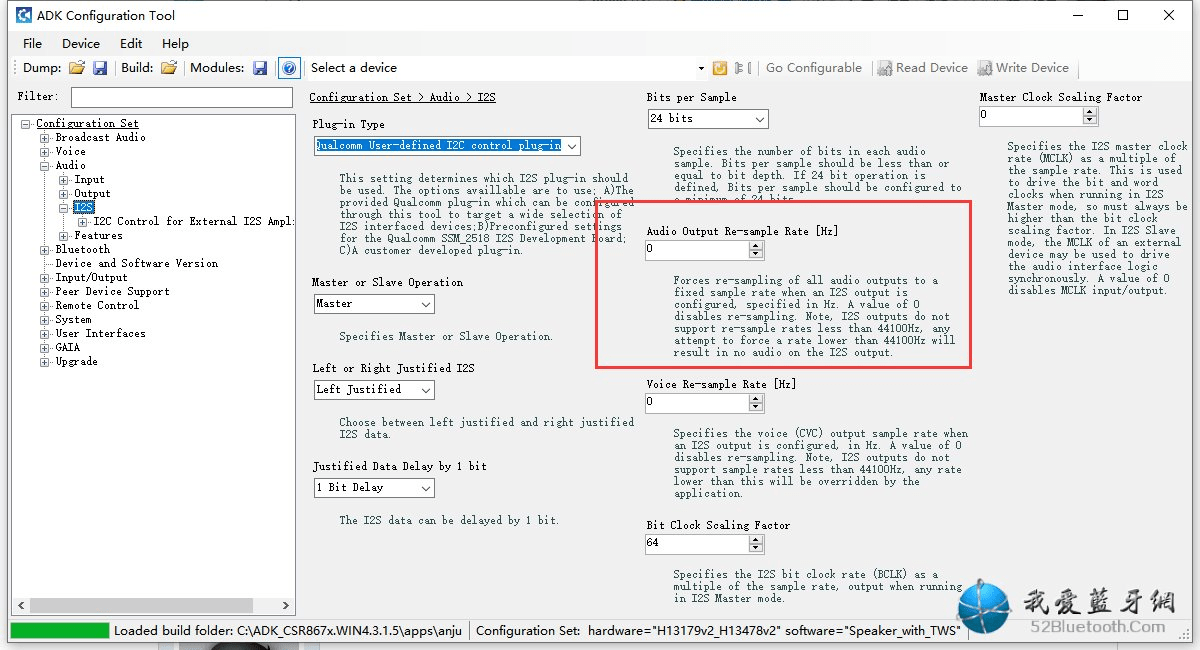

So in that window, 'Audio Output Re-Sample rate [Hz]' Can you put anything higher than 65535?
Cause I need 96000.. and I cant

Yes, looks like incorrect version is used. See the following picture, looks like that this is exactly what you need. View attachment 1089028 Check that version is the same (only way I know is to build firmware by yourself). Maybe you can try other ADK versions as well. Your's is 4.3, latest seems to be 4.4
I think I read somewhere on 52bluetooth that this frequency is not the actual sample rate, but rather SCLK. Do you have any way to verify what frequency I2S is running at?So in that window, 'Audio Output Re-Sample rate [Hz]' Can you put anything higher than 65535?

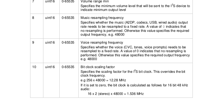

I found in one of PDF. Its for music and voice resampling but I guess its its set same way. 16bit value, 65535 max value.
For me it makes no sense.. in ADK config tool its written that if you set something lower than 44100 output will be silent, will not work.. so you can set resampling from 44100 to 65535??
Interesting thing is that you can set 96k resampling for analog and USB inputs in routing tab of ADK config tool.. makes no sense.
Im hoping that its something like SCLK as You say.
I will try to set it to 44100 and 48000 tomorrow and will see what happens

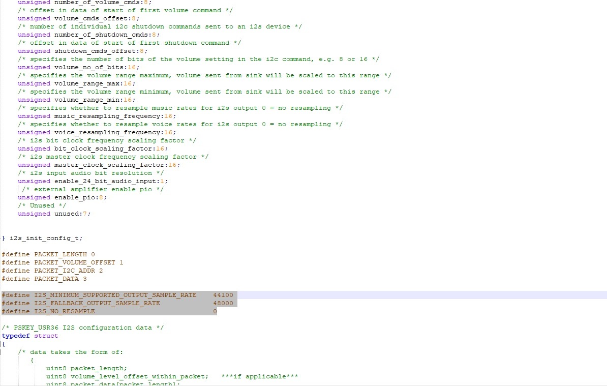

Edit .H files and try to force 9600khz there, build firmware, flash(?)
