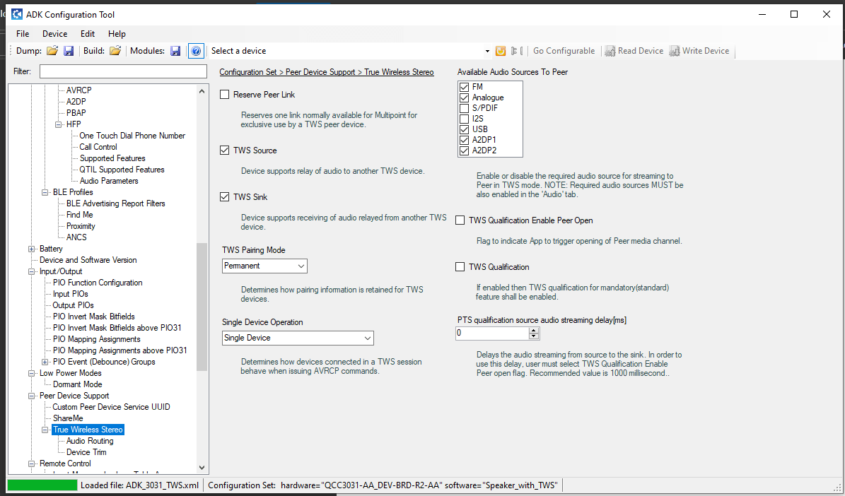

This is possible. Use earbud firmware in ADK 6.4Hello, is it possible to configure my two QCC3031 modules to function as earbuds?
One module will be on the right channel, the other on the left,
This is probably possible as well, but it may be required to modify firmware.and if one of them is turned off, the other will play music in mono channel mode.
how exactly can I do that do have any examples or the firmware that already has this featureThis is probably possible as well, but it may be required to modify firmware.
you mean this feauture here or i have to use other firmware to flash my moduleThis is possible. Use earbud firmware in ADK 6.4
No, I don't have any examples. Try using stock one and check what it is capable of.how exactly can I do that do have any examples or the firmware that already has this feature
You'll have to build firmware from sources or find it somewhere.you mean this feauture here or i have to use other firmware to flash my module
i found this one from the example folder maybe this is the oneYou'll have to build firmware from sources or find it somewhere.
Probably. There is a menu "New project" or something like that. It contains different firmware examples. There was earbud one, IIRC TWS speaker firmware also existedi found this one from the example folder maybe this is the one

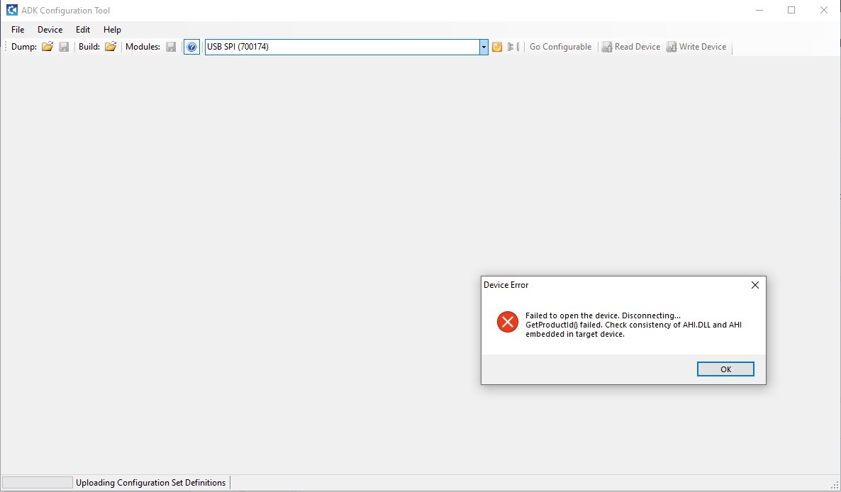

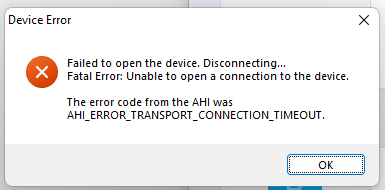

I have a problem with ADK Config Tool, when I try to select a device from the dropdown on the top after a while I get following error:
But xIDE and PSTool work fine, i mean those can connect to my CSR8675 chip.
Is this a common error or does this need more investigation?
I'm using ADK 4.4 and a development board with PWR connected to 1.8v, GND and SPI is connected via the development board.

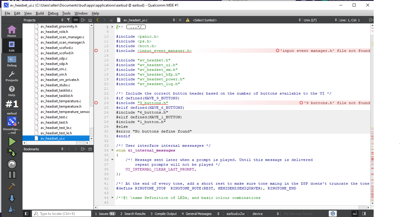

I installed ADK_QCC512x.WIN.6.4 for QCC5121 from Qualcomm's ADK_QCC512x.WIN.6.4 Installer_6.4.2.26.zip installer and I have the required MDE installations as well. My computer is Windows 10 64-bit. It turns out the ADK_QCC512x.WIN.6.4 is 32 bit (x86 platform, as it calls itself). I can build and download firmware into the QCC5121 board using this version of the software, but it is impossible to debug source code (unless I get a 32 bit version of Windows). Does anyone know if a 64-bit version of ADK_QCC512x.WIN.6.4 software is available? I know ADK_QCC512x.WIN.6.4 is an old version and all future firmware build software for QCC chips comes as ADK Toolkit installs instead (which are most 64-bit as far as I understand), but I am wondering if a 64-bit version of ADK_QCC512x.WIN.6.4 was also released at some point.
Is a 64-bit version of ADK_QCC512x.WIN.6.4 available? Or is it impossible to debug QCC5121 programs using ADK_QCC512x.WIN.6.4 in a 32-bit Windows computer? I hope somebody can shed some light into this.
Use MDE 2.3. It's 32-bit as well and it supports debugging.Is a 64-bit version of ADK_QCC512x.WIN.6.4 available?

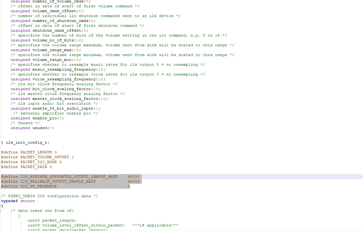

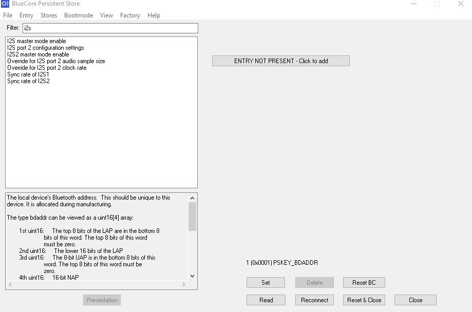

On which board?How to do resampling on this board so that output is always 24bt 96khz over i2s?
On QCC514x+ you will need to rebuild firmware, QCC512x is probably the same (or maybe look into ADK Config Tool). Just search for I2S output related stuff and modify accordingly. AFAIK sample rate is set in htf files while bit depth is in C code. On QCC3xxx it's going to be the same as on corresponding QCC5 board. In older CSR8 chips it's probably done using ADK Config Tool, but maybe firmware modification is necessary as well. I haven't worked with them, so don't know exactly.
Thanks for info. What u mean by 'htf' files? Where are they located? Or u mean .h files?On which board?
I am using CS8675, I been looking in PS Tools, and seems there is nothing interesting
So I tried to run ADK config tool, but didnt work.
Do I need to use older version? Or flash 'compatible' firmware to use?
(Or just add product ID in PS Tools - there was no value when I checked?)

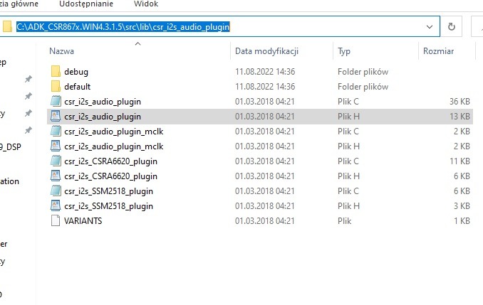

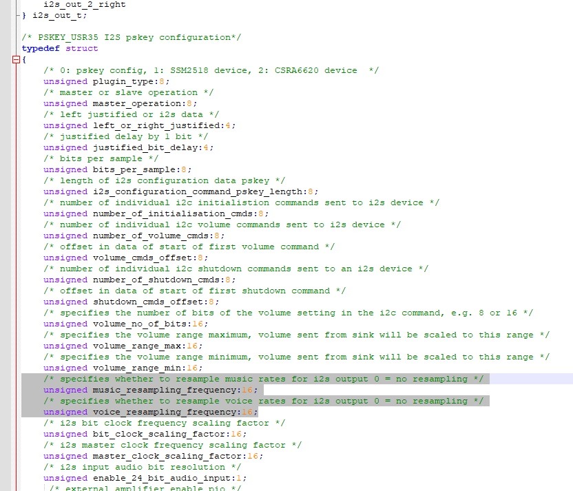

I also found pdf document from that big leaked leaked package on how to set I2s Master and Slave modes, it directed me to those files:
and when I open .H file
music resampling?
voice resampling?
BINGO??
