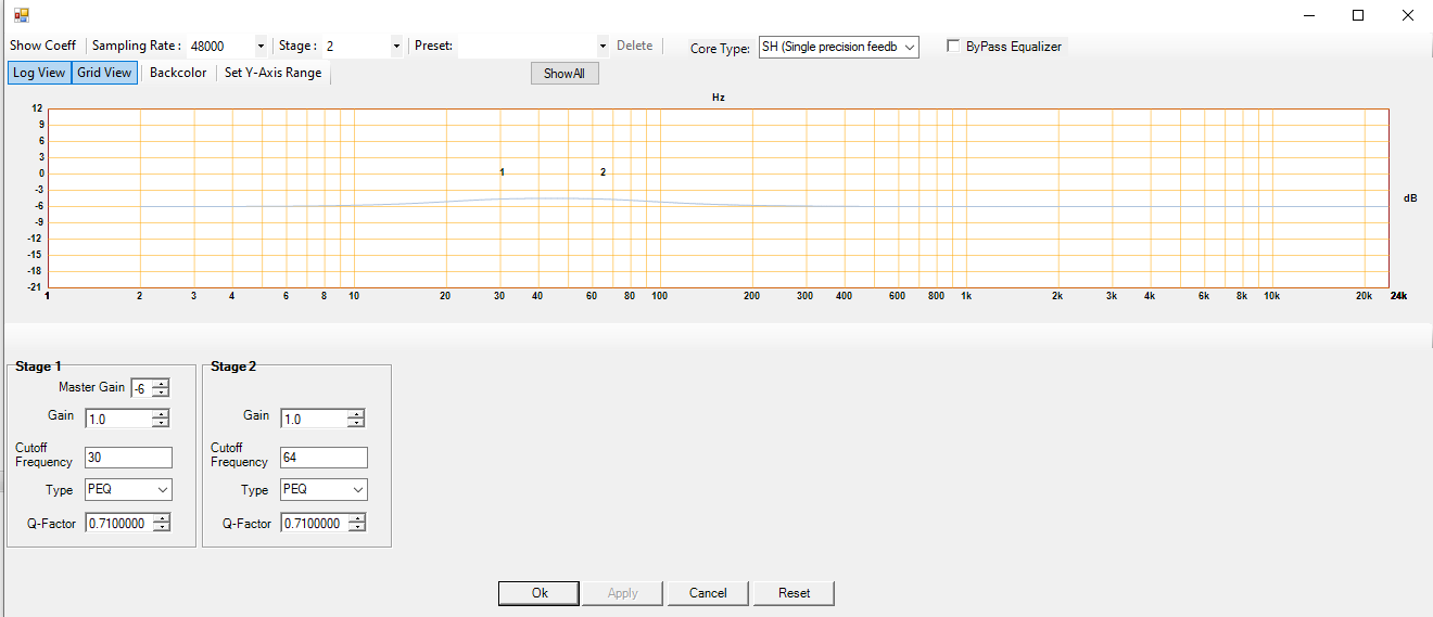

This one is can be used with @at ? https://www.audiophonics.fr/en/blue...dac-aptx-hd-aptx-adaptive-to-i2s-p-15375.htmlWell, Feasycom has QCC5141 module, this chip is basically the same crystal but with different packaging. But I'm not sure they support AT commands. You may ask them via email.
So either you use their QCC5125 module, which surely does, or hope that QCC5141 module does.
Other solution would be to go for BTM544 module, which is much more widely used across the industry, and implement the necessary features by yourself. If you're going this way, we may cooperate on that, I'd like to have UART control in my project too. It is not the easiest way, but if you want great EQ control, only QCC514x app (QCC5125 only has Android app, QCC514x+ have both Android and iOS) would give it to you.
IIRC they are using BLE.
Does it need to be preprogramed first to enable uart or uart is allready enabled and prepared for reception?
I don't think there exists any solution for this. Though I'd say it may be possible, but compared to implementing other AT commands via UART, it would be much harder, but probably still possible. You would have to examine code that is used for GAIA EQ control.control to eq too
Kind of. You will need to write custom firmware.This one is can be used with @at ?
If you're not going to use Feasycom's module, it's better to go for QCC5144
It will need custom firmware to be developed. It's not very hard, but consumes some time to get used to it.Does it need to be preprogramed first to enable uart or uart is allready enabled and prepared for reception?
QCC5125 version is available on Dropbox heaven for CSRWhere I can download GAIA app?
QCC514x+ version is harder to get, but you can download it here
To sum up, there are 3 possible solutions:
1. Just use off-the-shelf components (FSC-BT1026E). It doesn't have AT commands for EQ.
2. Use other QCC5125 module (BTM525) and develop custom firmware. Certainly not the best way, QCC5125 firmware architecture is generally bad.
3. Use QCC5144 module (BTM544) or QCC5171 (BTM571 as soon as it will be released) and develop custom firmware. I'd choose this one. EQ control in GAIA is much better than on QCC5125, as well as firmware architecture (so a bit easier to write code).

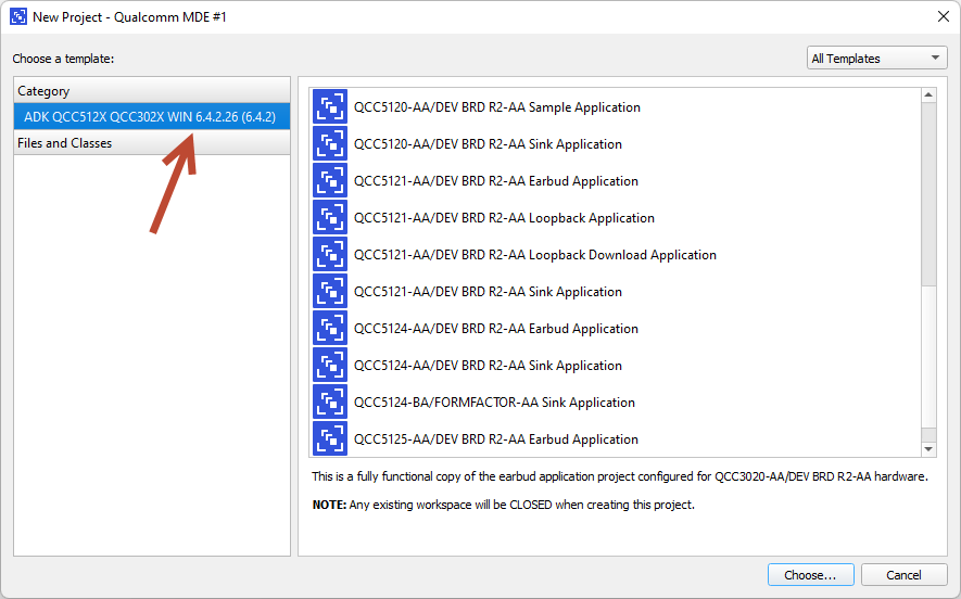

I have ADK Toolkit v1.2.9.25 installed from the link you provided.That's because you'll need different tools. ADK 6.4 is for QCC3034, for QCC5151 ADK 2x is used (not sure which ADK Toolkit versions correspond to that, but v1.2.9 is sufficient)
Also, I upgraded the MDE up to 2.7.1.41 from the same link.
In the MDE SDK list I have both ADKs.
Both devices, 3034 and 5151 detected by MDE.
I'm still able to compile 3034 sink application and deploy to device.
When I tried to create new project with 5151 device connected I do not see ADK 1.2.9 in template list and found any 5051 related template project.
I see only ADK 6.4 in template list.
Do I need install anything else? And actually any template projects available for 5151 specifically?

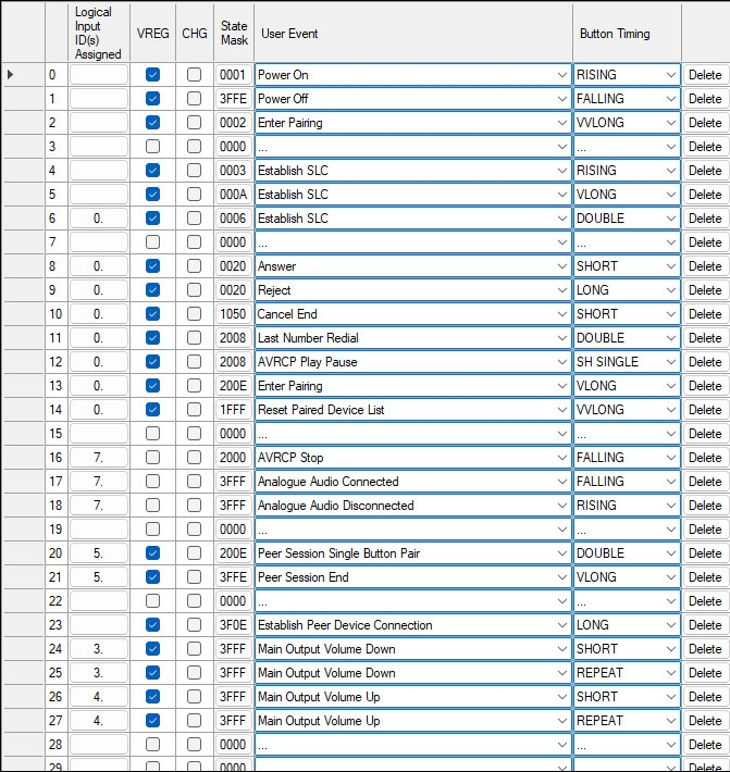

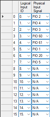

I have my own HW carrier board for BTM*** modules and would like to use these events and GPIO assignments as I used on 3034.
That's because it doesn't exists. Apparently, the distribution model has changed: ADK Toolkit and firmware source code are separate things now.When I tried to create new project with 5151 device connected I do not see ADK 1.2.9
You can find firmware source code (adk-src-1-0_qtil_standard_oem.7z) at the same link. There's also qcc5151 headset source firmware (qcc5151_headset_test_r00285.part*.rar). You'll need to open corresponding x2w file in MDE and compile it. By default TWS requires modules to have their BT address differ by one, so you'll need two different XUV files for each module.
Afaik you'll have to build firmware from source. IIRC that's subsys7_config5.htf and subsys1_config2.htf files.Idea was just read configuration area from existing image, specifically BT device name and MAC, modify it and program back.
This tool is for older QCC512x/302x/303x. In newer QCC5151 you can refer to earbud_ui_config.c and *.buttonxml files for setting up PIO.and would like to use these events and GPIO assignments as I used on 3034.
I would suggest you to spend some time just looking into different files so that you'll know what's where.

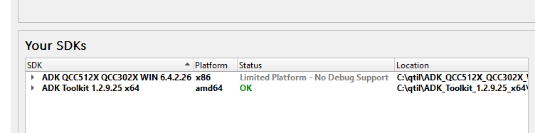

The new convention is like this:I have ADK Toolkit v1.2.9.25 installed from the link you provided.
ADK (upto 6.x for QCC512x and older): has compiler + source code
ADK Toolkit (for QCC514x and above): has compiler only
For this you need to buy source code separately from Qualcomm, or look for source code files shared by others (look in the last post of o11111 (take note: just source code files might be as big as 200 to 400 MB, and after compile the entire project workspace can reach close to 1 GB)

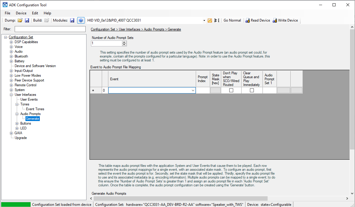

That looks like configuration tool for older ADKThank you for your notes and links. It's very helpful. My final goal to build fully functional TWS earbuds with I2S outputs and all functionality similar like some developers sale 3034 modules from Ali. I played with these modules and got them configured using ADK Config and QCC Tool per my choice.
Tried to do the same with 5151 modules, but possibly proper TWS dump not exists yet and I need to develop it.
Appreciated for any heads up in this direction.
New ADK Toolkit based development environment does not have that kind of configuration tool (at least not yet as far as I know). At the moment, for QCC514x and above all configuration is done through XML files in source code.
The older configuration tool will probably not work with new QCC chips.

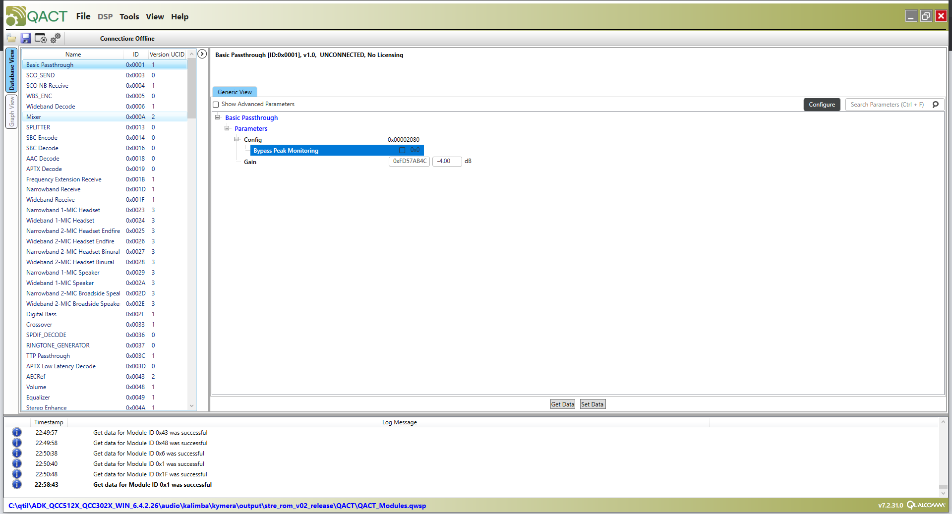

Well, good luck with that. Use C://qtil/ADK_QCC512X_QCC302X_WIN_6.4.2.26/tools/bin/voice_prompt_tool.exe for creating prompts and replace original ones in apps/applications/sink/sink_prompts/. After that rebuild firmware and flash it.how to add custom audio file
is this tool used with cmd? and do you have any instructions or guidevoice_prompt_tool.exe
And how can I rebuild the firmware?After that rebuild firmware and flash it.
I'm a newbie so I don't have any clue how to build firmware of my own can you also give me instructions on that
I have ADK_QCC512X_QCC302X_WIN_6.4.2.26 and MDE_WIN_2.2.0.68
Thank you
Yesis this tool used with cmd?
Run it in cmd, it will print available optionsand do you have any instructions or guide
Create new project in MDE and press "Deploy all".And how can I rebuild the firmware?
ADK is fine, MDE is a little bit old, but that's fine. You can download v2.3 hereI have ADK_QCC512X_QCC302X_WIN_6.4.2.26 and MDE_WIN_2.2.0.68
I haven't used this version of the QCC chip or ADK, but the screenshot looks like it is similar to the configuration tool for the CSR8675 ADK4.x seriescan anyone tell me how can I change the event tones with my custom audio file in the ADK Configuration tool? I can change the volume or the tone event with built-in audio promt but i dont know how to add custome audio file .
Thanks all
If you look for older CSR8675 documentation shared somewhere in this thread there should be a document called ADK voice prompt tool or ADK audio prompt tool or something similar. I will try to find it for you if I can, but in case you can find it faster It should have step by step instructions on how to convert wav file into the audio prompt format used by the chip. Then you probably need to rebuild the source code with the audio prompt file in the correct folder and download the firmware.
Even if you scroll down in the window screenshot you posted, you should see some other options for converting wav file to audio prompt; I think I can see a "Generate Audio Prompt" heading there.
For ADK6.x specifically look for a document 80-CF084-1 "Customizing Voice Prompts Application"
