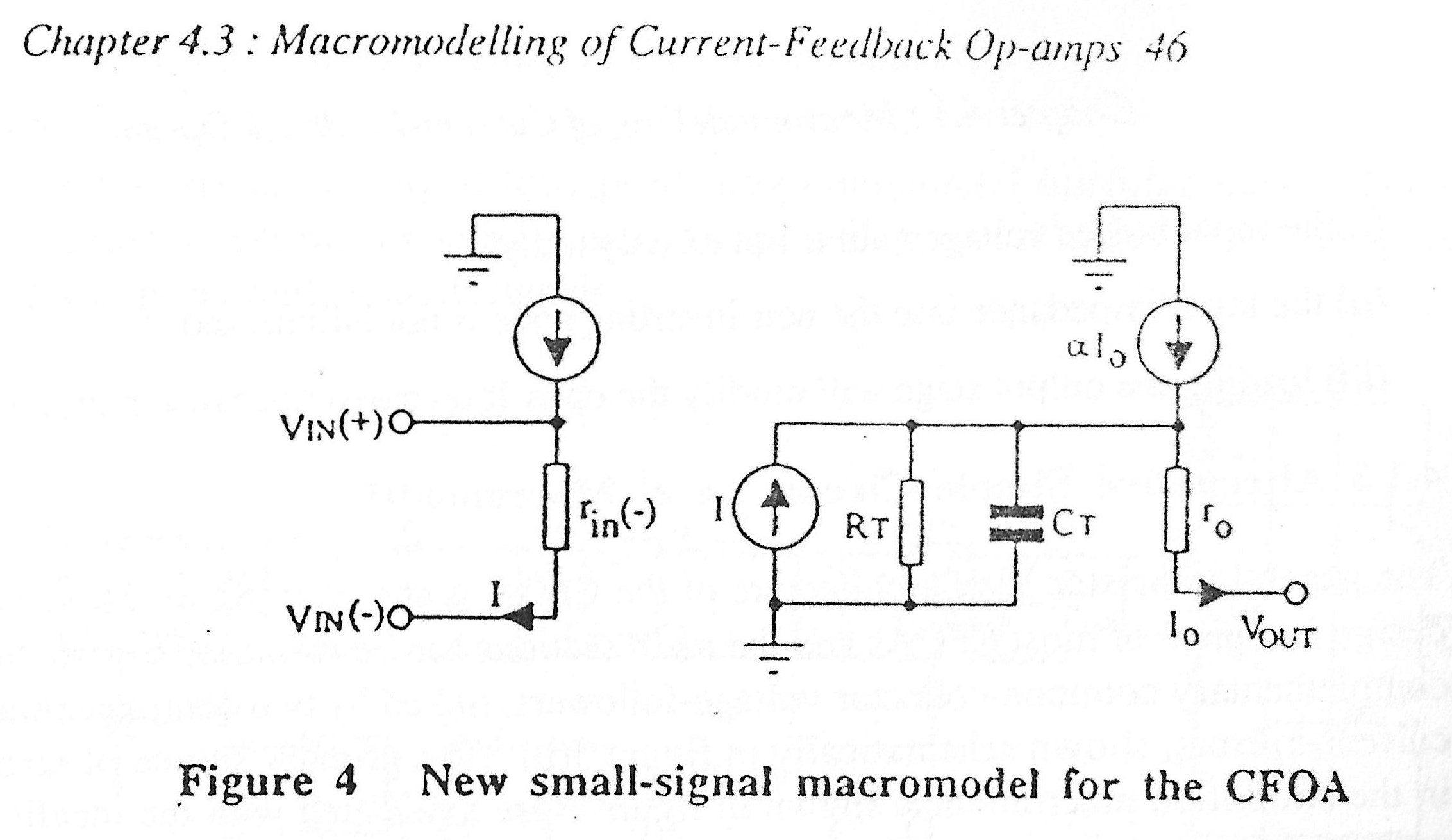

The CFA has forward V amp path with V fb? The input is an EF, a voltage buffer. But the current mirrors, CM, convey current to the comp cap in the next stage, so this is a transadmittance function. The comp cap stage receives current as its input from the CM, then outputs a voltage, making it a transimpedance stage. The output stage is an EF, a voltage buffer. The forward path is V-V/TY/TZ/V-V, overall a voltage is inputted and a voltage is outputted.This is incorrect. The type of amplifier is established by consideration of the transfer function of its forward path.
On the other hand, the type of feedback enjoyed by an amplifier is defined by by the feedback transfer function:
1) voltage feedback for an amplifier with a voltage amplifying forward path.
2) transimpedance feedback for an amplifier with a transadmittance forward path.
3) transadmittance feedback for an amplifier with a transimpedance forward path.
4) current feedback for an amplifier with a current amplifying forward path.
Now, a so-called "CFA" has a voltage amplifying forward path with voltage feedback: it is therefore a voltage feedback amplifier.
The so-called "CFA" does NOT "process" an error current.
The feedback from the output EF is realized by the current in Rf. You opined that the current In is merely the Vn value divides by the Thevenin impedance at the node. But this cannot be true if you examine it. The Thevenin Z at the - input is typically 3 to 5 ohms. In parallel w/ the feedback resistors, let's say 1.0 kohm for both, we get 500 ohm || 5 ohm, or 4.95 ohm. If the fb resistor pair is doubled to 2.0 kohm, the slew rate gets halved. Did the Thevenin Z get doubled to account for it? No, the Thevenin Z is 1.0 kohm || 5 ohm = 4.975 ohm, hardly different from before. Yet the slew rate and BW halved.
Your theory that the error is voltage and that the fedback current is merely the V divided by Thevenin Z holds water like a net. Take 2 identical CFA, 1 w/ 1.0 kohm fb pair, 1 w/ 2.0 kofm pair. The smaller values slew twice as fast, yet according to you, the error signal is the same for both, a voltage w/o regard to any resistance value. Clearly the resistance impacts the error signal because lower R values slew faster. The error signal cannot be a voltage because it's the same for both.
Likewise, Thevenin Z hardly changed from 1.0 to 2.0 kohm, yet sle rate & BW are a factor of 2 apart. You have no case at all.

The current sunk or sourced by the inverting input of a so-called "CFA" is a function of the Thevenin impedance "seen" by that port to ground. It is not an error signal.
The error signal is the difference between the input voltage and the feedback voltage; this is then amplified by the input stage transistor(s) to produce changes in their collector currents which changes are level shifted by the current mirrors to the load.
No "level shifting" at all here. Collector current value in 1st stage EF gets conveyed over to the comp cap in the TZ stage w/o any level shifting. Where are said level shifting components? This is totally off the wall.

No I don't see "level shifting". As far as "Vin-Vfb" goes, the voltage at the - input is not "feedback voltage", Vfb. I don't see it, nor the level shifting. Level shifting is displacing a signal by some amount. An example is using a FET gate driver designed for driving a grounded N-Fet, to drive a high side N-FET. The gate drive signal must be level shifted upward wrt ground.
How does a current mirror "level shift"? The value of current, dc plus signal, is conveyed to the comp cap w/o adding or subtracting anything. No level shifting at all.
Again, Vn is not a fb voltage. The Thevenin Z is so low at this node, the voltage at - input is dictated by the input driving the EF buffer. Vn is a buffered input voltage Vi. It differs only in voltage offset since a diamond buffer has 2 pair of bjt vs. 1 pair in a VFA. So I do not believe that Vn is a "feedback voltage Vfb". You assume that but cannot explain how the servo loop speed increases w/ lower Rfb. Clearly there is more going on than wghat you describe. Sketches and computations would help. Please show us how the servo loop gets perturbed when loading or input change, then show how the loop corrects the output. Include the error signal and computations. I did so in 2004-06 and in 7 yrs. you have never submitted a rebuttal. Thanks in advance for your help. BR.

Leach's analysis is just wrong, the forward path has no dependence on the feedback network. Cherry is just narrowly interested in audio, academic with no commercial potential. Let's avoid the yellow snow while we're at it.
I also feel I have wrapped my head around this constant bandwidth thing.
Imagine a CFA with feedback resistor Rf and resistor to ground Rg. The loop gain/error current runs through Rf and the inv input node; it does not run through Rg because Rg is in parallel with the inv node input Z which is at least an order of magnitude smaller than Rg.
So the loop gain depends only on the various paths in the chip and Rf, so for a given Rf the BW and distortion characteristics are fixed, independent of Rg!
But, you can still modify the voltage gain of the whole circuit by modifying Rg.
So this gives you a circuit where you can modify the voltage gain with constant BW and linearity!
Some call this an advantage, but Mike has a point when he sees it as a disadvantage: in a VFA, when you decrease the voltage gain you get wider BW and lower distortion. This doesn't happen with a CFA.
