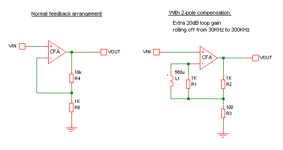

You really can't have double pole compensation with the traditional single gain stage "CFA" with current mirrors as the minor loop requires an inverting gain stage to work. That's my point.
Yes you can, even with the CFA opamp chips. Here's an example of how to do it:You really can't have double pole compensation...
edit: That example assumes the input impedance of the inverting input is zero. If it's 50 Ohms, set R2 = 470R, R3 = 47R.
Yes, same shunt cap in each case.

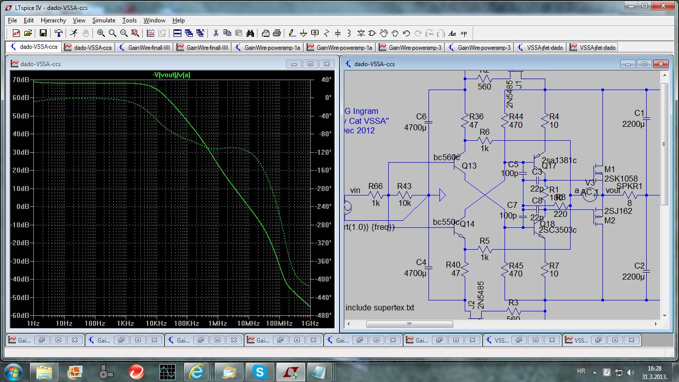

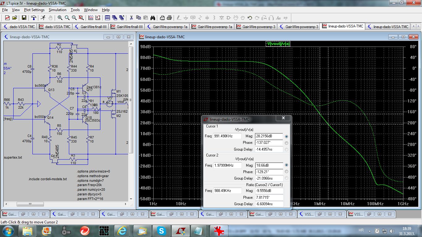

How you then explain difference in Loop Gain between those two simulations, one with MC other with TMC? Distortion at 20kHz is down by 14dB compared with MC.

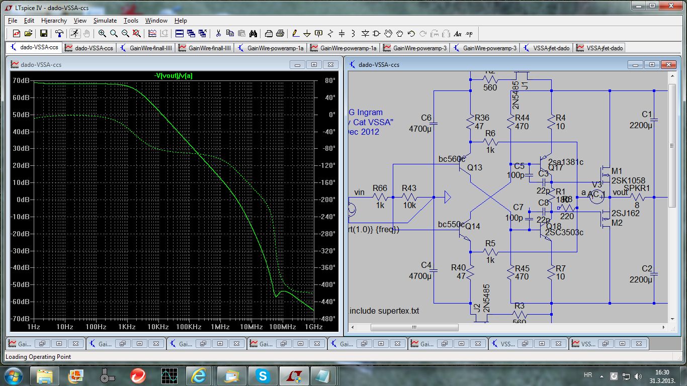

Before explaining anything (and talk about a 10MHz ULGF), put some resistors in the MOSFET gates.
All i can see is a single pole roll off in both cases.

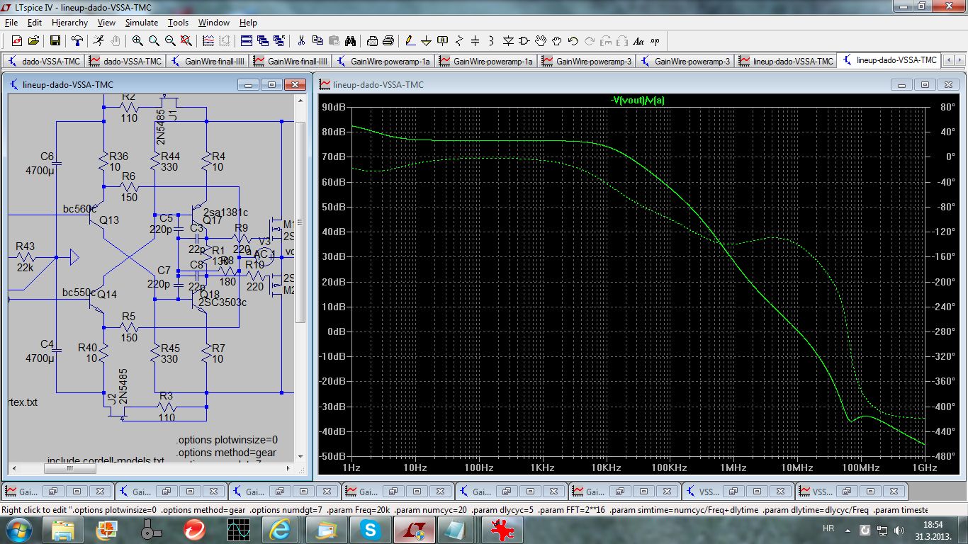

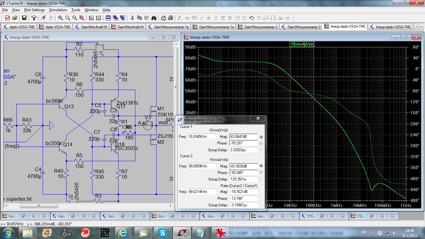

OK here the amp is a bit change and it's possible to see that there are two poles, and Loop Gain bandwidth is extended from 2kHz to 11kHz (-3dB).
By the way this was quick TMC component selection, it could be better optimized
This is just simulation and adding the gate resistors does not change much.
