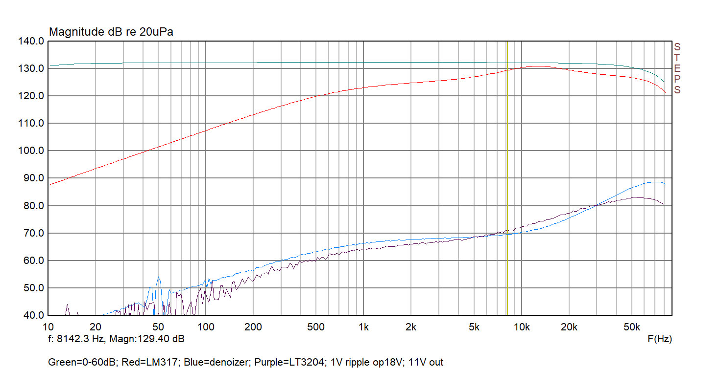

This measurement shows the noise profile of the denoizer against a state of the art linear regulator, the LT3042.
I decided that measurements against a bare LM317 were useless, so I mounted an LT3042 next to the 1000x head amp and made it switcheable.
The 50Hz and its harmonics are because of insufficient shielding of the denoizer. It is not because of lacking PSRR as the following measurements will show.
![linear supply baseline.jpg linear supply baseline.jpg](https://www.diyaudio.com/community/data/attachments/747/747081-f1a62993898eb4f21f599e8da778c337.jpg)

For the following measurement I constructed a dirty power supply out of a LM3886. I can superimpose an arbitrary signal on top of a DC voltage. For this measurement, a 1 V RMS ripple (2.8V peak to peak) was superimposed on a 18V DC voltage.
Since the AC output of the regulators gows through a 1000x amp, the top line (AC input) is actually 60dB higher than shown. PSRR at a given frequency is the difference between the AC input and the plot for the given regulator.
I show both measurements because there were fluctuations using different measuring systems.
It is fair to say, that the denoizer is at least at par with the LT3042 in audio frequencies. These measurements also show that the 50Hz bump is caused by pick up.
In order to improve these measurements, I will have to increase shielding and do manual sweeps at higher frequencies. There are also other indications that the denoizer performs less well at higher frequencies than the LT3042. The sims also show an increasing covergence between bare LM317 and denoizer above 100 kHz

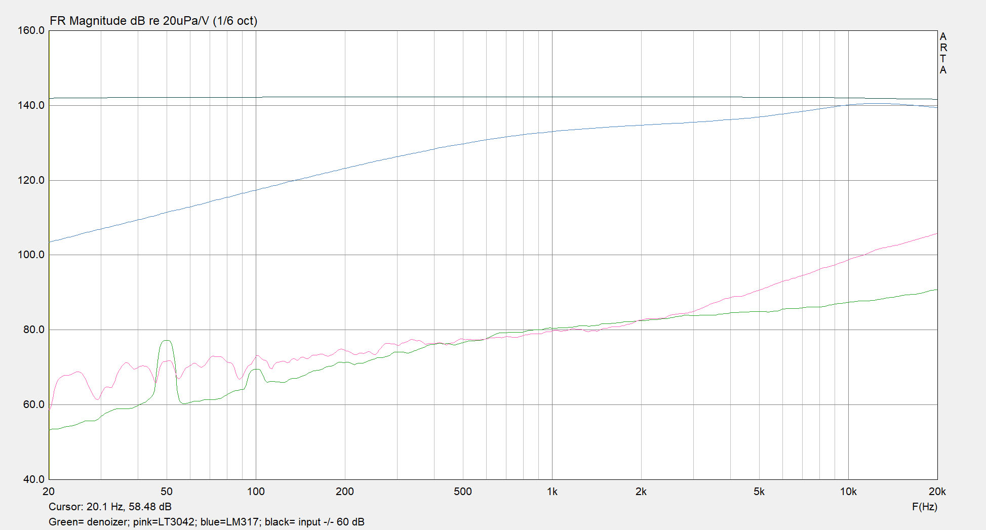

![plots18V+1Vripple.jpg plots18V+1Vripple.jpg](https://www.diyaudio.com/community/data/attachments/747/747086-29671266496ed4134b74d963690799f9.jpg)
![Plots18tot20K=kHz.jpg Plots18tot20K=kHz.jpg](https://www.diyaudio.com/community/data/attachments/747/747096-182e87e718c9bea75c3e22e665de1d51.jpg)

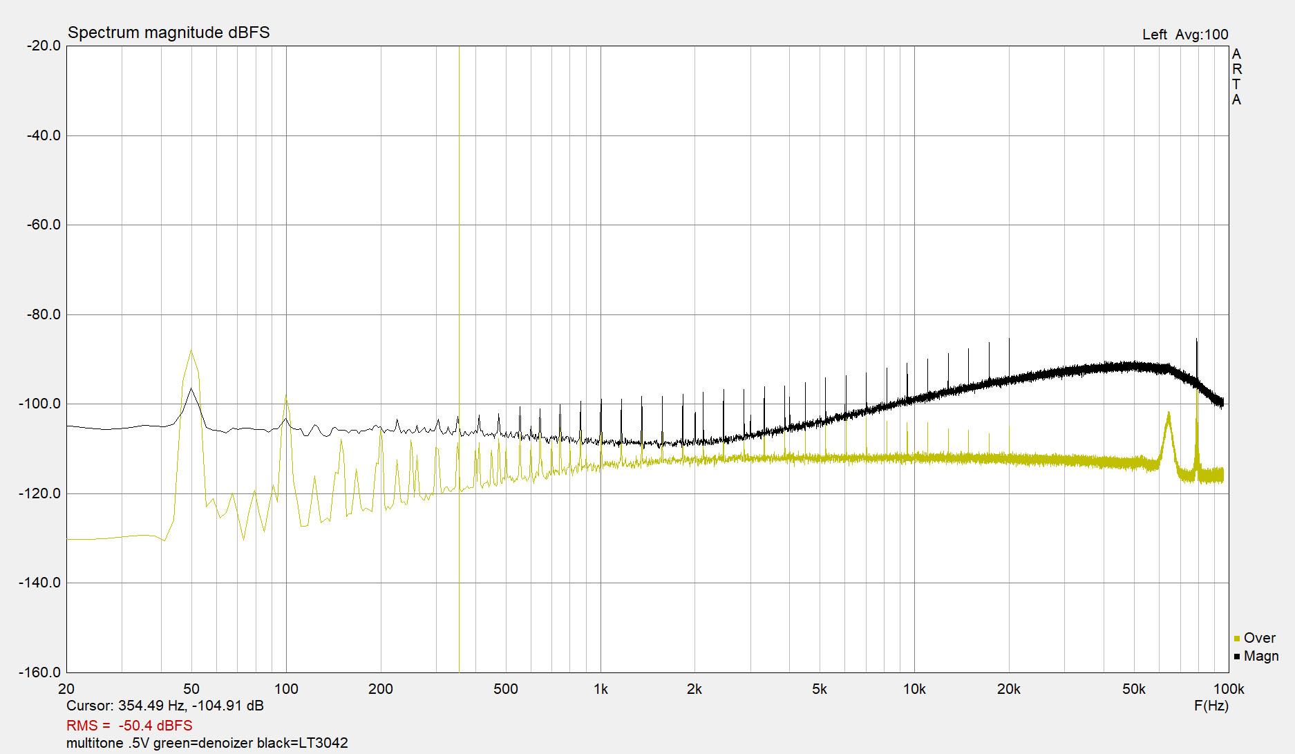

Finally, in order to see the possible effects of multiple tones, I put a multitone on top of the DC voltage. It clearly shows the superiority of the denoizer. The bumps after 50K are noise shaping artifacts of the converter. Even the artifacts of the denoizer stay well under the noise of the LT3042!

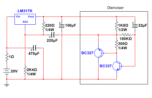

Try this very simplified second version of the Dienoiser (only for dirty test). The 47 ohm resistor has been suppressed, allowing the PSRR to be increased by approx. 1.26 dB within much of the audible band (as long as the regulator output is never short-circuited). An RC filter has been added to the regulator input, significantly improving the PSRR at high frequency. I have considered that the 22 nF capacitor may not be strictly necessary, although it should be tested in the workbench.
Slightly altering the value of the 300 ohm resistor could improve the PSRR curve. Possibly, between 330 and 390 ohms changes can be noticed, although it should be tested in the workbench.
The two protection diodes around the LM317K have not been drawn, for mayor clarity.
The 1 ohm resistor should be around 10 W @ 1,5 A max. output current.

That is why, Elvee, which I suggested to vacuphile to short-circuit the 300 resistor between base and emitter of the PNP transistor, as to carry a double test in one (both the Denoiser and the Dienoiser)
Elvee, Diego,
I think my measurements show a difference in PSRR of almost 60 dB between a LM317 with cap and the Dienoizer. At 1kHz, the PSSR of the Dienoiser is 190-65=125dB.
I have a question for Elvee. I work with BC549/560, a low noise high Hfe combo I know well. However, you suggested that there would be better transistors out there. What could be improved?
As soon as I have time, I will see what the difference is of shortening the 300 Ohm resistor. The value of which, as measurements of some values have shown, is not all that critical after all. Once I can start testing I will see if I can make a little overview.

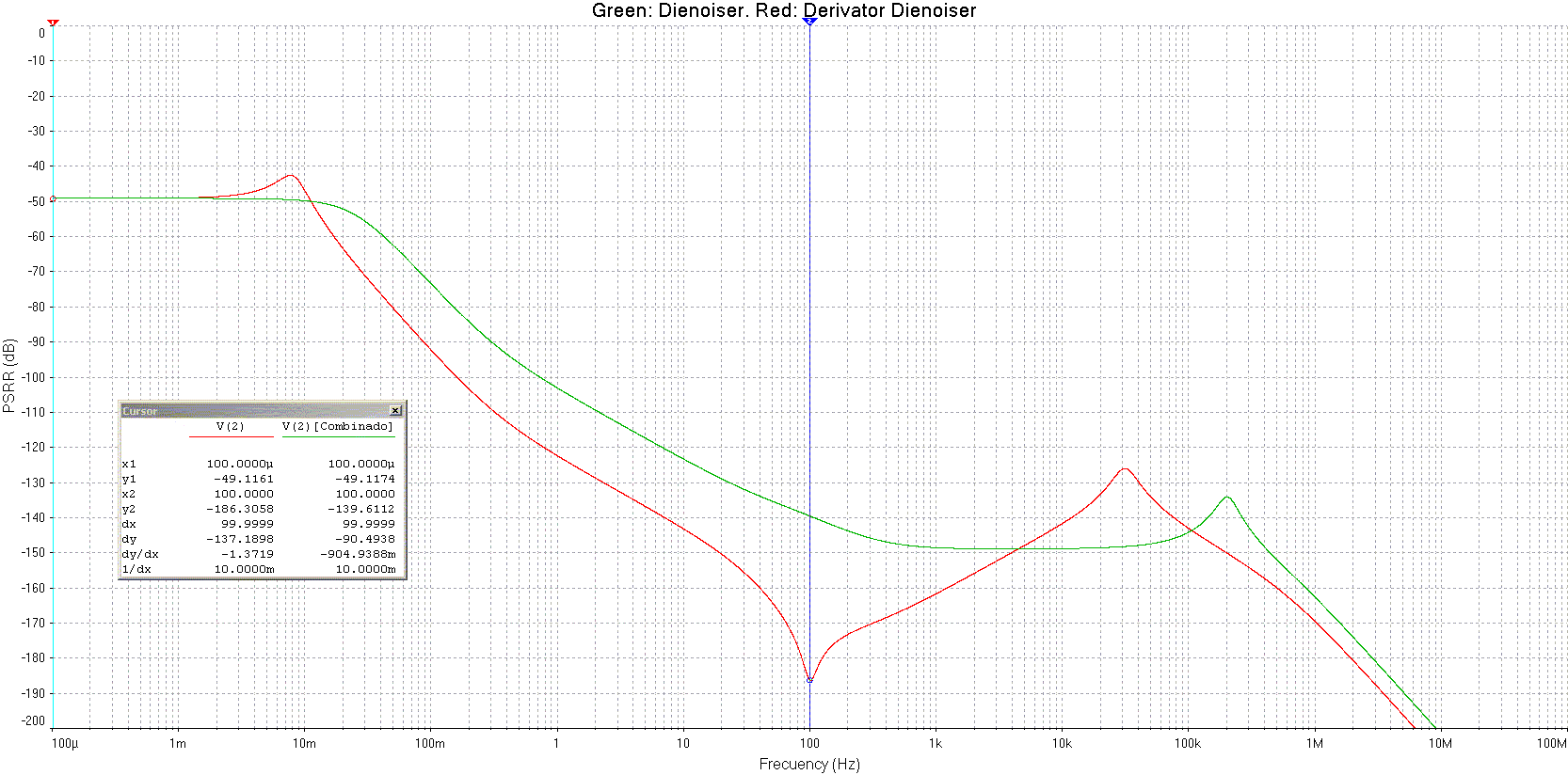

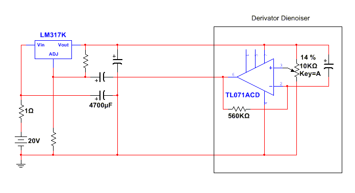

Derivator Dienoiser
Derivator Dienoiser

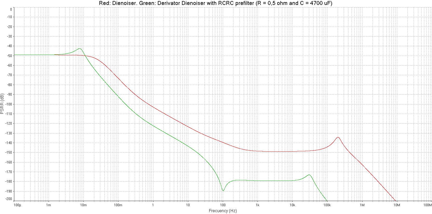

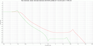

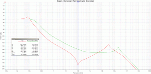

What about this?
With RC prefilter. R = 1 ohm and C = 4700 uF:
With RCRC prefilter. R = 0,5 ohm and C = 4700 uF:
