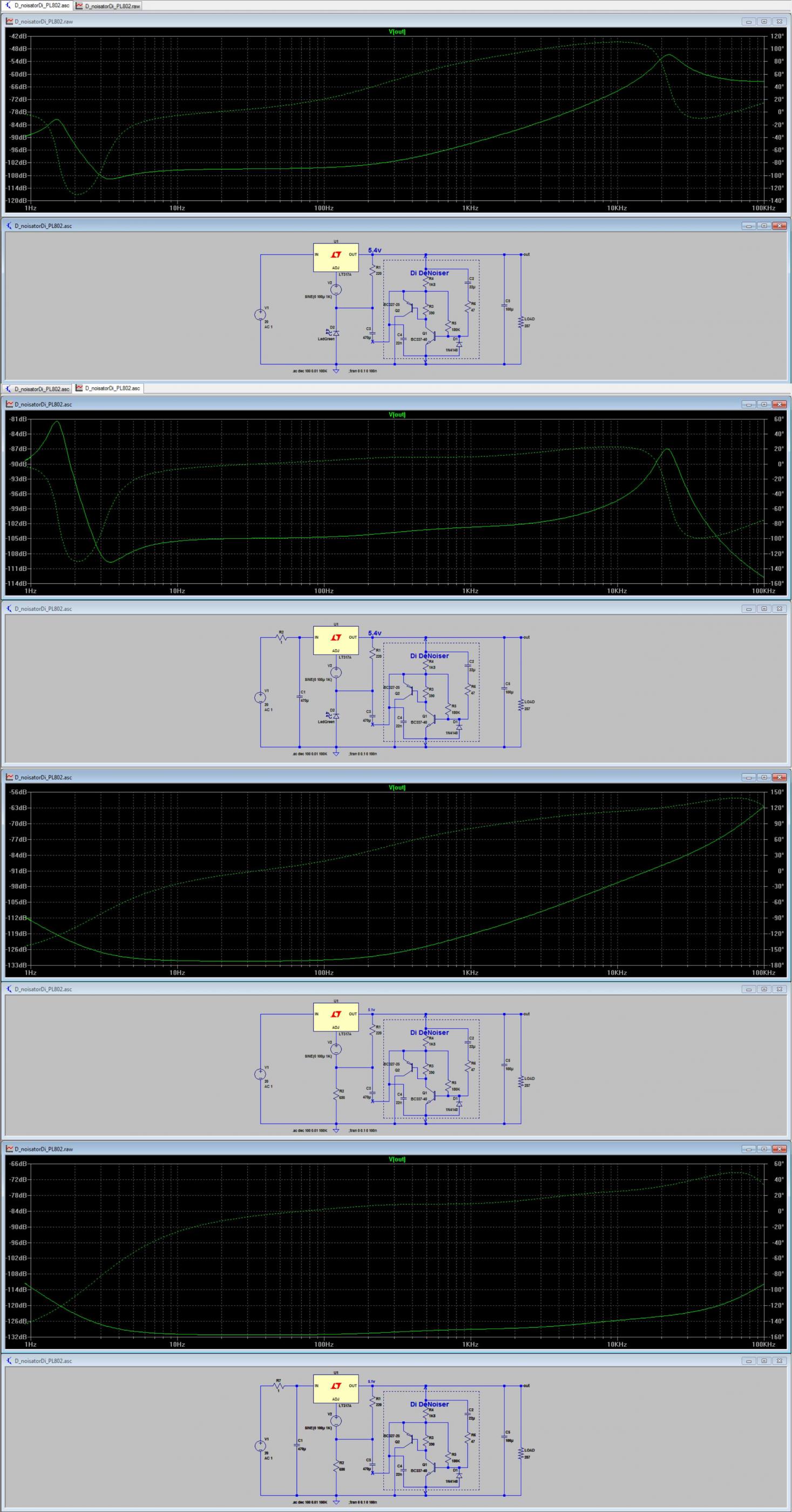

With RC prefilter. R = 1 ohm and C = 4700 uF:
With RCRC prefilter. R = 0,5 ohm and C = 4700 uF:
The 10K trimpot setting allows you to find the most optimal rejection point.
Is it not surprising?

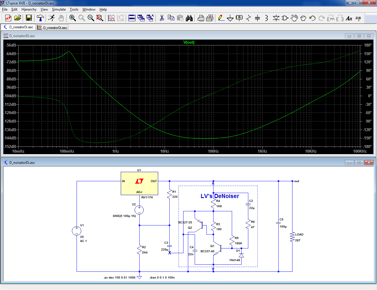

Without compensations, I predict huge stability problems, and the scheme will only work for PSRR and impedance, not noise: an opamp, even a good one is noisier than a transistor, even a humble BC337
What compensations would you suggest?
I did simulate Diego's regulator, and in fact noise is not as good as a simple Noisator, even using a low noise chip like the LT1115, which is available in LTSpice.
But impedance is the lowest I have ever seen, reaching nOhms on certain frequencies.
You could start with a cap in // with the 560K, and a resistor in series with the input cap.What compensations would you suggest?
Note that even if it looks stable in .tran, that doesn't guarantee the stability of the actual circuit.
It has to be tested for real.
Yes, the gain of an opamp is huge compared to one or two transistors, the question is: will all this gain be usable?But impedance is the lowest I have ever seen, reaching nOhms on certain frequencies.
OK, that matches my measurement on the nonoiser, which is very comparable to the Dienoiser
Practically any medium-power transistor would do better. A cheap and easy upgrade is the BC337, but many are even better: the ZTX851, of course because of its record Rbb value, but many low-noise alternatives exist like 2SC6043 or the good old 2N5401.
Even a cheap Chinese S8050 is significantly better than a BC337.
Note that if you use a very high performance device like the ZTX, the 47 ohm protection resistor will become the main noise source, and should be reduced to 22 or 10 ohm

Note that using a non-linear component as R2 will seriously blunt the performance of the Die- or Denoiser: it will shunt its output with a low dynamic impedance of forward-biased diodes.
Time to remind that the denoiser (and the Dienoiser) should only be applied to plain-vanilla regulators (as per datasheet examples)

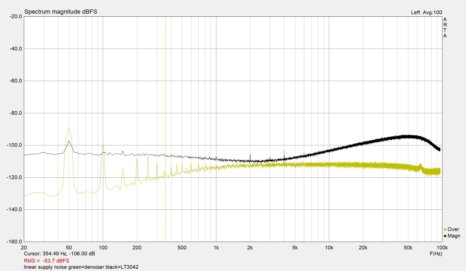

This measurement shows the noise profile of the denoizer against a state of the art linear regulator, the LT3042.
I decided that measurements against a bare LM317 were useless, so I mounted an LT3042 next to the 1000x head amp and made it switcheable.
The 50Hz and its harmonics are because of insufficient shielding of the denoizer. It is not because of lacking PSRR as the following measurements will show.

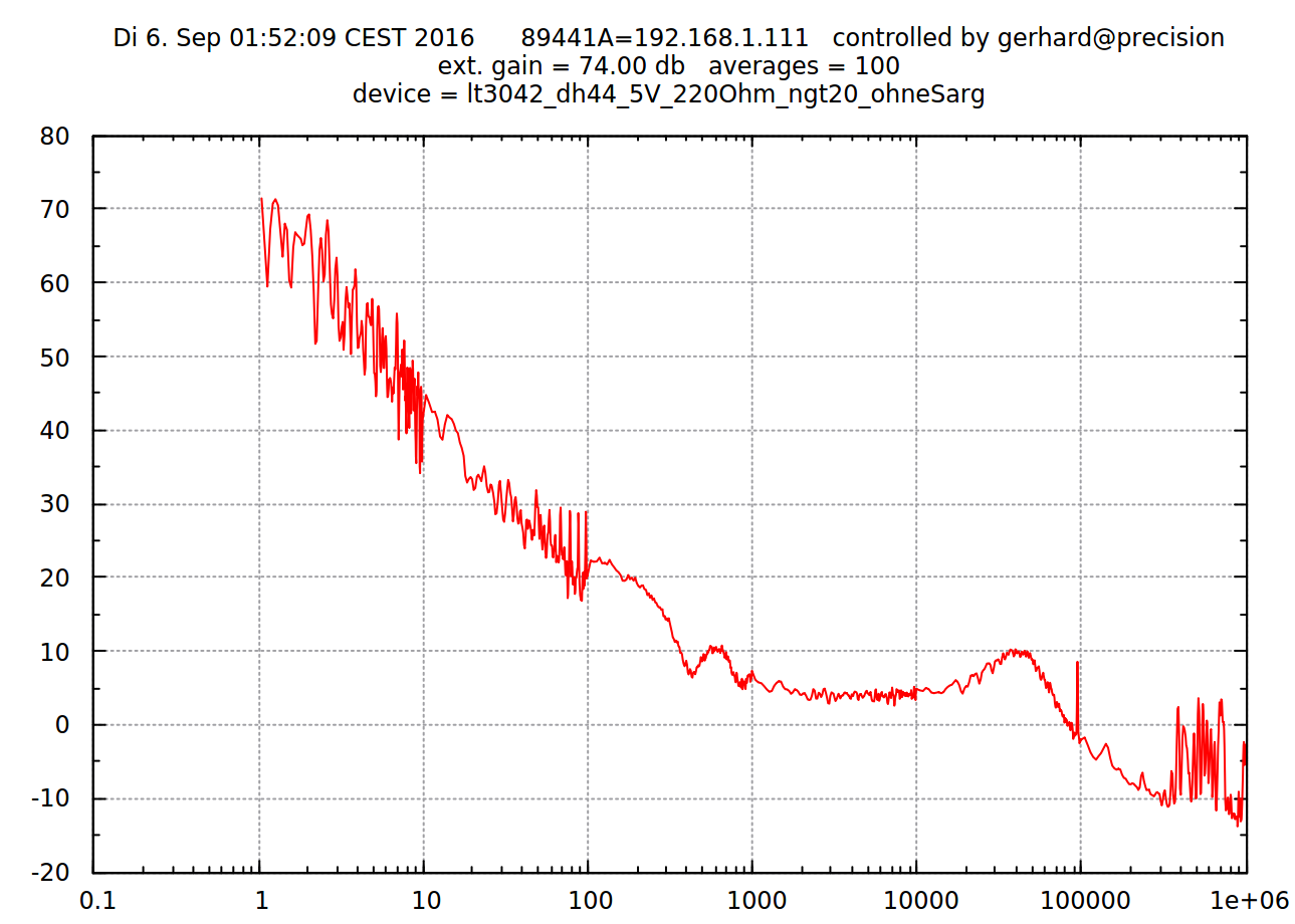

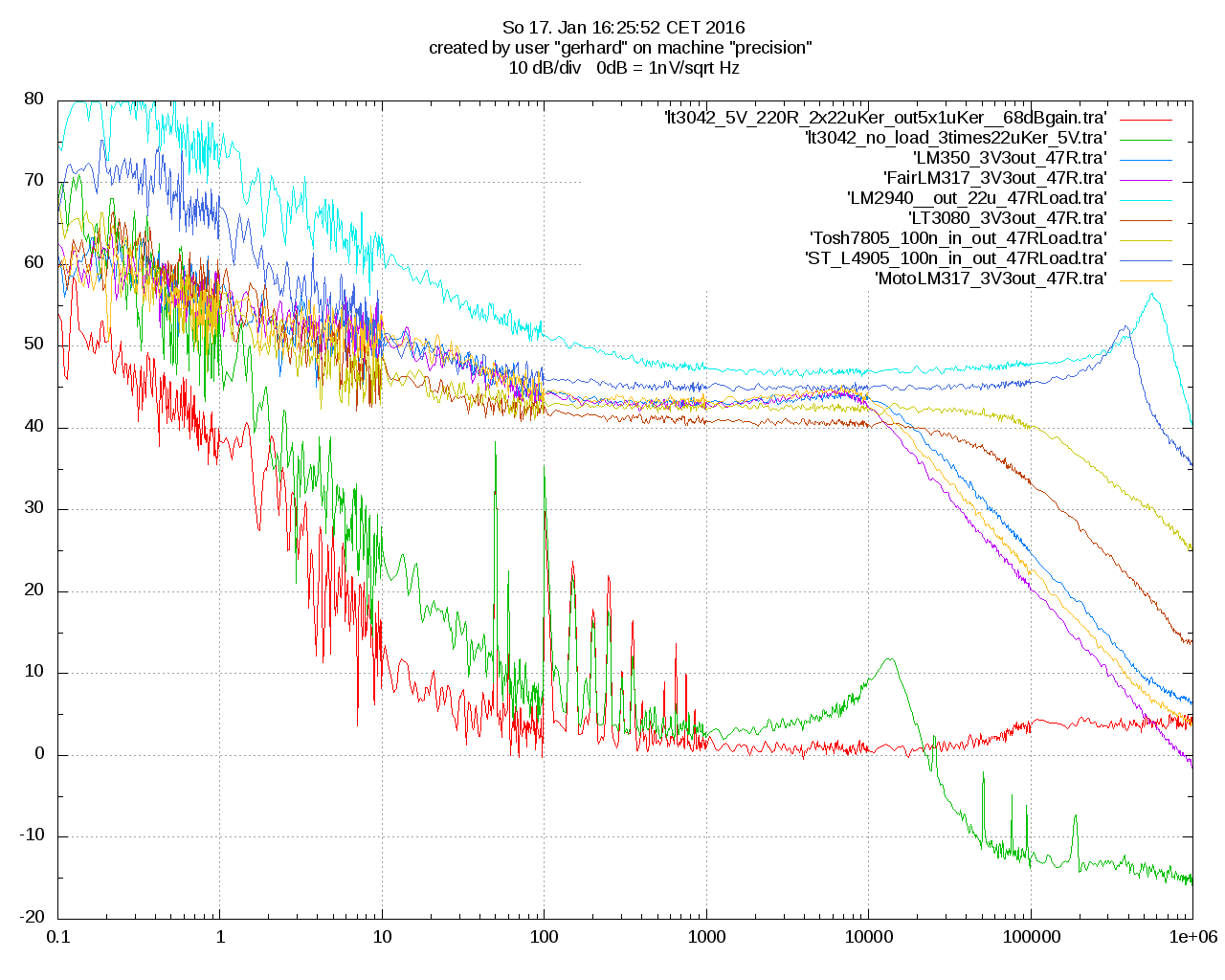

I definitely doubt the LT3042 measurements, starting with the missing absolute scale.
My measurements look this way:
(ed. that does not seem to load in finite time)
Circuit is from the data sheet and results are like the data sheet. (red trace)
The strong rise at low frequencies goes on the undersized input capacitor
of the preamplifier. That has been changed in the meantime.
Increasing the output cap of the 3042 beyond the recomendend value creates
a noise peak. (green line). If you insist in a larger cap, you need some damping R.
The other picture is the LT3042 with an external DH44 BJT for large output current.
Also 1:1 from the data sheet.
< spectrum_lt3042_DH44 | Noise spectrum of the LT3042+ D44VH10… | Flickr >
The other pics to the left/right show the noise of some Zeners, LEDs and other references.
All plots are scaled that 0 dB is 1nV/rtHz, which is abt. the equiv. input noise density of an AD797 or LT1028.

I took the liberty to simulate your regulator. First two use the green LED you tried, though only one in my case to get the output you need. Your LED must be different.
Then I replaced the LED with a 680 ohm resistor, also to get to the voltage you need.
In this case the comparison was between PSRR, and the curves speak by themselves. Elvee seems to be right about the LED worsening the results, and impedance or noise should be worst than using a simple resistor. Why don't you try that option, instead of the LED?
Also have a look at the improvement you should have by just adding a 1 ohm resistor before your input filter cap, as suggested by Diego. On both versions.
