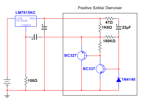

For LM7805 application (low voltage than LM7815), the 390 ohms resistor should be around 1K5 ohms (according simulations).

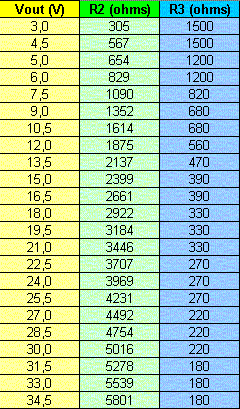

Hi Elvee, Diego - thanks for all the great info in this thread. Since my maths is more than rusty (and deteriorating like my eyesight for soldering....), do we have recommended starting points for R3 in the Dienoiser (as mentioned by Elvee in post #415, and Diego in posts 410 and 411) but for the LM317 for say the 5v and 15v outputs? Would they be the same as for the fixed regs LM7815 390 ohms and LM7805 1.5k ohms mentioned by Diego in #411? Thanks Adrian
I gave a deterministic procedure somewhere above, but I am not the one who is going to carry out the math details....
If you can content yourself with an approximation, you can use this simplified relationship:
R3 = 4.3/Vout (with Vout in volts and R3 in kΩ -this will make some people cringe-)
It assumes a 1:3 current partitioning ratio, which is certainly not exact but probably sufficient unless you chase the last dB

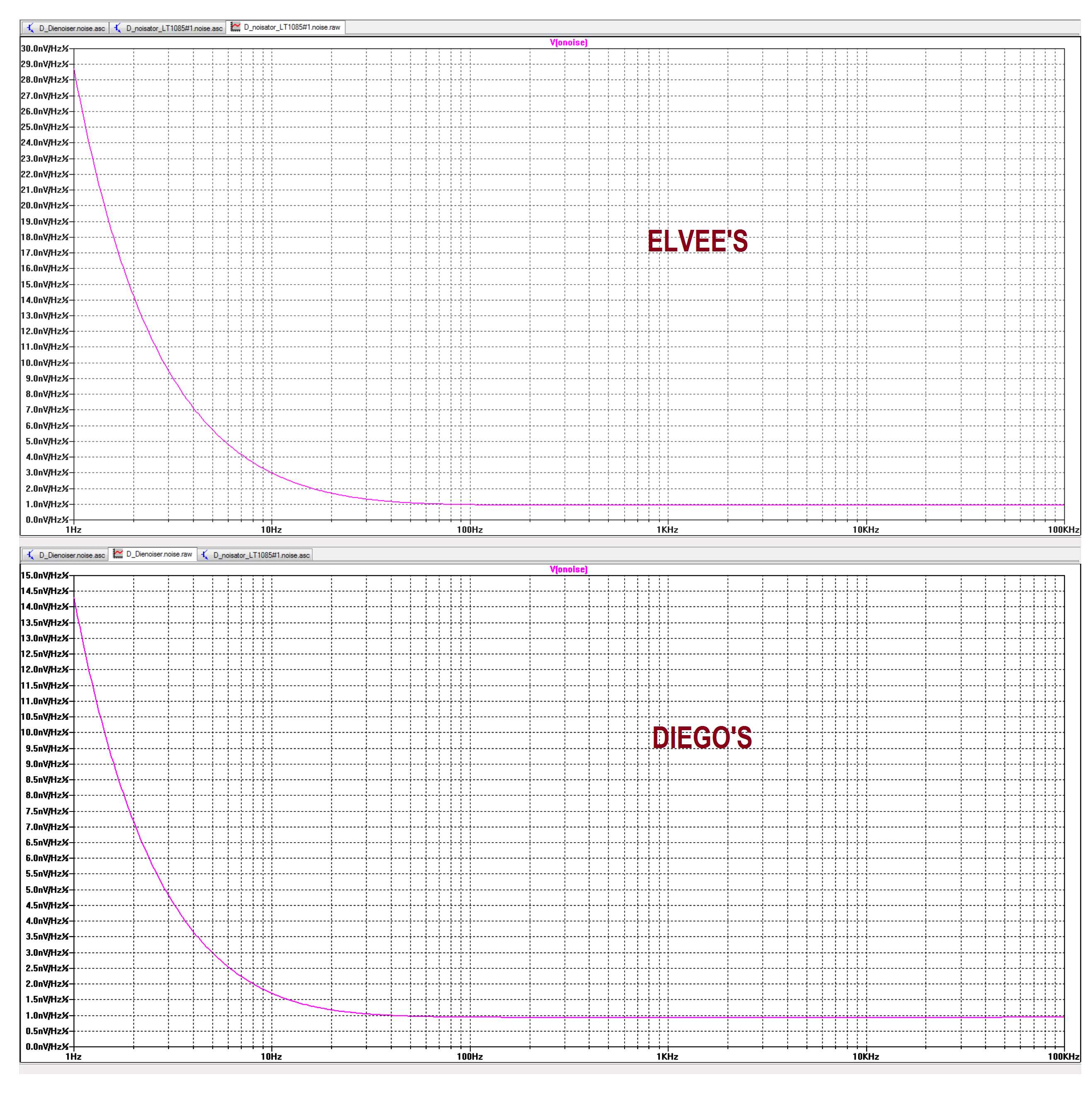

As a reference, to try to settle the dispute, here is a summary of the measured characteristics of the nonoiser (the Dienoiser should be very close):
Output impedance @1kHz: 15µΩ
PSRR @100Hz: 125dB raw (tweakable to 130dB)
Noise density @1kHz: 0.8nV/√Hz (With a ZTX851)
Total noise from 10Hz to 10kHz: 90nV
Ah, thanks.
The noise density could be possible.
I can't do anything at the moment because my FFT analyzer
drops from the LAN every few seconds. It used to happen
now and then, but with the newest Linux kernel updates it
is essentially unusable. Trying to go the GPIB route was
harder than expected, not yet finished.

Why have you shifted the 47R resistor in series with the output,rather than its protection role for the npn BJT?
Is it not needed anymore for fixed regs.? Less noise?
Removing the 47 ohm resistor was only a suggestion to vacuphile in order to carry out a quick and dirty test.
The use of this resistor is convenient (even better at lower values), for when the regulator output is accidentally short-circuited, avoiding damaging the base-to-emitter junction of the NPN transistor.
This same resistor reduces performance a bit.
Best regards

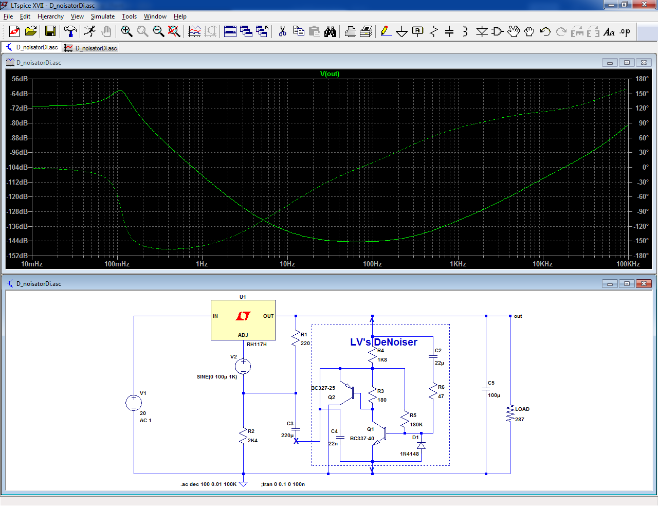

  • The Dienoiser has one more transistor, and improves the performances by another ~20dB.
    It is also retrofittable, at least in principle, but if the original layout has not been thought with ultra-high performance in mind, it will not be possible to achieve the full benefits.
    In practice, for retrofitting purposes, the denoiser remains the best option.
    The Dienoiser is not completely universal: resistor R3 needs to be adapted to the output voltage.
    Here is a table giving the resistor's value for various voltages:
    D-Noizator: a magic active noise canceller to retrofit & upgrade any 317-based V.Reg.
    Like the denoiser, the Dienoiser also doubles the quiescent current.

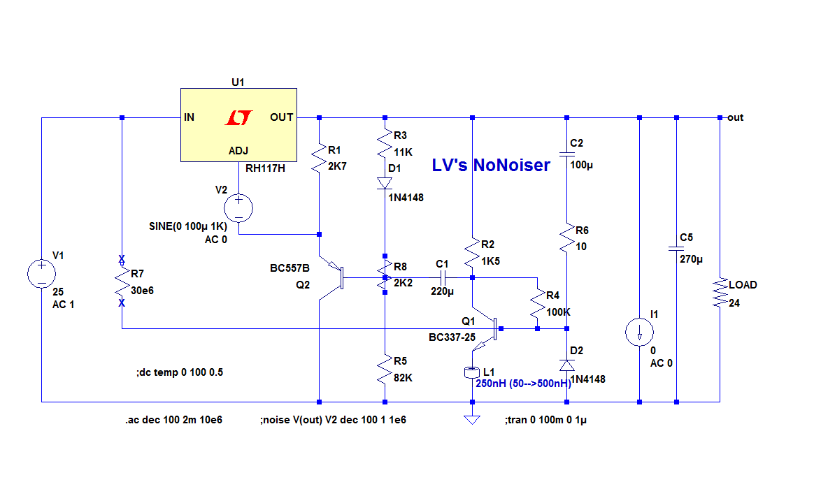

  • The nonoiser is slightly more complex, and has performances similar to the Dienoiser, but it also offers some advantages.
    743622d1552823795-noizator-magic-active-noise-canceller-retrofit-upgrade-317-based-reg-nonoiser0-png
    It allows more convenient capacitor values, meaning the 220µF can be reduced if desired, or kept identical to improve the VLF response: wider and no peaking.
    Another advantage is that the quiescent current is not increased compared to a simple regulator.
    The voltage formula is not exactly that of a 317; it can be found here:

^ R1 in the above Elvee DeNoiser post 537 , sets the current of the LM regulator, R2 sets the output voltage. ( of course by changing the current through R1 , you change the output voltage too). R1 can be between 100 and 1k2 , setting the current from 12,5mA to about 1 mA. The real quiescent current of the LM itself is the 50-60 uA out of the adj pin.
R4 has nothing to do with R1/R2 .
If you read all the 500+ posts , you would know that this was my (very small) contribution to this thread : lowering the quiescent current of the DeNoiser for battery or mixed applications.
Elvee uses 220 and 1k8 which takes about 11-12 mA for a 15 V output , I use 360 and 3k6, and 390k for R5 , so around 6 mA depending on your transistor's Vce.
The LM+DN doesn't have to consume more than the LM alone.
