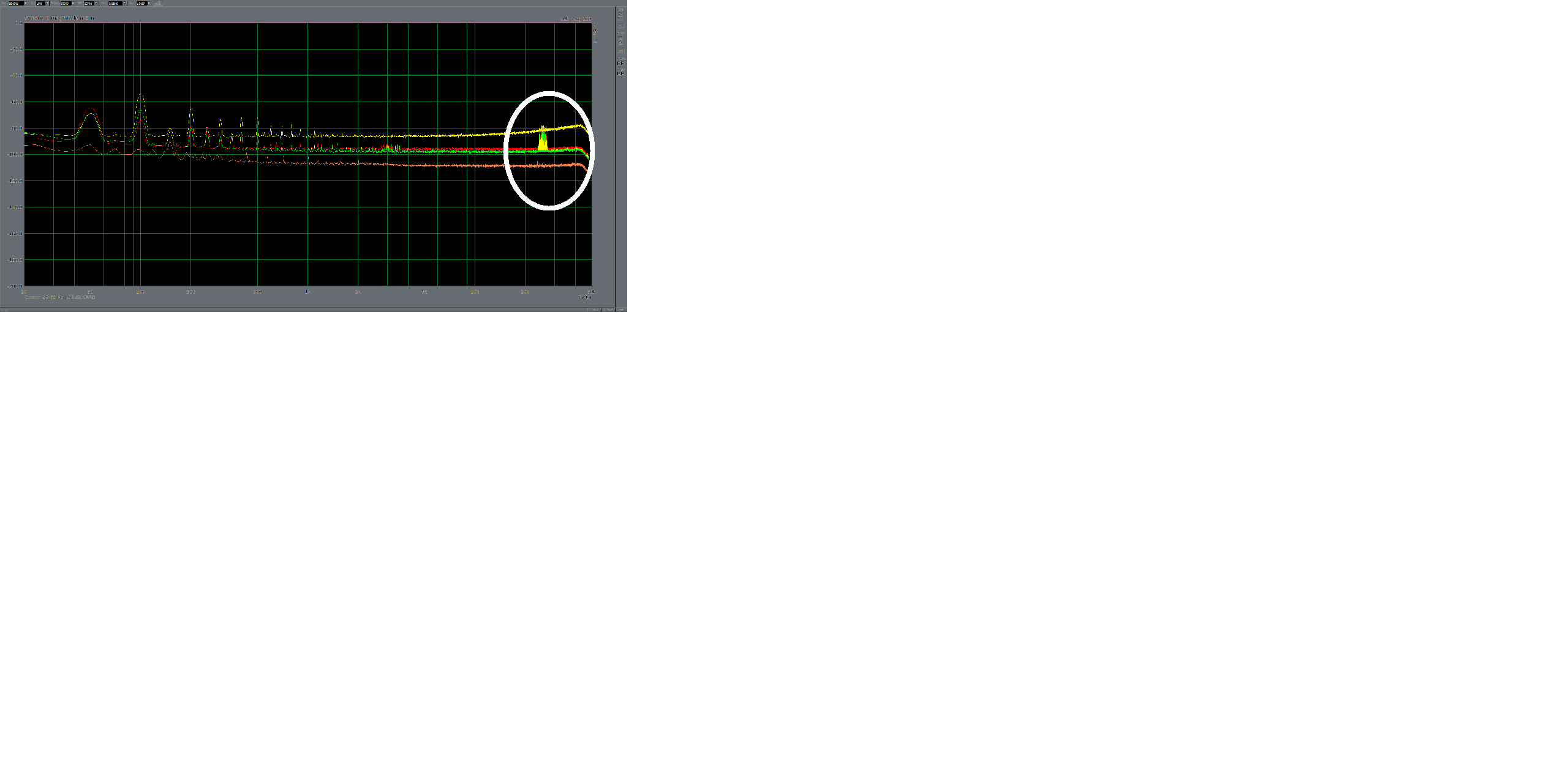

Managed to get LT1085 to work with dienoiser. I used a 2K pot to go from denoiser to best result. Works with 50nF/5R comp network and the trick was to use a low esr output cap. Best results were at 560R and 1.8K (I'd stick with 560R) for the dienoiser resistor value. Between it didn't look that good. Noise performance of LT1085 with dienoiser seems similar to LM317 with dienoiser.
Now I'm curious about LM337, maybe it works with dienoiser. Will report back the results.
Finally, LM337 works with dienoiser as well! The issue seems to have been the higher ESR output cap used for LM317. Apparently LT1085/LM337 doesn't like it.
LM337 works without R just with 40nF Ccomp. Dienoiser resistor value around 390-560R seems ok.
Here's a graph with some measurements. Yellow is LM337 denoiser, green is LM337 dienoiser, red is LT1085 dienoiser and bottom trace is the LNA input grounded at sense point.
Seems to have the same amplitude regardless of attenuation factor. Regardless of regulator as well. Might be related either to LNA, either to environment. Actually when I ground the LNA it's gone. But still I kinda could tell it's there just that it's attenuated when LNA is grounded. I don't know, but seems to be there on most denoisers I played with. I also use denoiser for LNA rails.
edit: I'll try with the laptop and turn off everything else, see if I still get it. It's strange as it's on denoiser trace as well, which should be stable.
Seems to be LNA related, or environment pickup.
I have the LNA turned on, output connected to ADC, input connected to a diy lm3x7 denoiser power supply that is turned off, laying on the desk. This is what the ADC sees:
If I ground the LNA input cable at sense point it goes away (bottom trace). So I don't think that is related to the DUT.
