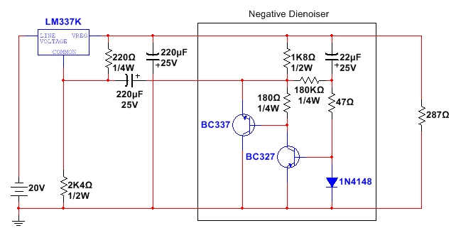

Can this new version of the Dienoiser work free of oscillations?
If you look closely, the 180K resistor connection has changed slightly. The 22 nF compensation capacitor has been removed.
I confess that I have not yet been able to test it.
I could give it a try when I have some time to test. My diy testing supply is set up for positive regulators at the moment but I presume it should work with LM317 as well?
However, on Multisim 14 it would appear to be working.
Possibly, a real test has the last word.
I estimate it could be implemented with the LM317 as well.
Best regards
Best regards
In LTSpice your last version seems to be having similar performance to the adj cap version. So that should be pretty simple to tell in testing if it works or not.
So apparently just removing the 10nF comp cap seems to make the dienoiser to behave like the adj+cap version. So your proposed mod might work. Hope I find some time to test it.
You have shorted the 10n comp cap so no wonder it behaves like adj+cap. Instead of shorting you should remove it.
