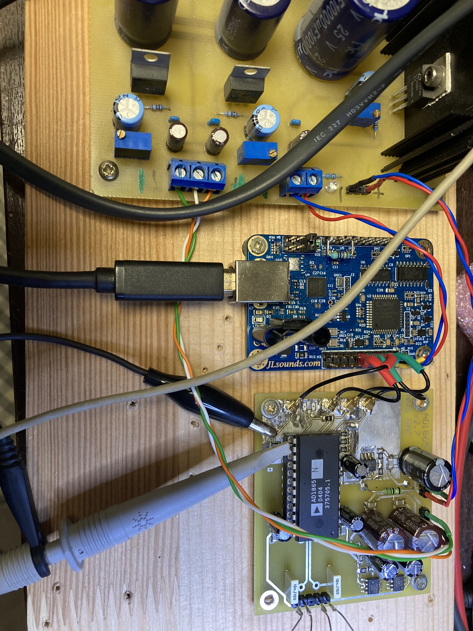

I am using 1.3 version. If I were you, I would use one 12V for AD1862 and a separate 12V for the opamps. I am not using PSU2, but I am also using liner regulators (LT3045). I have observed that the dac's analog part and the opamps are fighting for current. This is obvious once I remove all the 100uf caps. Why removing the 100uf caps? Because they color the sound, no matter what caps you use. I have heard for myself how it sounds without caps.
Another thing which can color the sound is the power supply itself (how it behaves under capacitor load), that can be another reason why the sound is different without caps or with different capacitors. That is why I like 78/79xx regulators, they are stable with any capacitor load 😎
Now, all this is beautiful, except the averaging voltage measured at my AD1862 is now only 11.02V, as compared to 12.02V when the caps are in place, meanwhile, the voltage at the opamp is jumping between 12.02V and 12.08V when using LM6171s. Apparently, the AD1862 is starved while the opamps are over supplied.
Did it happen on both DACs (mine and diyinhk)?
What if the power supply is not good enough? 😕

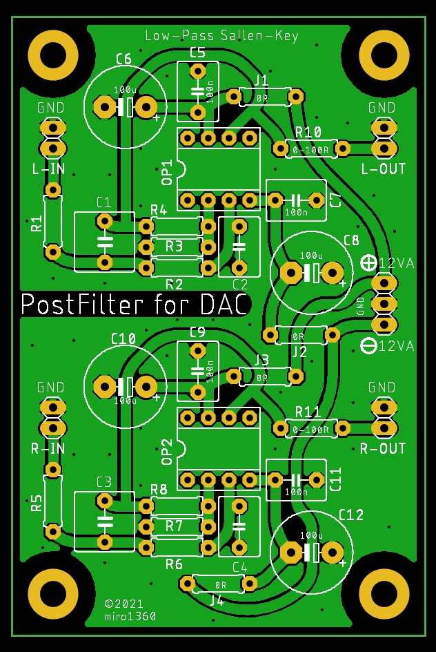

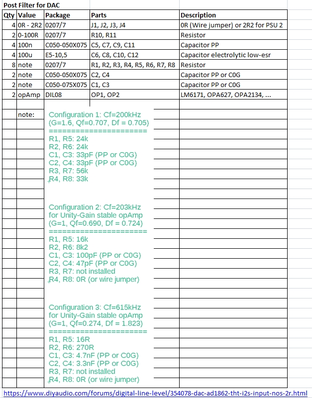

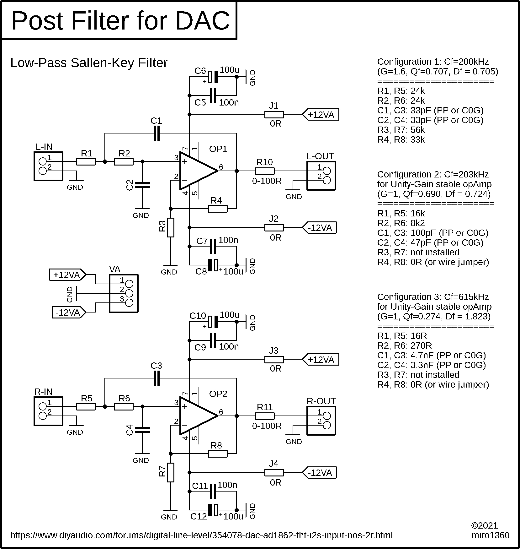

Post Filter for DAC - Low-Pass Sallen-Key
Low-Pass active post filter after the DAC (after I/V) is used to smoothen the sharp samples at the DAC output due to the digital code converted to analog levels. In other words it reconstructs and band limits the DAC output signal 😎
It may be helpfull to remove a high frequency generated from digital side.
As always, the sound will be certainly colored according to the components used (opAmp and capacitors)
