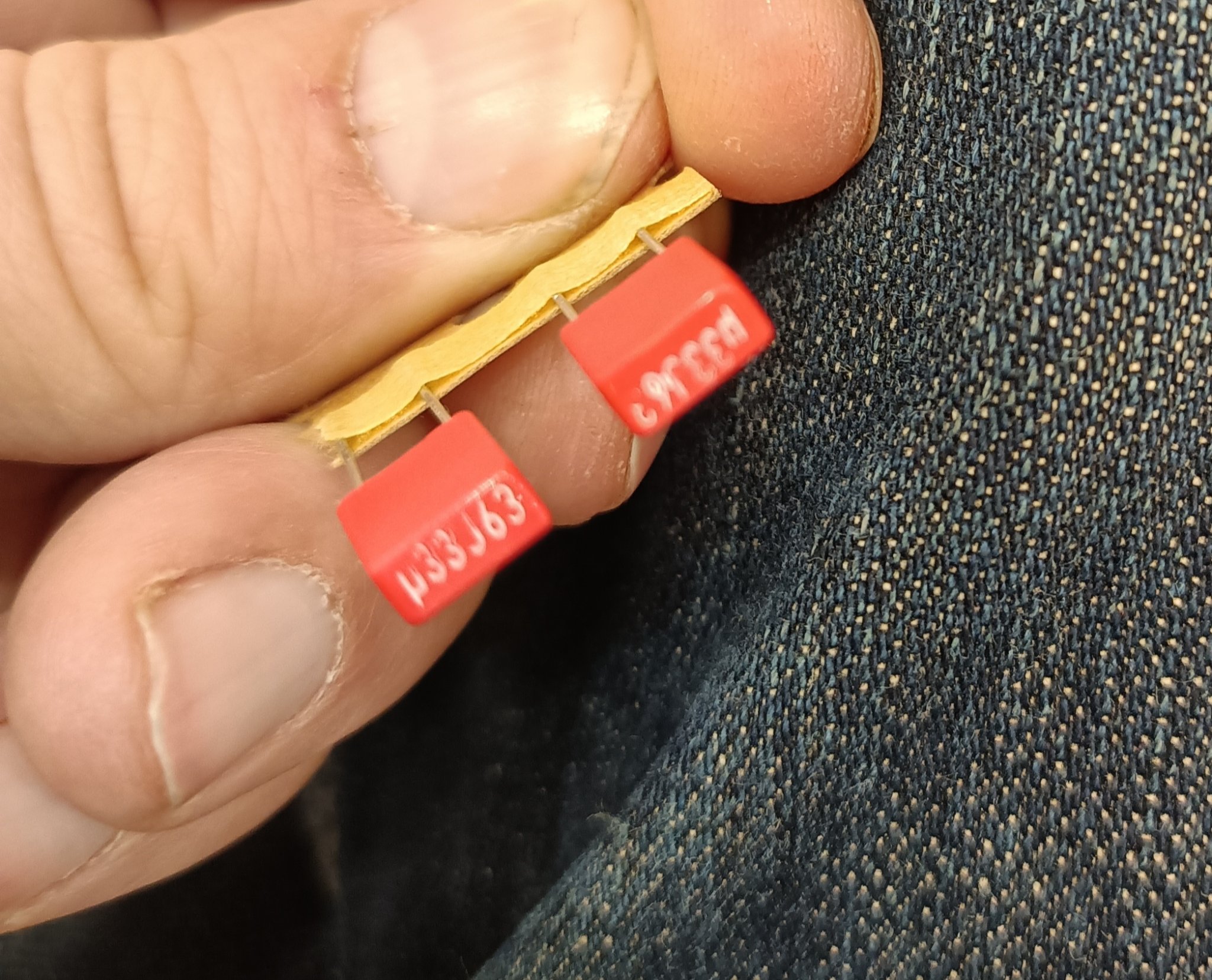

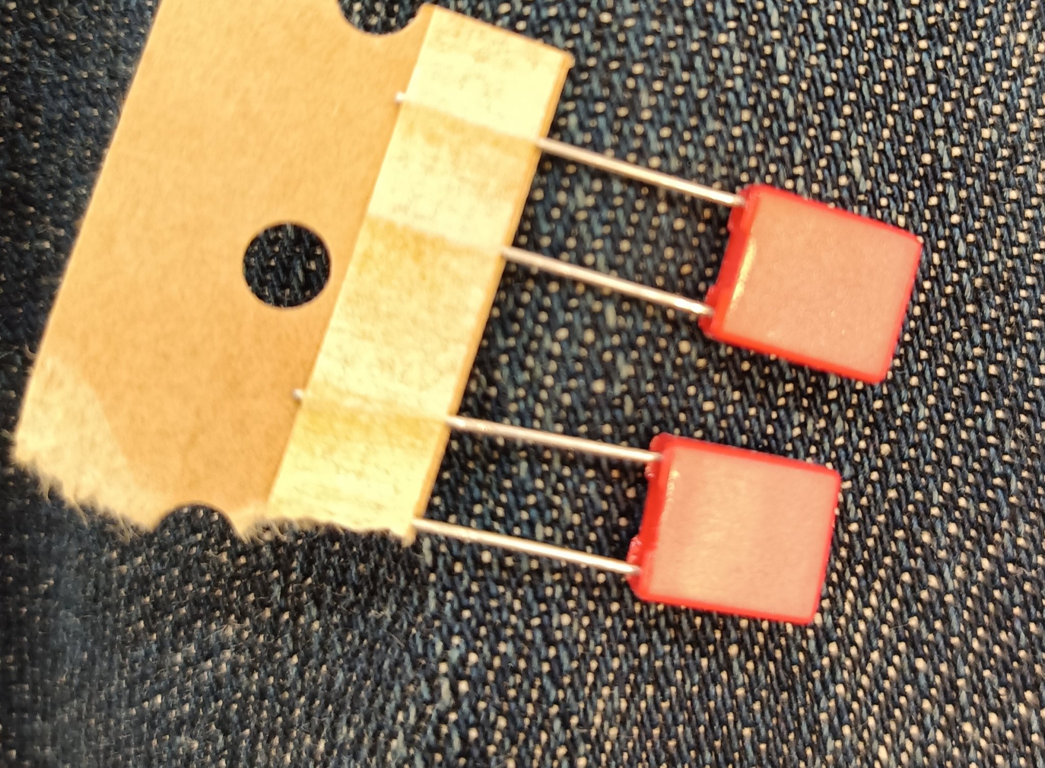

Guys, what do you think? - is it original or china ver? I buy today in the shop.

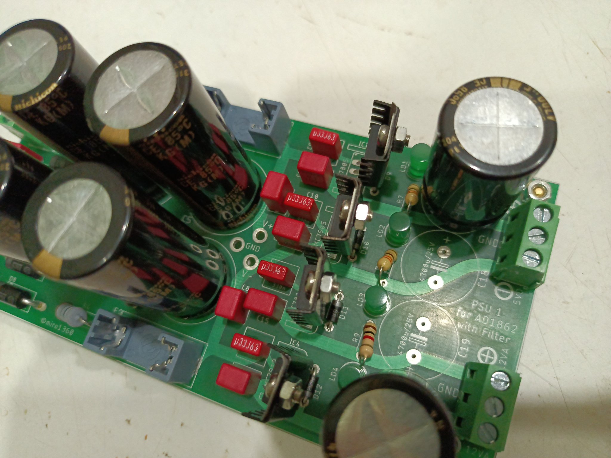

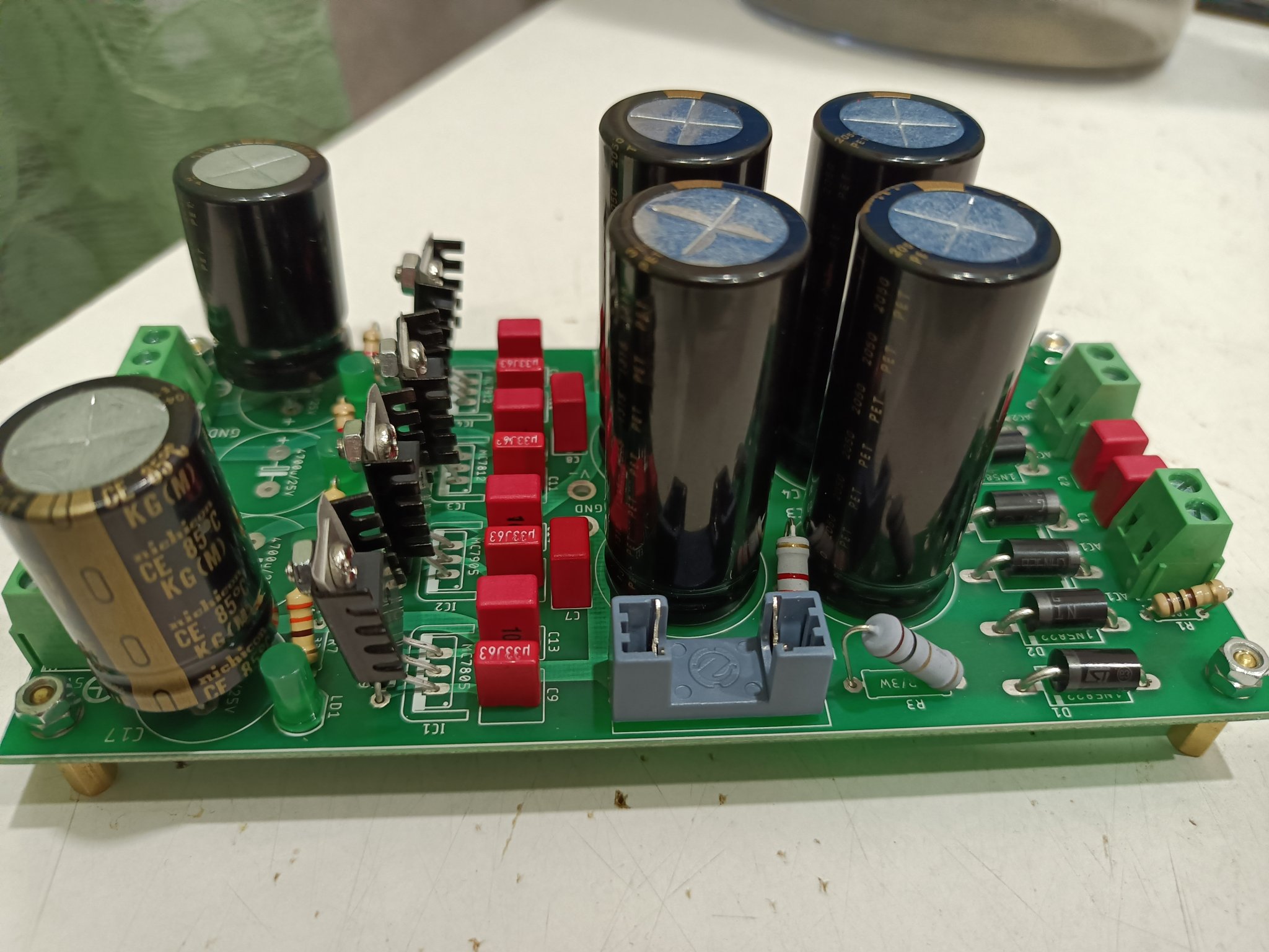

I'm almost finish the PSU-1. The problem is KG 4700uF. They are too big for place on board. I solder only two of them and the others don't fit😢
I want to solder Epcos B41851A5478M000 (4700/25) - they are smaller. Can I?
Unfortunately I could't found resistors from BOM but I have the alternative. That's why it wasn't so neat.
What I have left to do? - measure the voltage of PSU (+5 and +12) without DAC and then connect to DAC board and Amanero, right?
Oh, yes - one more thing - I was planning to build PSU 2 originally and solder J1-J13 2r2 resistors (2,2ohm). Can I use them or I need to change to jumpers? I could't found any LT's but everything was for PSU-1 so I buyed🙂
What else to look out for?
Sorry for such many questions but it's my first diy Dac))
Is fitting the remaining 2 capacitors under the board an option? It will create the need for a taller chassis though.
Yup , power up the PSU to measure the voltages before connecting to any other boards.
I would let the 2.2ohm remain if they have been soldered already. They are not needed if using PSU1 but they do not take away anything significant from the power supply if you leave them on the board. i have them on the board.

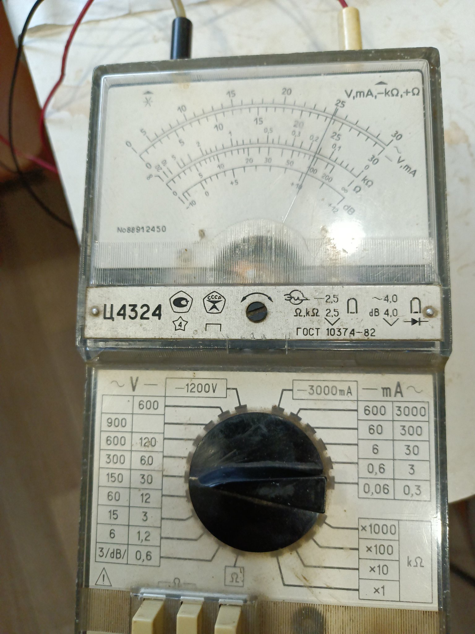

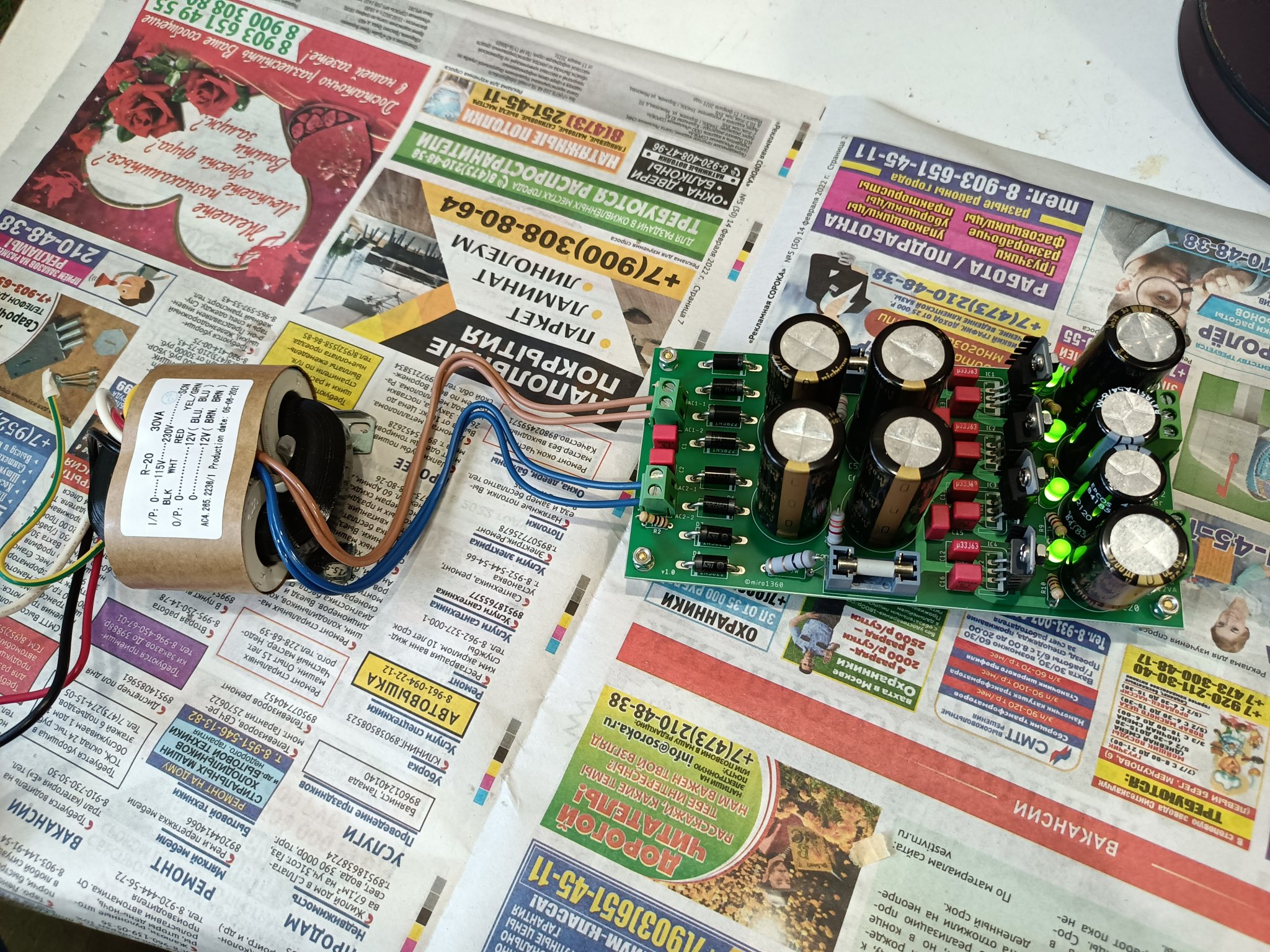

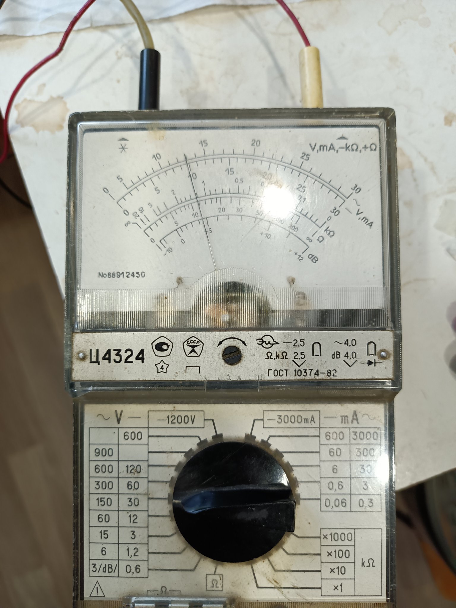

Guys, I just start the PSU. It's ok but the measures are little high. I'm attach a photos my voltmeter. Is it supposed to be like that?
Please look at photos. I can connect everything recently!
