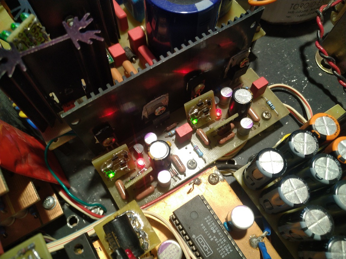

Yes I tried shunts at the DAC PS and they are very good. BUT as close to the DAC chip and for each power pin. In that case grounds are close to each other and dissipation from power "loss" is not huge, no overheat because it spread to more little shunts. Main power could be central Vd and Va.
in that case 4 shunt regs modules needed for each dac chip and it should be integral part of DAC pcb close to the power pins and ground planes.
It make an overall sound improvement when aplied in all digital modules like separate shunt gor the re-cklocking, digiral isolation and so. Same way close to the modules.
For shunt is some advice to have 120% of current that source is consume. So for the 100mA we need another 120mA that is 220mA for unloaded shunt. That should be NOT overheated without load! For stabler operation and proper testing witout load bare in mind bigger hat-sinks for larger current loads 🙂
Anyway my experience is very good.
I have to agree with Zoran with the use of shunt regulators in DAC, they are much better options than serial regulators. I started installing the first shunt regulators in my DACs about 10 years ago and was surprised by the improvement. Now I am using an improved version of the shunt regulator from Mr. Walt Jung, the picture shows a +/- 5V shunt for my PCM1702 (6 pcs.), The current is 250mA for - and 100mA for +.
This improved version was done together with Mr. Walt and I hope that the circuit will be available to everyone soon. Unfortunately, these regulators are not simple and have a slightly higher dissipation than the serial ones, but they are worth the effort.

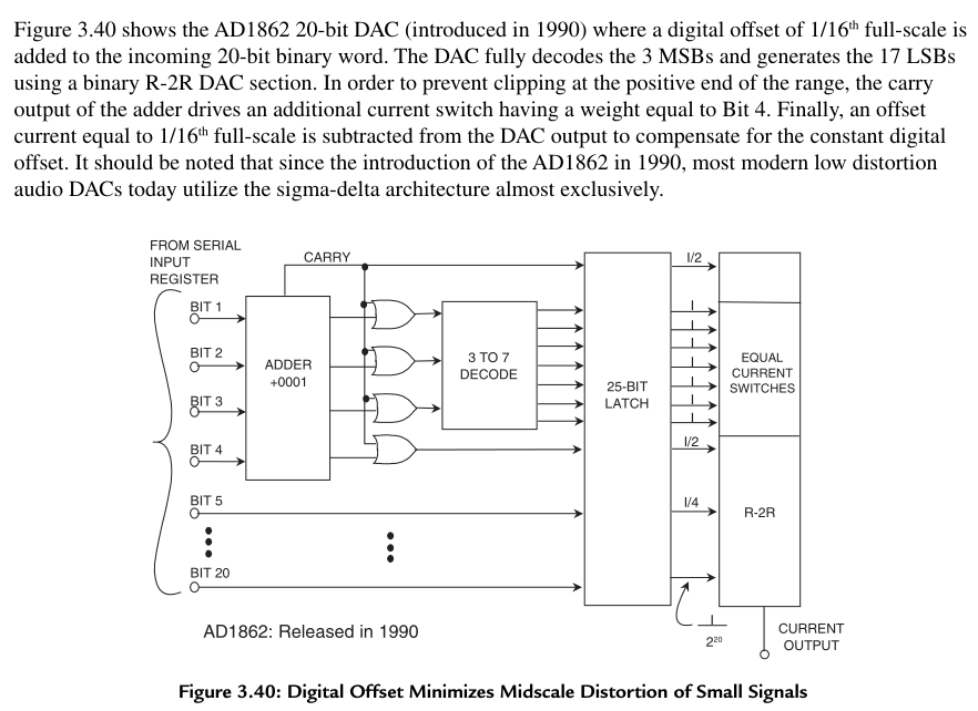

Thank you for this internal structure, very interesting 🤩
Actually that is explanation that AD1862 is NOT pure R2R dac.
But segmented DAC or hybrid DAC.
Because first 3 bits are transformed as 7 bits of Thermometer code. And going to conversion same as DSD.
Other low significant bits are classic R2R dac...
So most of the sound comes grom generated first 7 bits 🙁
As other AD and PCM dacs...
