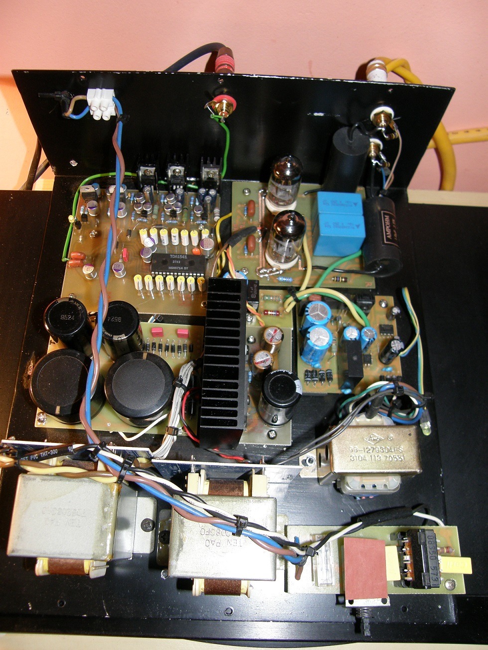

First of all, I would like to praise this excellent project.
One small recommendation, avoid LM78/79 regulators or in general series regulators for TDA1541, rather put LM317 as CCS and TL431 for shunt, resistor values are easy to calculate. Instead of LM317, a better solution is two depletion mosfets in cascade.
My friend is currently working on a similar NOS DAC with TDA1541, using Salas shunts and OS-CON, and my first DAC with TDA1541 (picture below) also had shunt regulators with LM317 and TL431 and OS-CON.

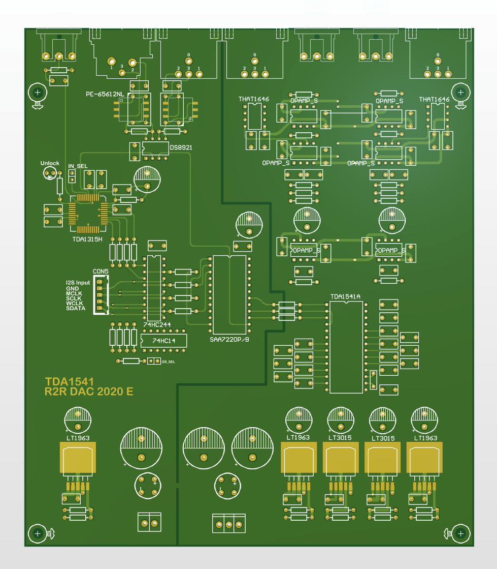

Oh damn, see that huge ground loop in the i2s signal return path.... not a sota design. But nothing bad if free (generous offer in the thread spirit), the regs are good, while I prefer discrete regs here also.I've got a Altium source file, a TDA1541A DAC PCB with many interfaces, including I2S.
Anyone interested? Maybe I can put it here or share the GERBER file.

Free. BTW, are you able to modify the file or correct the ground loop you said?Oh damn, see that huge ground loop in the i2s signal return path.... not a sota design. But nothing bad if free (generous offer in the thread spirit), the regs are good, while I prefer discrete regs here also.
Also posible with fifopi?
Without the files, not possible. If the top is the gnd you can scratch the varnish just before and after the i2s resistors that cross the split and solder a zero ohm resistor across or a piece of wire. But I should wait what Miro is doing or spend a little of monney at Audial Audio that has sota design with sometimes cheap stock for diyers (bare pcb). I see many defaults in this pcb picture...a classic when not knowing well this chip. tda1541a is wonderfull but a b...h about the pcb layout.Free. BTW, are you able to modify the file or correct the ground loop you said?
