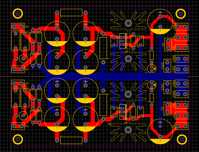

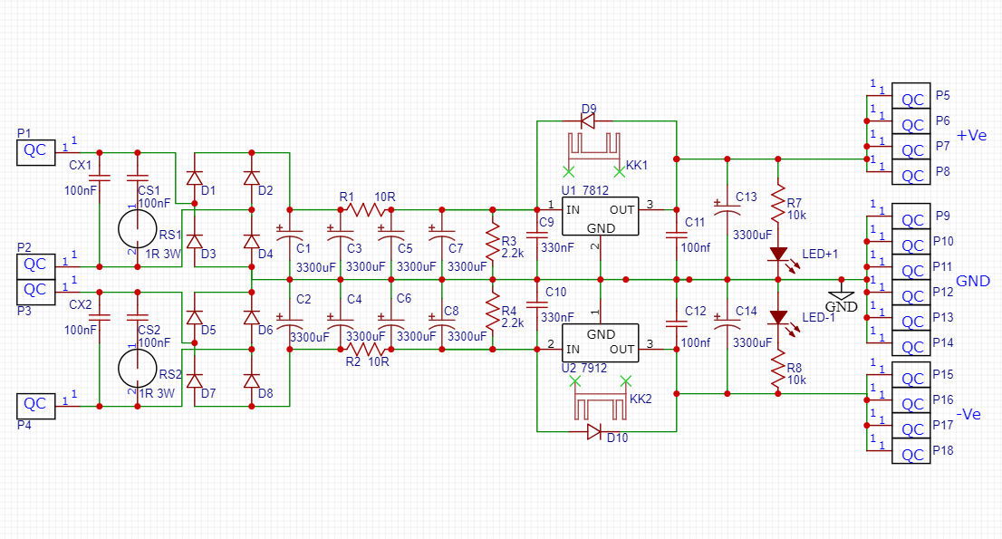

Hi Guys,
I've been working on a variant of Miro's PSU 1 with a few changes.
I have separate transformers for my 12v and 5v so I don't need both on 1 PSU.
I have opted for a central ground bus down the centre of the PCB rather than using a pour as would probably be my normal custom. Mainly to make sure the current paths from the bulk caps go where I want them.
Does anybody see any glaring issues or things I may have missed?
- extra snubber cap across the transformers secondaries.
- larger heatsinks as I have a bunch of these lying around.
- 18mm diameter caps at the input and output as I have a bunch of these on hand.
