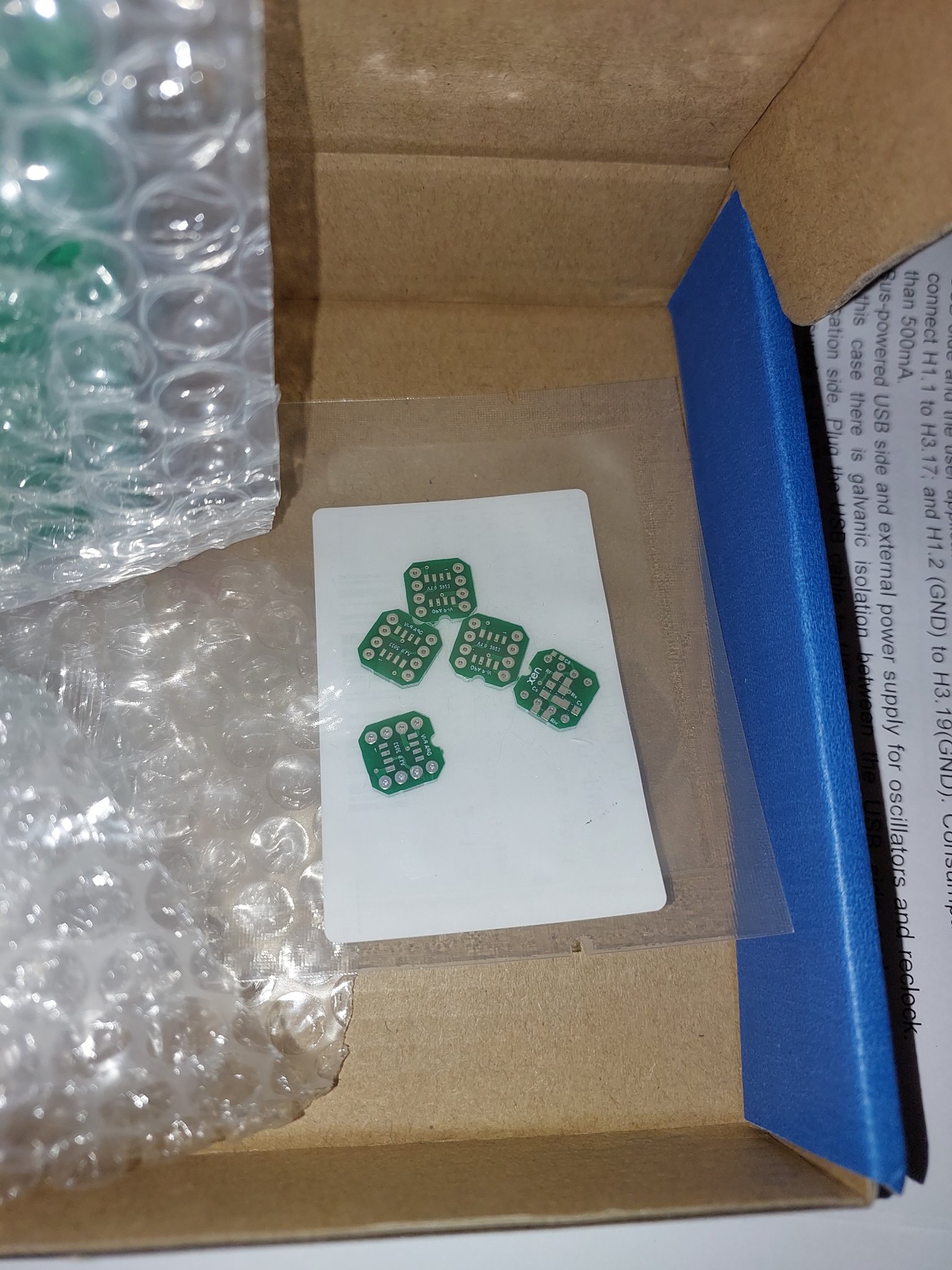

@namghiwook Due to your encouraging posts... Another blue box arrived today...
Sorry I couldn't resist - how do you like the sound of this passive IV versus the active IV ?
