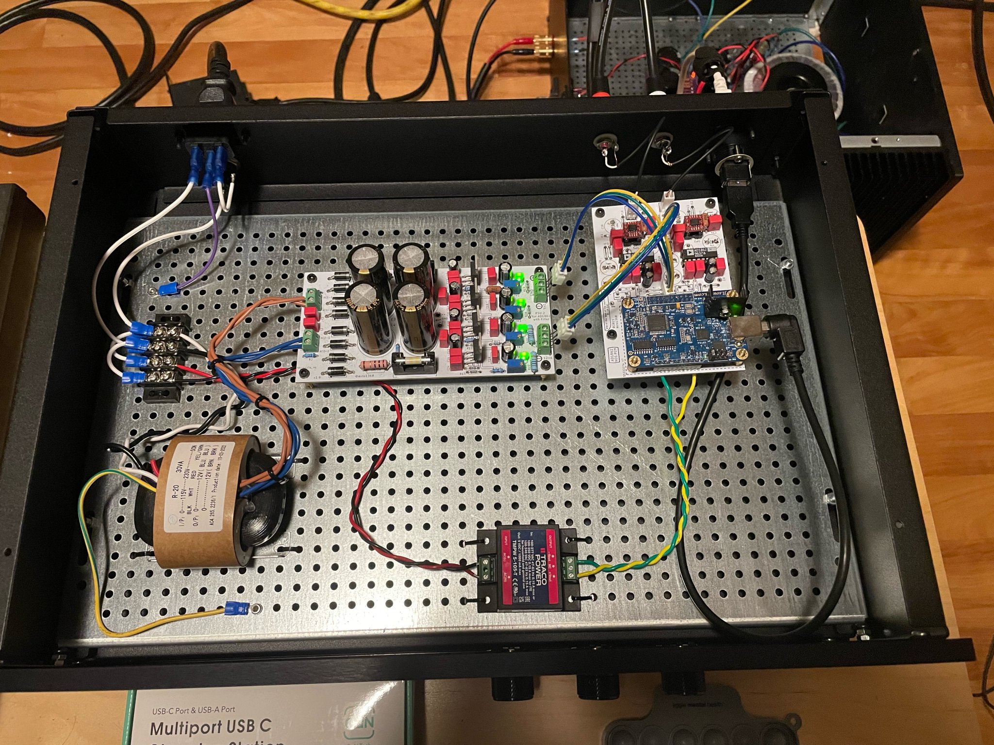

I’ve been experimenting with making a more “finished” 1862 after my 1541 dac was no where near fitting inside of this case. -_-
While doing so I decided to roll some opamps as I haven’t tried some newer purchases with the 1862.
The 1655 is stunning to me, and for the price it’s unreal. I highly recommend it for anyone who has yet to try this combo.
To note, when I tried the 1655 with a 1541 I was unimpressed, but it seems to be a great fit for the 1862.

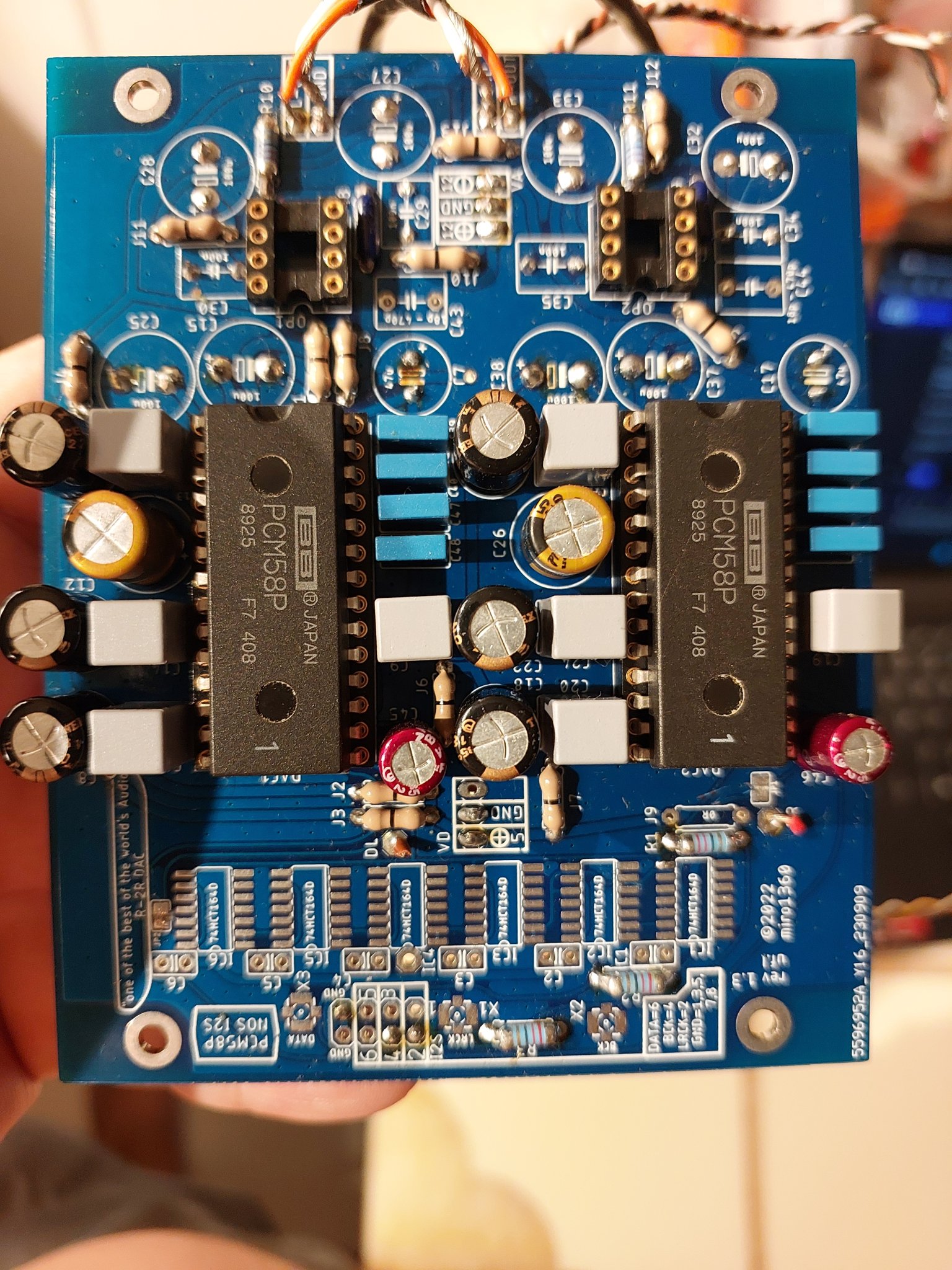

I'm just starting to solder the PCM58 DAC board
My plan is this: signal from I2S over USB FIO, initially powered from USB just to check if everything works.
The next step is to power the I2Sover USB from two independent power supplies (I have two Chinese ones, LT3042 and a 2x8V transformer) I know - I need to cut the jumper
Signals from I2S over USB:
BCK
LRCK
DL
DR
DATA not connected
What about the GND connection between I2S over USB and the DAC board?
DAC board
I will not solder the sift register
Do I have to cut the JP1 and JP2 jumpers?
Output stage To start with, for testing: in-board op-amp
Next step: external I/V stage I have very nice boards for tube stage ( SRPP 6N2P ) and discrete ( transistors) stage based on Eric Juaneda ( both gift form my friend from Poland)
Question:
Where is the best place to get the signal for external I/V? From the OP-AMP socket?
Do I need to desolder the conversion resistor (R8, R9) for external I/V or is it enough to remove the OP-AMP from the socket?
Are the values of decoupling capacitors for PCM58 - 47nF are critical or can I use, for example, 100nF?
What else should you pay attention to?
I apologize in advance for the beginner's questions, but I have no experience with digital technology yet

"What about the GND connection between I2S over USB and the DAC board?"
Yes. You are going to have all sorts of problems if you do not connect the ground of i2soverusb to the ground of the dac board.
"Do I have to cut the JP1 and JP2 jumpers?"
Yes. You should cut the traces.
"Where is the best place to get the signal for external I/V? From the OP-AMP socket?"
I would solder to the op amp socket pin.
"Do I need to desolder the conversion resistor (R8, R9) for external I/V or is it enough to remove the OP-AMP from the socket?"
With no op amp or any other devices that takes after the pinout format of single op amp, R8 and R9 should be 'floating'. Yet, i would want to remove them in case of absent-mindedly installing something in the future that may put them into the signal path and wondering why the dac does not work properly.
