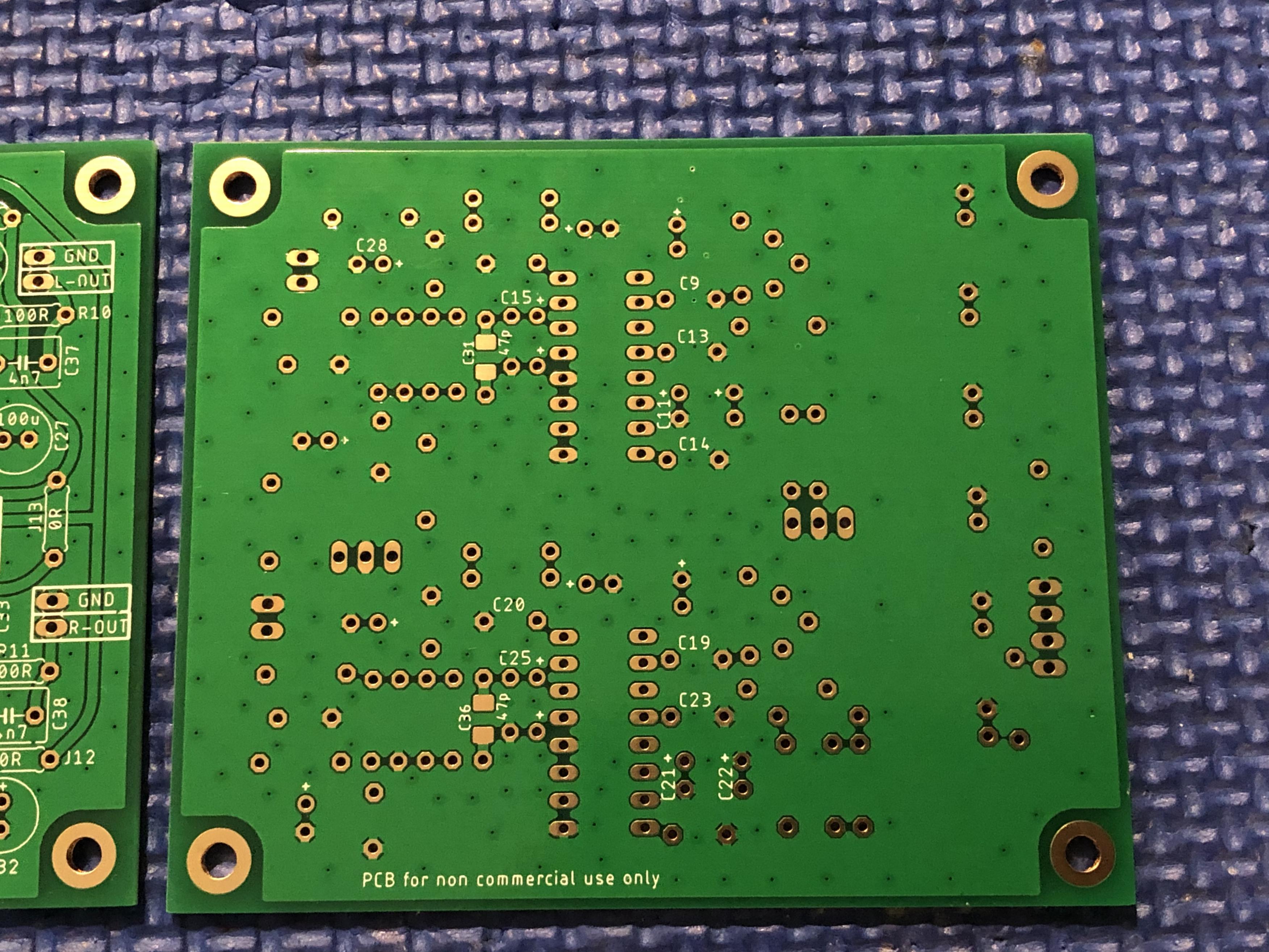

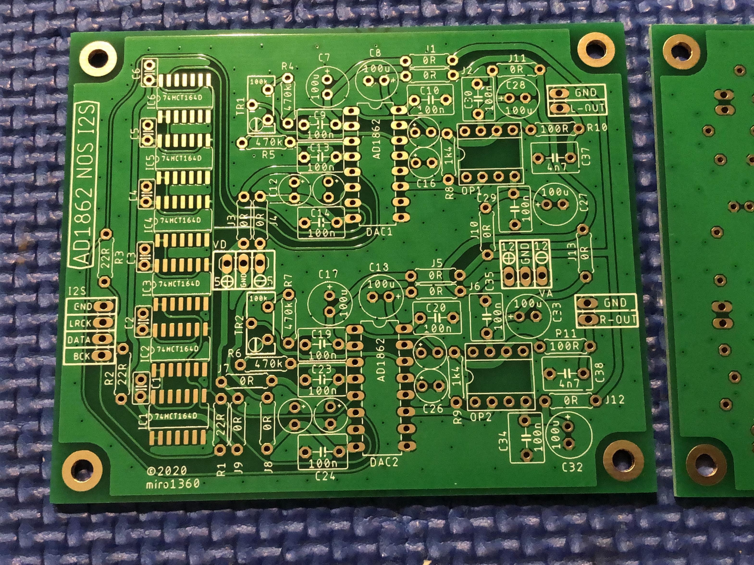

My boards arrived today, Yahoo!! I’ve got all the parts ready to build except........ the AD1862’s 🙄
I’d like to give Bisesik’s transformers a try also 😀
hold on, 5v for digital supply?
I thought it was a typo when miro wrote +/-5V for AD1862 digital supply (ad1865 does use 5V).
The datasheet recommends +/-12V for the digital supply, and the diyinhk PCB is marked as +/-12V.
@Vunce, very nice 🙂 gold plated 🙂
@laserscrape use +/-5V for digital, it is not a typo, really use +-5V for digital and +-12V for analog
Is there technical reason for this or from listening you concluded that?
edit: quick search showed this has been asked before, so the digital circuits operate faster at lower voltage, interesting.
I guess then they suggest 12v for convienence/cost saving (sharing the analogue supply) rather than performance
it is advice from one very experienced engineer, named @dohnalik
I personally don't know the exact details behind it, but that shift can theoretically help to better separate the digital part ... critical part of an R-2R is reference, in AD1862 is powered from analog supply, so there is no reason to +-12V for digital
Vunce, I found a small error 😀 electrolyte in negative supply for I/V is rotated wrong, in the schematic and on the PCB: C27, C32 ... please rotate it correctly, it is very important 😀
