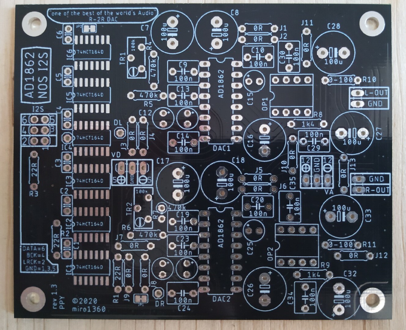

Why not use the solution with I2SoverUSB and the small "Coaxial and Toslink optical output board" for it? You don't need the shift registers.

But if someone needs CD sources: Why bother with an AD1862 and then seriously deal with SPDIF boards?
There are also CD drives with I2S input: For example "Superlink": CEC TL 2N
You can also make it fit with other drives. You have to like the SPDIF boards shown to fit into this AD1862 project
About the DIYinHK AD1862 board...
It uses stopped clock scheme for handling data input,
stopped clock has technical advantages but one clear disadvantage I see with it is that the LRCLK is not driving the DACs directly, like it is in miro's design.
I have a DIYinHK multichannel interface with multiple data outputs at my disposal, I'm wondering if it would be possible to drive the AD1862 data inputs directly with these extra data outputs by configuring them in software to provide the seperate DL and DR signals for the DACs.
My rough understanding is that the data stream is being delayed by a specific number of clock cycles by shift registers, so the corresponding data gets clocked into each DAC channel during the LRCLK cycle.
The problem is that I expected one of channels would be fed directly to DAC and only one would need to be delayed, but it seems shift registers are required for both channels in the schematic...
this is to do with left/right justified data I guess?
This probably won't be possible then without shift registers?
