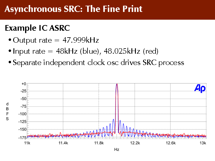

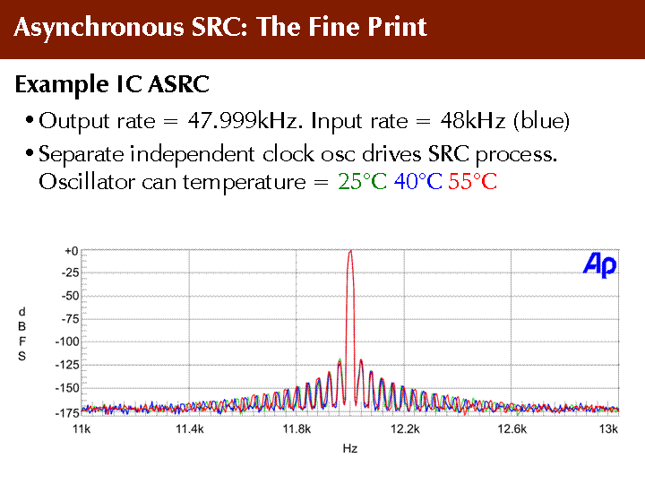

In my search for Dustin Forman's quote I came across this post from Bruno Putzeys which explains the problem with all SRCs Hypex Ncore
"@Arthur I think it would take us off topic to discuss in detail. ESS's claims regarding the SRC pertain to the actual interpolation process. They have done an absolutely splendid job there. The thing that causes problems is the ratio estimator (the bit that works out exactly what sampling time to interpolate). The bandwidth is too high which lets through time quantization errors. The circuit samples the incoming clock signal using its reference clock. This results in the addition of jitter with a peak-to-peak value of one reference clock period (e.g. 25ns for a 40MHz reference clock). Next the number of ref clock periods in one input clock cycle are counted and this constantly changing number is fed into a low-pass filter which outputs a cleaned-up version of the ratio between the reference and input clocks. This ratio is then used to space the "virtual resampling points" calculated by the interpolator. Of course the low pass filter doesn't output pure DC. The spectrum of the counter output consists of mix products between the two clocks. The filter can only attenuate those. The attenuated spectrum shows up as close-in FM sidebands exactly like jitter. DNR and THD measurements ignore those. The SRC successfully removes high-frequency jitter, thus guaranteeing good SNR, but it adds low-frequency phase modulation of the signal that wasn't even present in the input clock. All SRC's do this but the bandwidth of the low-pass filter determines whether this is an issue or not.
The attached two measurements were made on a standalone test chip for the ESS SRC which was never issued as a product, but the actual SRC did go on to be used in the Sabre DAC."
And this Hypex Ncore
"I also worry about the SRC on the ESS not being defeatable (if it is the same one I tested 4 years ago it's not that great) but it becomes transparent if you lock all clocks together. "
Can't find Dustin's comments about this but it is all over this forum that "synchronous master clocking on ESS" DACs brings benefits - just do a search on the quoted text
