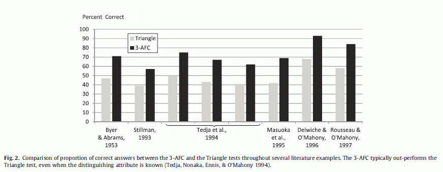

As you´ve said there are drawbacks in other protocols as well, see for example the attached comparion (pooled from various different publications) between 3-AFC and triangle. There is a profound advantage wrt the proportion of correct answers for the 3-AFC.
I´m sure we all can remember all those posts about baseless "excuses from audiophiles", while in reality there is a lot of material available about all possible impacts evoked by the simple choice of test protocols.
Interesting graph, Jackob - thanks for posting - do you have a link to the source, please?
One question - is this graph representing percentage of correct answers for individual trials within tests or overall test results?
It´s from:
Virginie Jesionka, Benoît Rousseau, John M. Ennis. Transitioning from proportion of discriminators to a more meaningful measure of sensory difference. Food Quality and Preference, 32 (2014), 77–82
In this graph mainly calculated for overall test results; for example in case of the "Tedja et al." 1 main test subject and the other two subjects used for confirmation purposes. Participant 1 got correct 50.4 % in Triangle and 75.1% in 3-AFC and had done 720 triangle and 718 AFC trials, while subject 2 and 3 did 240 triangle and 240 3-AFC each.
In the actual articles often more refined even calculated for the presented different triplets.
