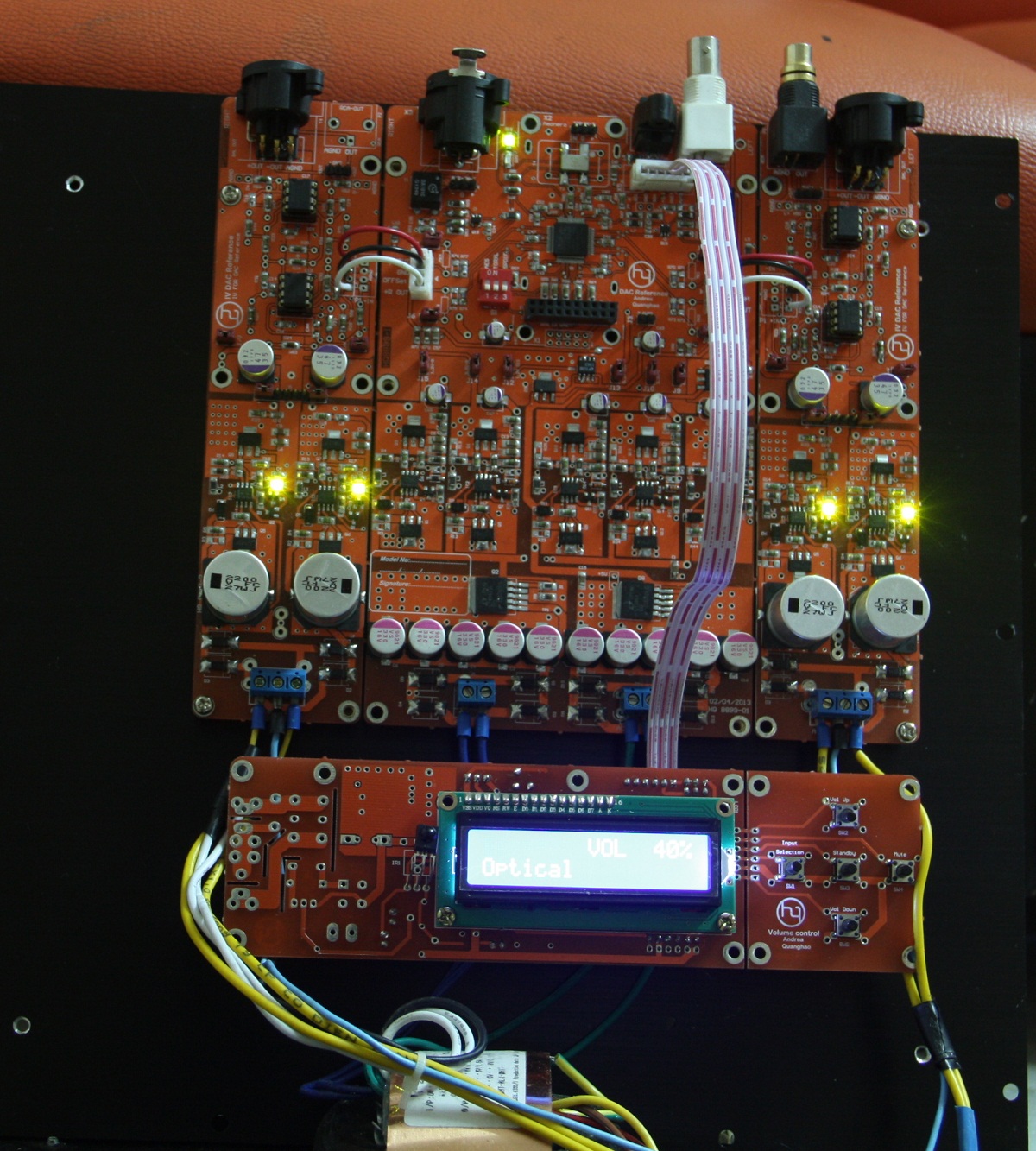

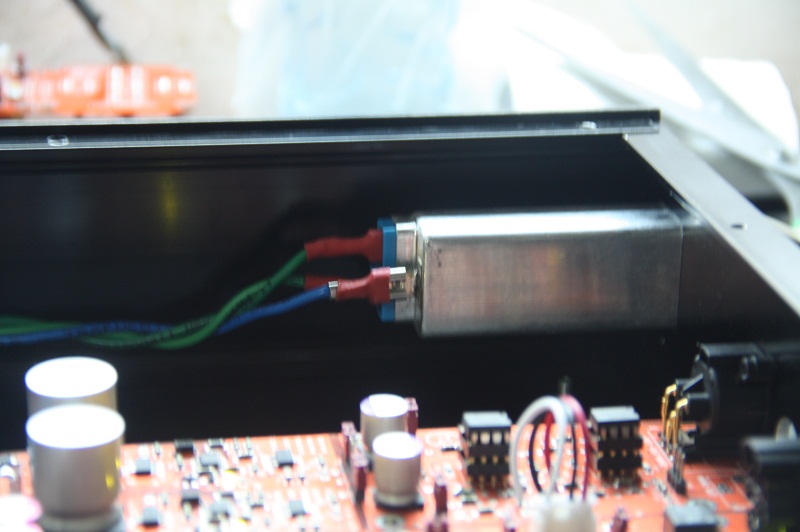

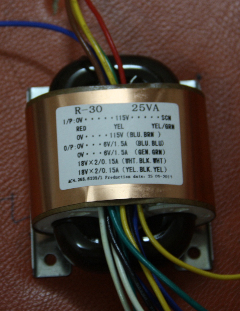

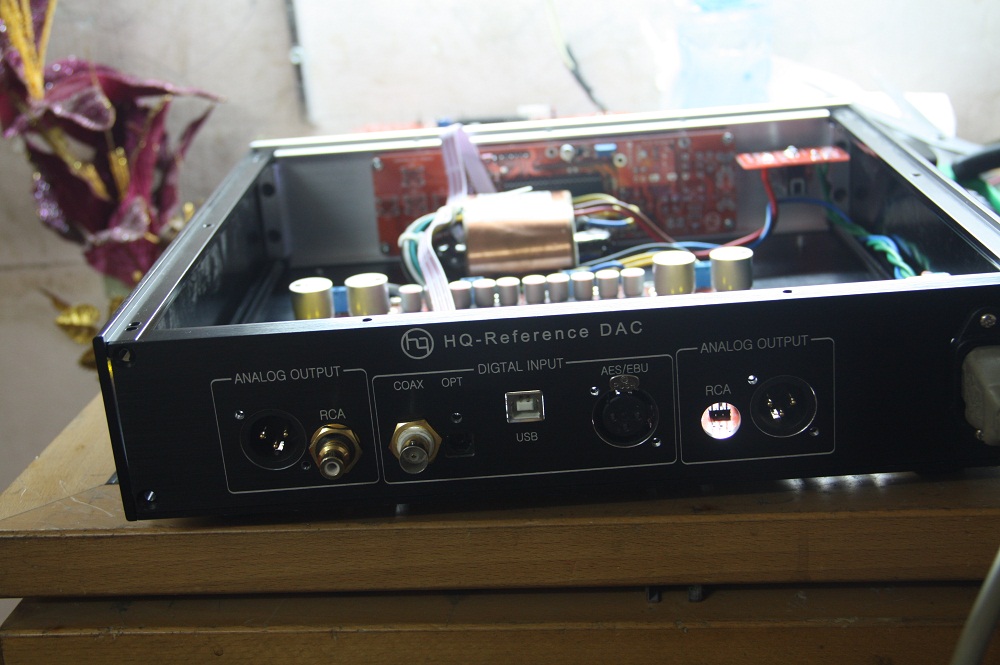

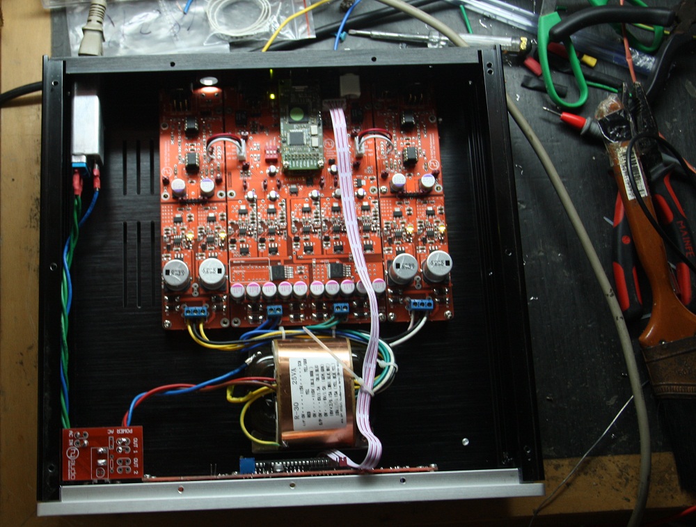

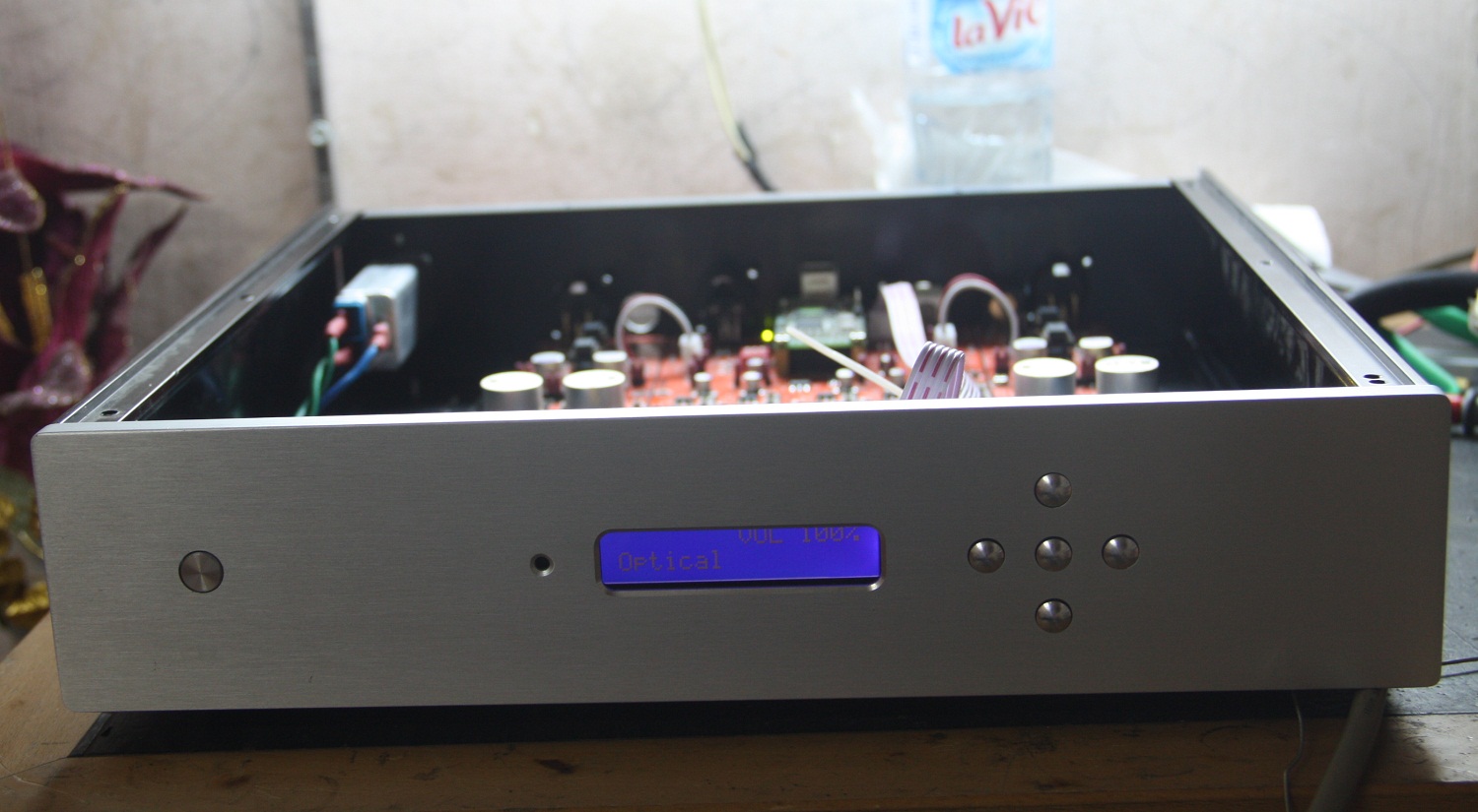

These transformers for this project, and a few pictures when complete DAC
I'm waiting chasis for it, I hope you understood me!
