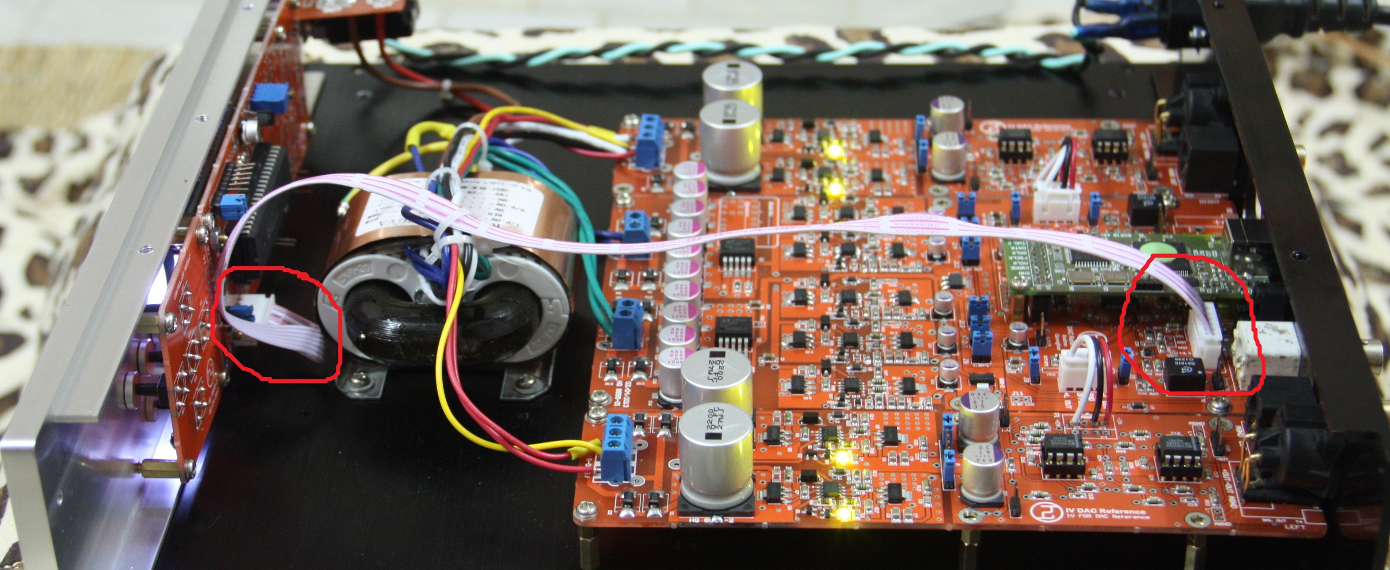

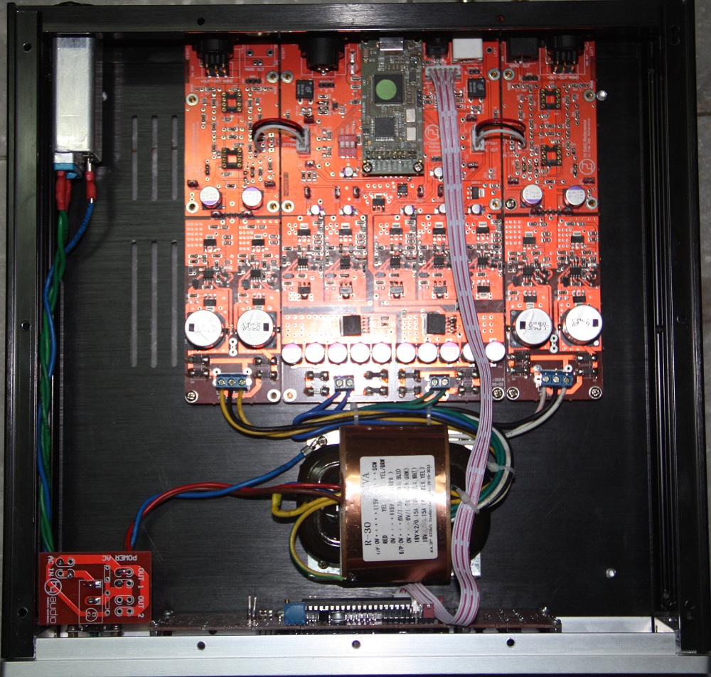

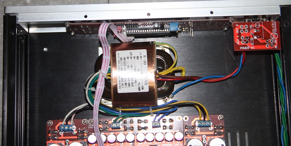

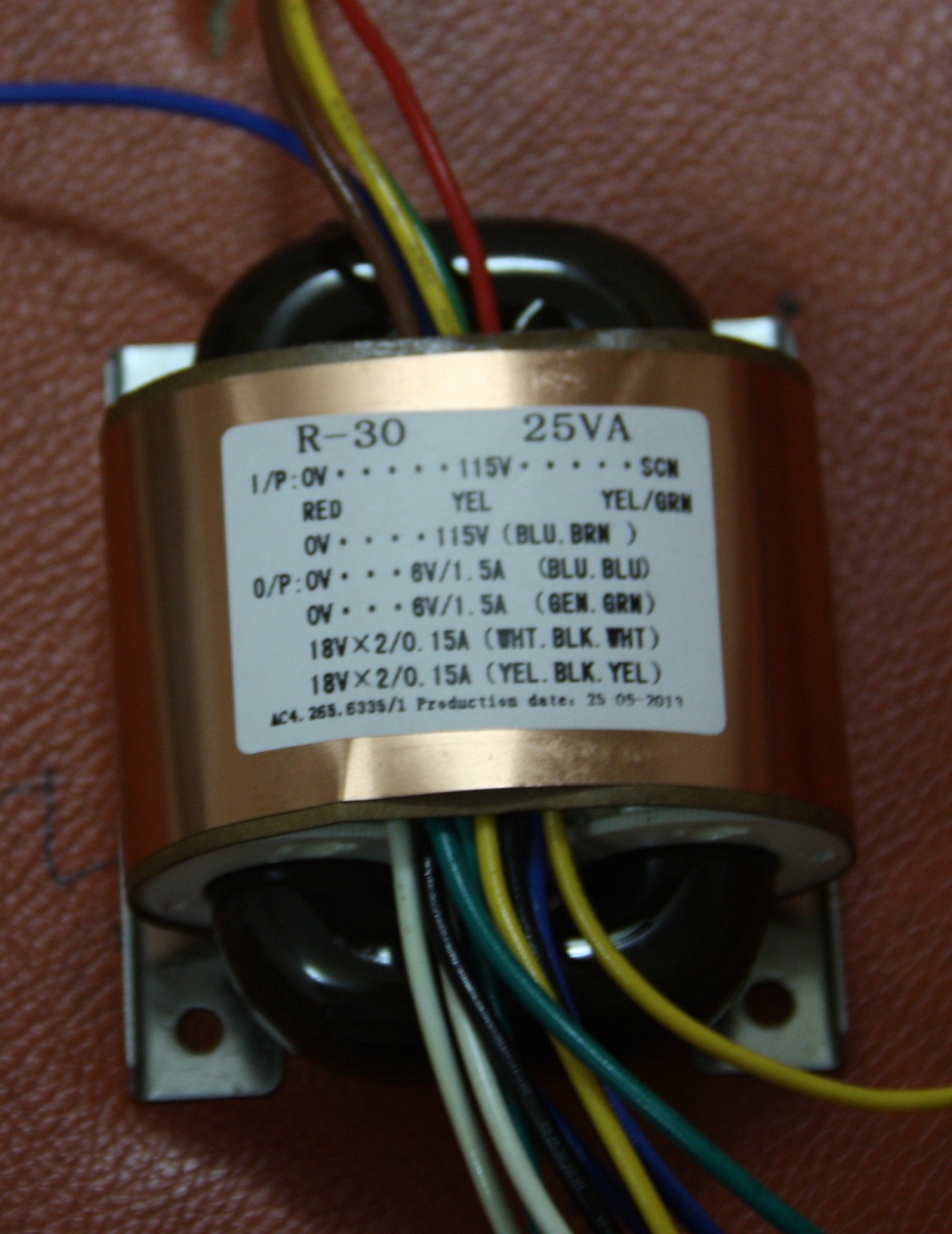

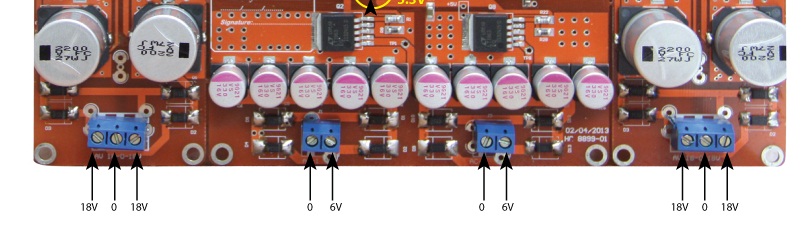

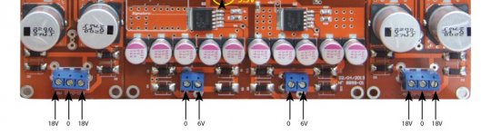

Hi quanghao,
Does the display board require a separate power supply?
Please be reassured that I was not implying the display board was not working. I just want to make sure that the transformers I am about to order are suitable for the boards.:eek:
see my connect:
