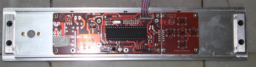

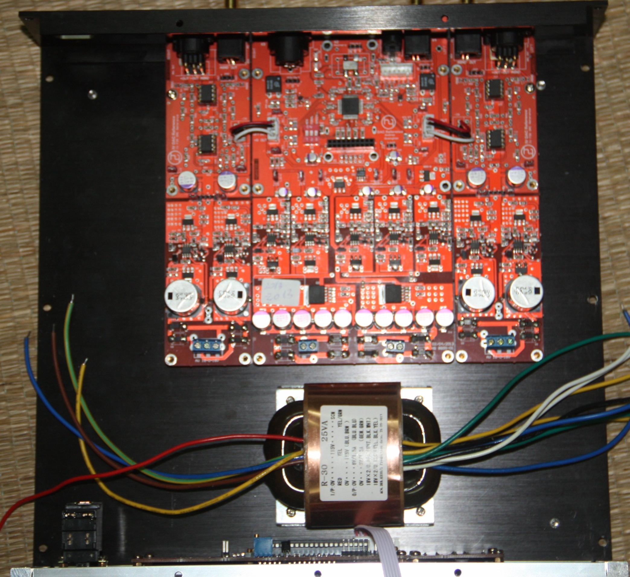

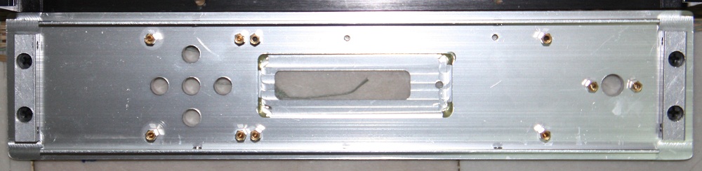

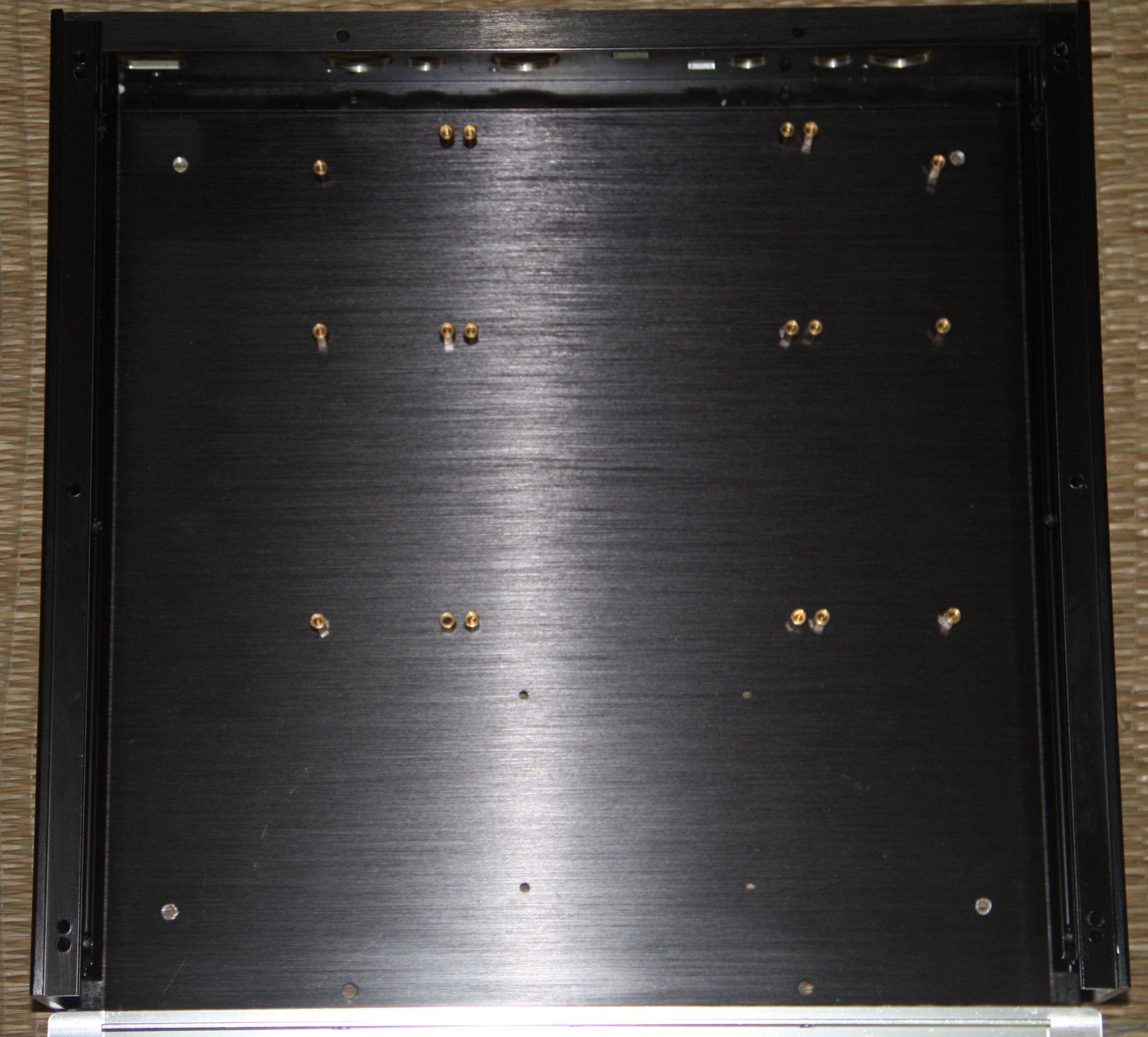

Hi guys, halo, congratulations you got the DAC and run it.
The remaining friends, including the DAC + power transformer ....
I need to do the following to ensure the transportation and the best for you.
I am alone, just the kids just do these things, but very hard but fun:
1. all mounting screws on the bottom
2. installed power transformers
3. mounting screws on the front
4. installation screen controller
5. DAC board assembly and packaging shell +
You see attached picture
Thank you all for your trust.
A dac running is a pleasure for me!

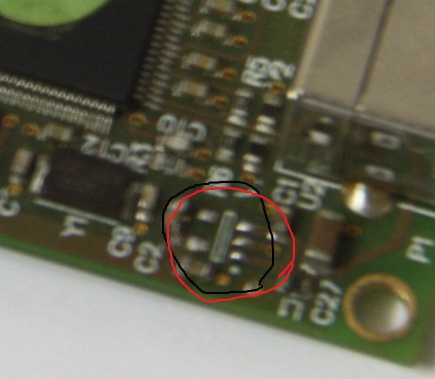

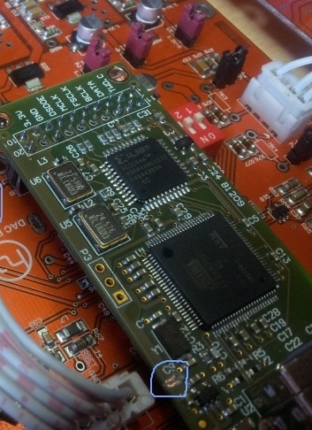

How you are using the Amanero module ?
The DAC module have a jump to set external power supply for Amanero mdule but to use this configuration it is necessary cut a pcb wire on Amanero module.
I suggest to do this, here the photo to this operation.
Sorry probably I forgot to give info on this.
Hi Andrea,
I'm still using usb power to powering amanero module
verify that the relative jump is open on DAC module

Hi Andrea,
hi!if you use 3.3v form the computer, use not use Jum: J3 ( 3.3V for USB)
Better you use 3.3V from DAC
thanks

a separate power supply 3.3V for USB, you can simply use Jum.
And how to remove the power supply from the computer like this photo.
Thank you!
Could it be ok just to remove the L1 ?
hI!
REMOVE THIS Ic, please see image

hI!
Done ! Thank You .
Done ! Thank You .
