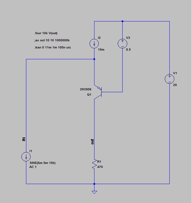

i'm going to try to explain how this topology works.
Its very simple, look at this image, we have a current source I2 , this current is divided by the input and output, if the input current increase 1ma the output must decrease 1ma, its similar to a differencial stage, there is no current gain, so this topology is more like a current mirror than a amplifier.

It's just a common base amplifier. There's nothing mysterious about it.

Are you sure that you understand how it works?
the input is a common base amplifier, and of course that there is something mysterious

It's a folded cascode stage. Some even replace the ccs (I2 in this simplified schematic) with a resistor, as it forms a ccs anyway.i'm going to try to explain how this topology works.
See here what I had in mind some years ago...you may also see how you can bias the input transistors.
It mirrors the input current to the high impedance node (collector).
