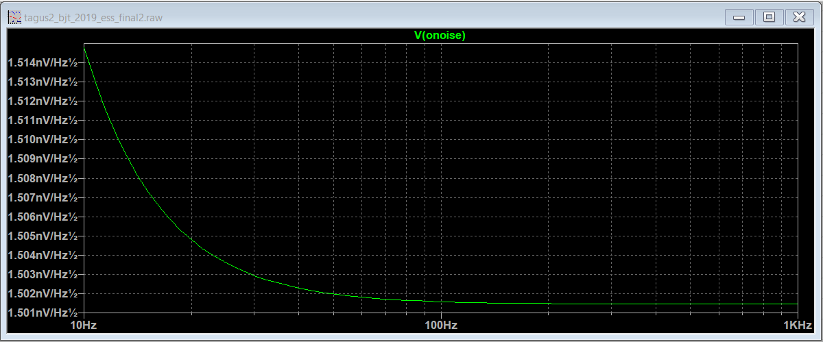

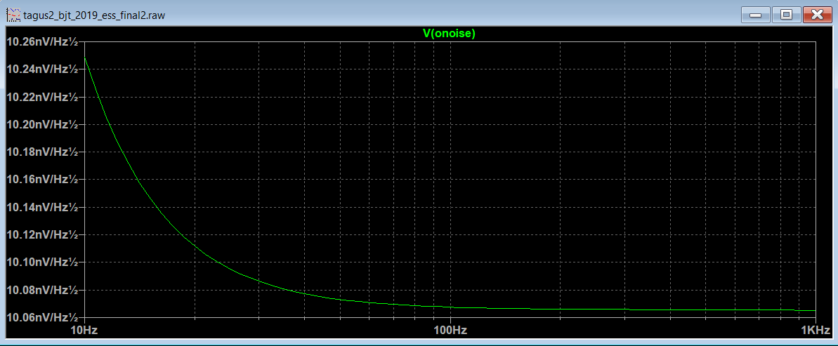

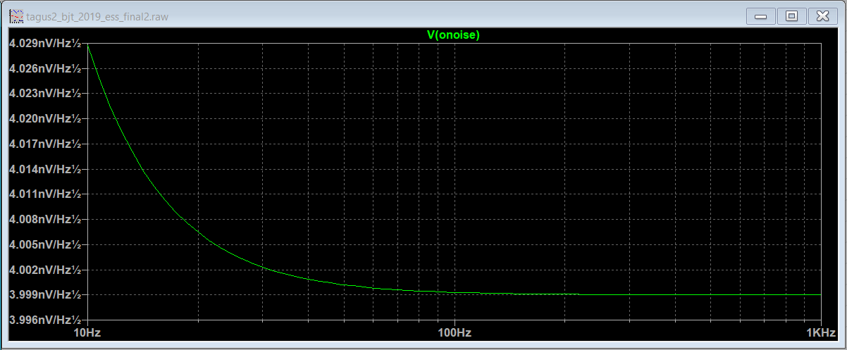

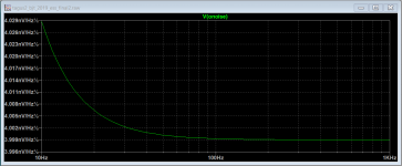

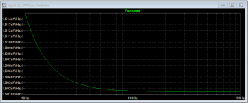

Keantoken is right, the input transistors are not very important for total noise, the ones that matter are the ones in the current sources and the emitter resistance of those bjt, there are some modern transistors that have rbb of less than 2 ohms (0.2 nV/√Hz), and those are perfect for the current sources
Noise for BC337/327 is less than 1nV/rt Hz.
WRT CCS generated noise, use larger value resistors and a larger ref voltage. As such there will be lower current gain and hence less current generated noise at OP.

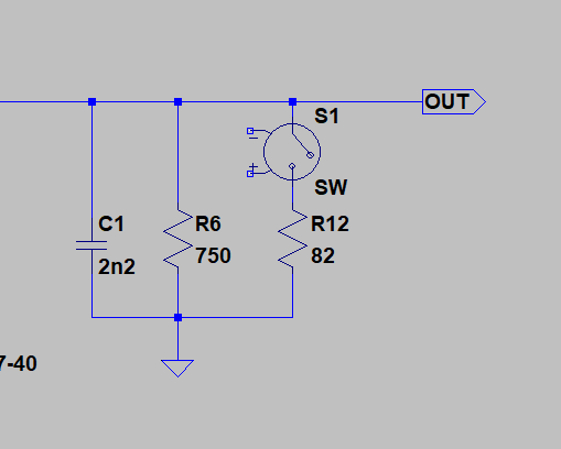

Hi terry, yes you´re right of course, this is a project in evolution and in the almost final version the voltage ref for the ccs is almost 11 volts
I decided to add the resistors (R8, R11) to lower the gain of the input stage and allow the use of a lower capacitor for the compensation, these resistors also decrease the voltage variations in the output due to temperature variations.
The circuit is stable even with a capacitive input.
With this resistors the input impedance is 0.2 Ohms from zero to 100Khz and increase to 0.5 Ohms at 1Mhz
