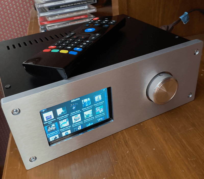

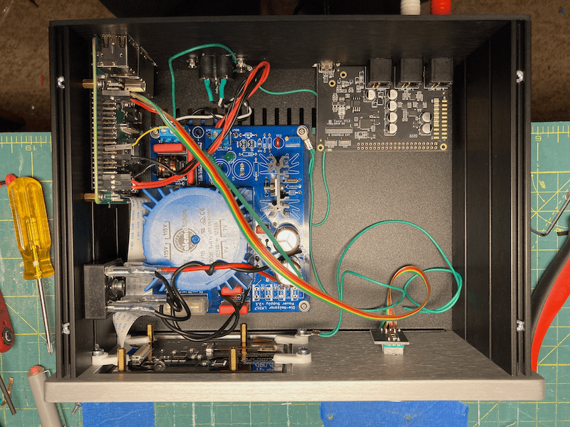

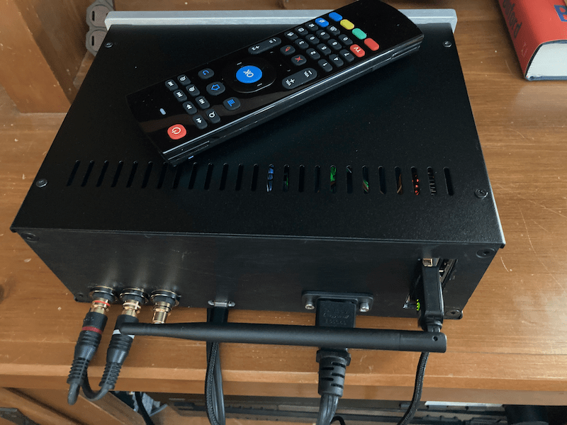

A couple of years ago I built a streamer using the Khadas Tone 1, driven by a Raspberry Pi 3B+ running piCorePlayer. I am pretty happy with the sound - I have been using it with my DIY "imitation" F7. So I can recommend it as a good low-cost DIY DAC option.
The display is a 3.5" DSI touch screen and the case was a Galaxy 2U chassis from Modushop, who machined the front panel for me. The power supply is linear and the PCB was based on DIYer Andy's (@iamwhoiam) D-Noizator over in the power supply forum. The front panel encoder is used to cycle through the music library and make selections. The back shows a WiFi dongle with an antenna and it has a wireless remote as well.
