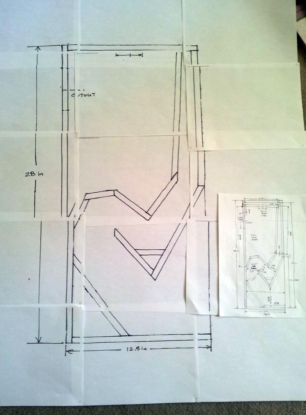

Your new PDF prints at 9 inches tall. Scaling that by 310% and tiling produces a composite equaling 28" 12.5 with just a little adjustment (~64th inches)
Now I have to go buy more Scotch Tape. 😉

I haven't cut any of the internals so I should be OK - unless you think scaling up to 31-32 inches will perform better. It might be good to finish the 28" and test first. Only $9 for a second shot.
Too late -been there and back - had to go out anyway.
Stick with the 28 in if you can - best to see what original design can do. I am going to be on travel over next 3 days so will not be able to check posts as often

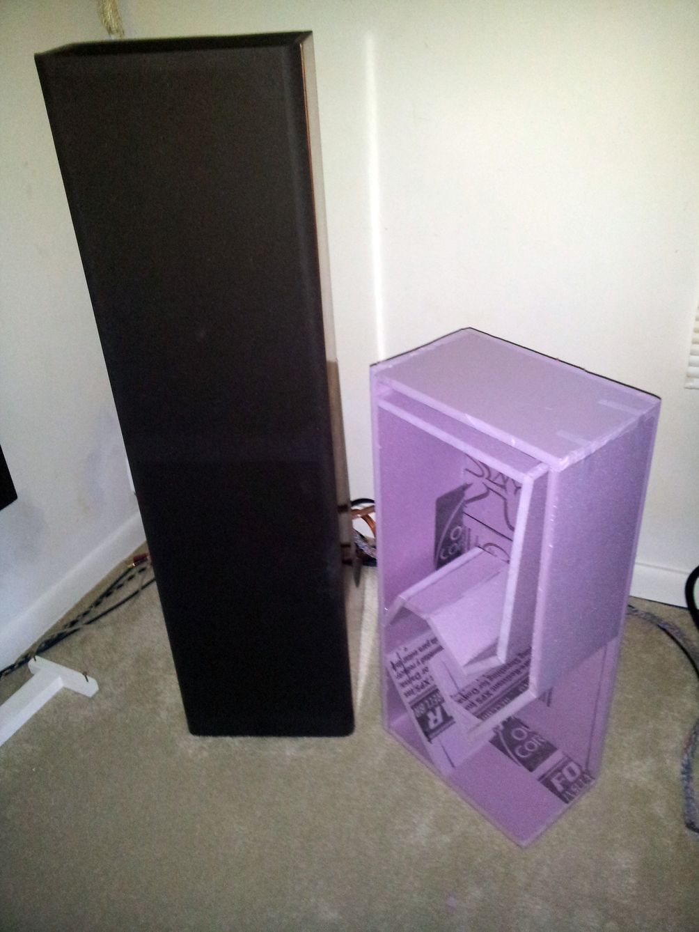

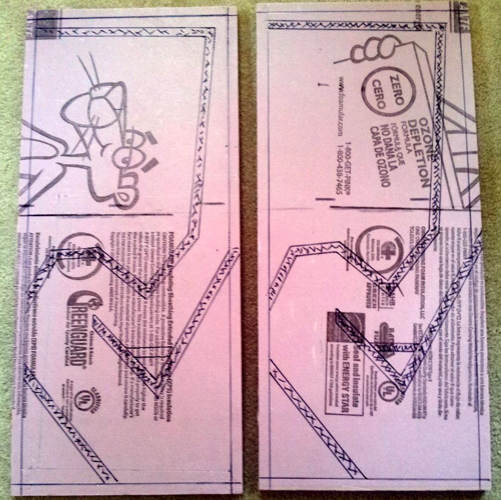

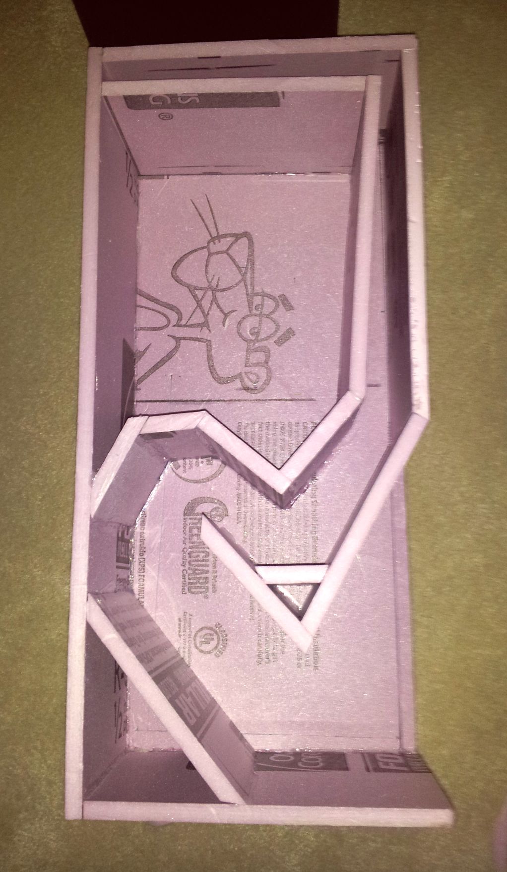

One 95% DONE !
This stuff is really different. Once the membrane is removed the hot glue can melt the foam. Luckily my gun had a low setting. I tried to wipe all the joints but some blade work will be needed. Might cover all the internal bends with something like 6L6 did on the Cornu.
Drivers will be here tomorrow so there may be an audition by this time in the evening. (I know Cal, DIYers should never say "I'll be done in about......"😀)
DNA next to Sunflowers.
Landed in LAX, will be here for next couple of days. Very nice progress there Bob! Looks great. Will you be cutting a round hole or a slot for the throat? I assume it is easy to cut the stuff in-situ with an x-acto or something. I am glad the drivers will be there tomorrow - can't wait to hear what you hear. 🙂

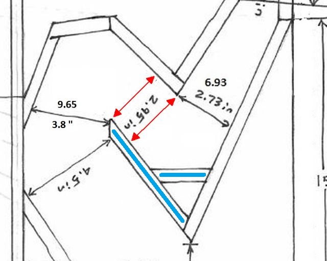

I'll take your recommendation whether to use a slot or a hole. This stuff cuts easily and cleanly as long as the blade angle is low. I have a set of hole cutters if I go that way.
One concern - there may be another short pinch that needs to be adjusted. I'm not that savvy about the dynamics at a turn like that. I've already removed the two blue pieces but need advice on how critical that small segment is.

Bob,
I saw this pinch too. Not critical - it hardly changes the response in the model if you adjust it one way or another within a few mm. If you want a truly expanding horn, rotate the lip CCW a few degrees until the flow passages are expanding on both sides.
