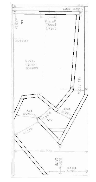

I was going to do a quick sketchup model of this but am having trouble reconciling the dimensions.
I took the jpg that was posted, and re-sized it. It was not to scale as shown nor proportional, btw.

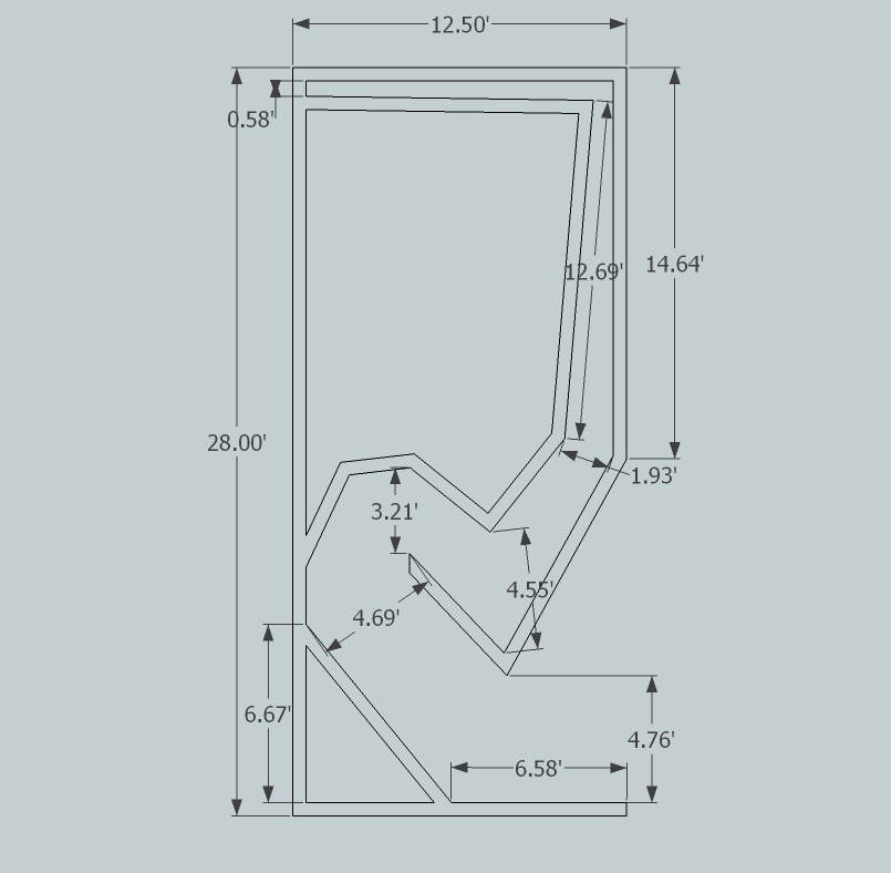

You can see how I traced the resized drawing with a CAD program. Then I imported into Sketchup to have it show the dimensions. Some of dimensions are close, some are way off.
Help!

Tom, I think that is very helpful. I took my first look at Hornresp yesterday and it would be interesting to input both sets of dims to see which works out better. I'm not sure if that's the program X is using, but there should be something that can dial in on the best flair.
