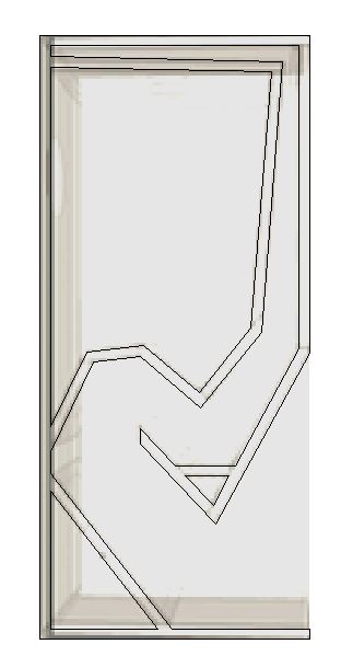

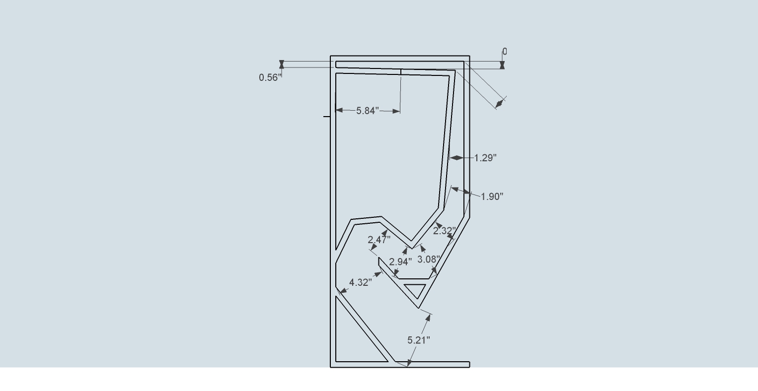

What I need is a little more guidance to make this drawing. In other words, do I go by the sketch itself or the dimensions? The reason I went with the sketch itself is there doesn't seem to be enough dimensions to construct a drawing.
Tomlang,
Use the drawing in post #58 : http://www.diyaudio.com/forums/attachments/full-range/347289d1367939164-decware-dna-horn-dna-plan-rescaled.pdf

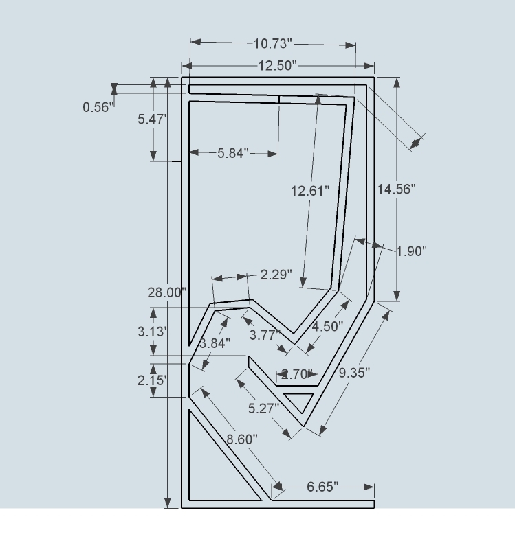

I messed up on the first drawing when I converted the 3dim perspective to 2d in only 1 dim. It ended up lengthening it to about 20% too tall. The new drawing has aspect ratio corrected. There are two known dimensions shown and you can work out the rest using scale in CAD program or a ruler.
X
Here is the latest tracing it full size. Before I go any further, let me know if any dimensions need to be changed. This is using 1/2 inch material.
I'm seriously considering making one of these using 3/4 material (yes, I know I have to account for that). However, I want to use the MCM Part # 55-1870 but shows backordered till August!

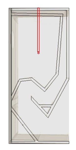

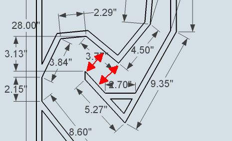

What does your CAD program read through this section. Is there a pinch?
Also, I started this yesterday but didn't complete. Since you have the linear dims (one long straight line), can you lay out the widths at segment points with vertical lines to get a picture of the expansion. Would be fun to see.

Tomlang,
Very nice CAD drawing - thanks for doing that for us. Looks like you are doing this is Solidworks based on the the appearance. Nice CAD program - I use that myself when I want to model something in 3d.
I agree with Bob that visually it looks like the horn actually contracts here. But that may be intended by the designer. What we did was to rotate the lip piece CCW a few degrees until the channel on both sides was expanding. Otherwise it looks good. If you want mcm 1870 driver you need to reduce driver chamber volume to about 5/8 of what it is originally. Either by putting walls inside to make volume smaller or adding blocks of stuff to take up volume.
Good luck! 🙂
It definitely pinches per the first drawing.
I also traced a near side view from this page, that is the 2nd drawing. Scroll down till you see the 4 views. It is slightly different, still a pinch though.

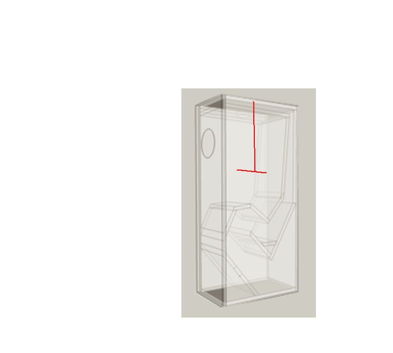

1. What picture did you initially scale from?
2. I read earlier but am confused what to change to use two of the really cheap Madisound drivers in one enclosure.

Unless you are building with wood, my trial indicates two drivers will create massive fluctuation in the top half, both sides and top. The same may result from using a driver with a larger/stronger magnet. If you use FC try to find something with high density (small bubble size). A couple strips or a plate of thin plywood on the outside - tied together with wood dowels - might help.

The fully measured drawings are available from Steve for $20 (some folks have already purchased them, even if just for research purposes 😉), and should save all the guessing.
As Zobsky pointed out several pages back, with an over .5ft^3 driver chamber, this is really more of a hybrid BVR with a long folded vent than a "true" BLH (whatever that is 🙂), and as always, it's the results that really matter.
It's not at all unusual for designs of this type to include a "pinch" in the expansion flare near the mouth, the FH3 certainly does.
