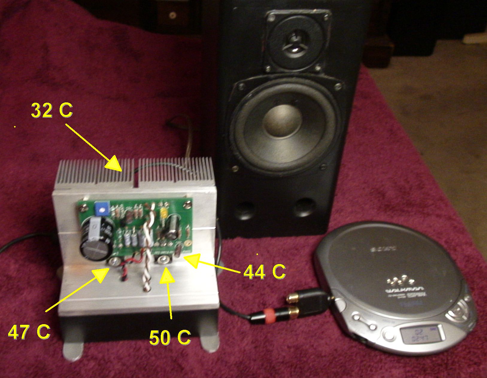

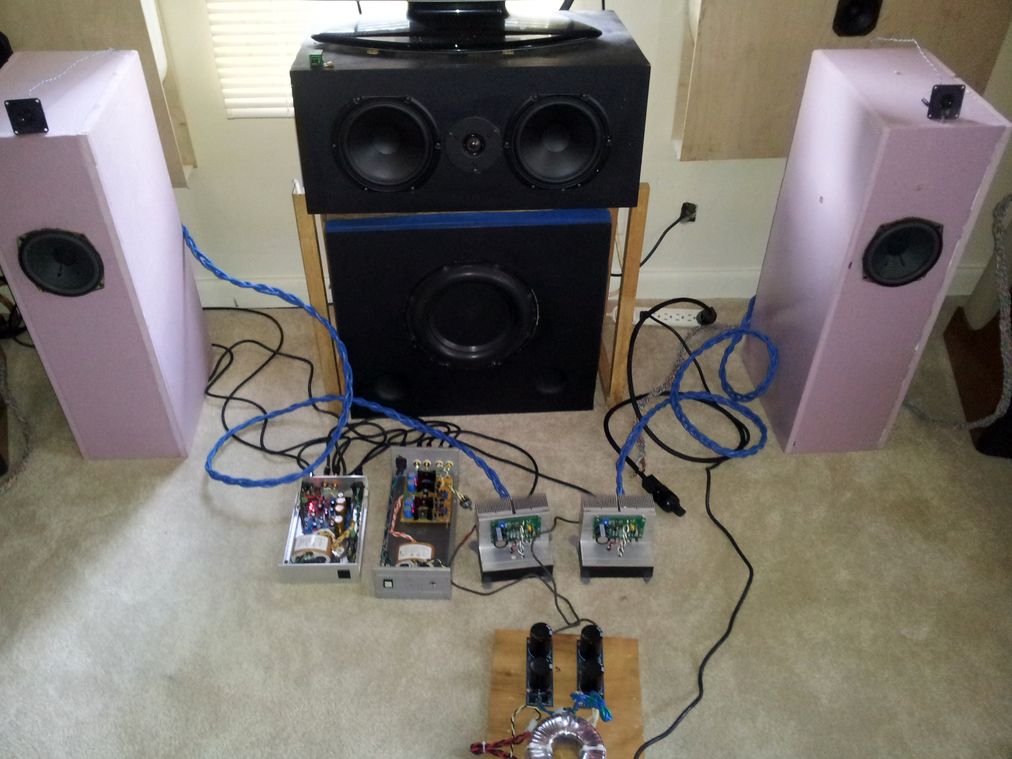

The DNAs and the ACAs do indeed make a nice combination. I've been using the Honey Badger amps for all the auditions so far, but the Amp Camp modules hold their own for a low cost easily built complete system. There is a little less body again at the low end but all the notes are there. Just for a simple approximate comparison - I have a $125 Sony Boom Box (W/Turbo Bass Boost 😉), and this combo sounds better. That's great for a $30 pair of amps and as X says - a $16 speaker that does 30 Hz. Of course the BB doesn't get anywhere close to the width of stage and voice/instruments placement produced by the DNA pair. A direct feed from the Walkman sounds great, but the DNAs can make good use of a lot more power than that.
The timbre of this combination is a bit lacking but that, IMO, can be tweaked in with some crossover work and/or a different tweeter. I think the bass response can get better once I move the Cornus and the Sunflowers out and get the DNAs closer to the corners of the room. I'ts pretty cluttered on that wall. I'll report back on that later. I believe the Cornus offer a little more flexibility of location, but that shouldn't stop one from building and trying a pair of these.
I'll add that the exceptional horn effect like the 30 Hz stuff reported earlier doesn't translate directly when the more complex wave forms in music are played. I think that is to be expected considering the small magnet/motor on these drivers. The Vifas most likely have a better grip on the cone movements.
Just happens I read a statement on the Bob Brines site today describing the listener's approach that fits well here..... paraphrasing: - excellent results can come from realistic and moderate expectations of the equipment being used.
From what I'm hearing, this combo matches that sentiment.
BTW: I'm familiar with the concept but not very knowledgeable in application - does anyone think there is merit to distance/offset calculations for tweeter placement for this build?

If you want, I can sim the tweeter placement for you in AkAbak - just need the T/S params and cross-over specifics and connections - AkAbak does it all - the electrical as well as the acoustic portions, in addition to placement and diffraction effects.

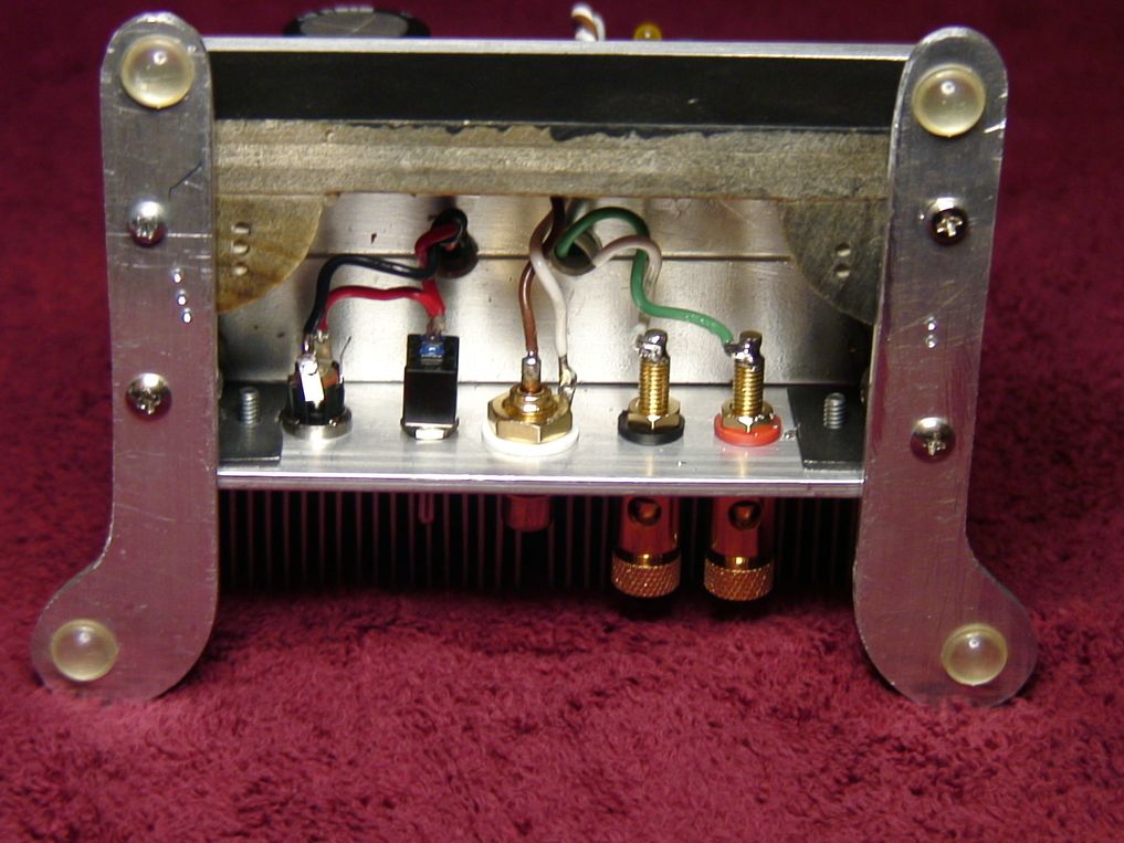

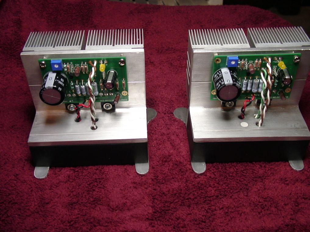

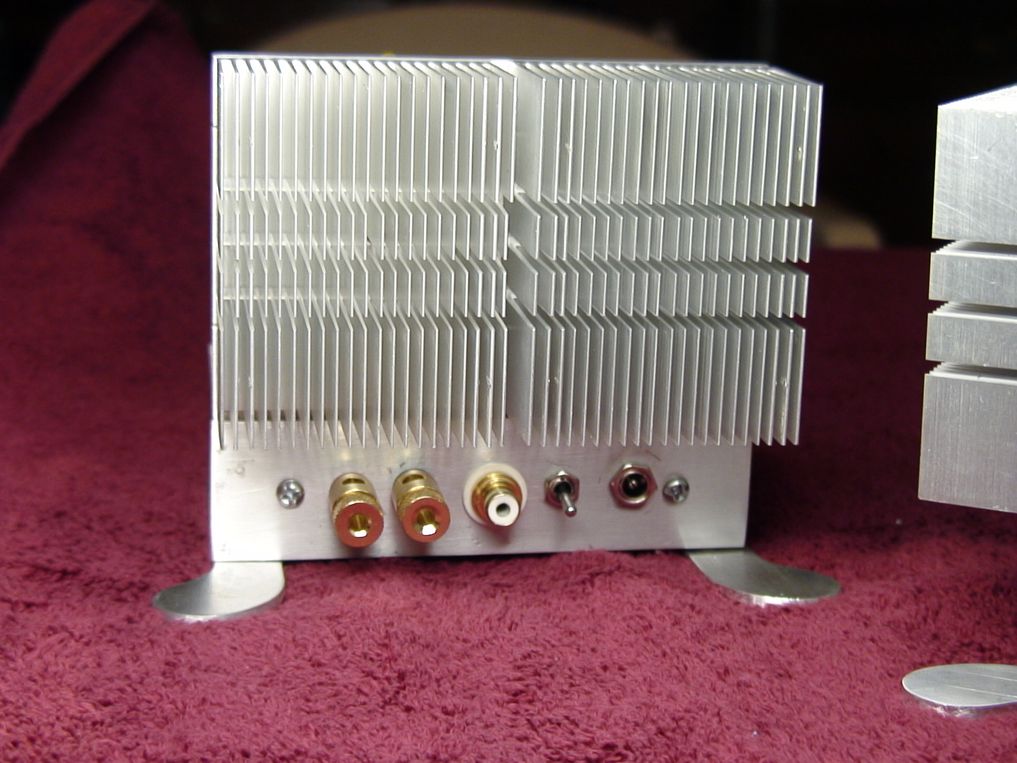

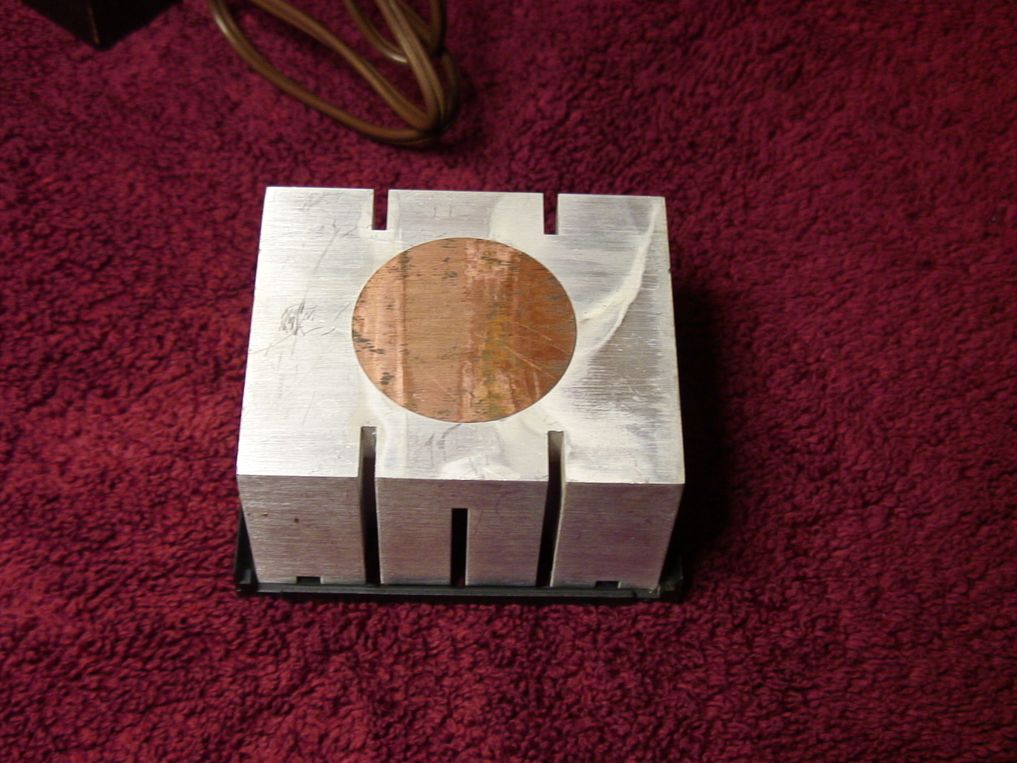

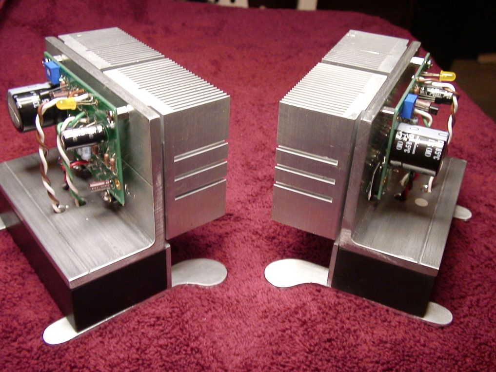

I posted somewhere but don't have the link handy. I'll take the risk of hijacking the thread and repost till I find it. There was some text but here are the pics. Two xeon heatsinks per amp.

Thanks all for the complements. Yes, PC stuff - I got bunches of them while building a render farm with a some dual processor surplus motherboards.. They came from eBay about four years ago. There are still some good units there at a bargain.
I salvaged four 8' links of 3" X 3" X 1/4 structural aluminum from my former employer. I'm gonna be lost when I run out. !!!
That's a nice score of aluminum angle stock. Metalsdepot.com sells 8 ft of 3x3x0.25 angles for $91 ea. Another option for amp structures with lots of surface area for heat transfer are Bosch rails.
