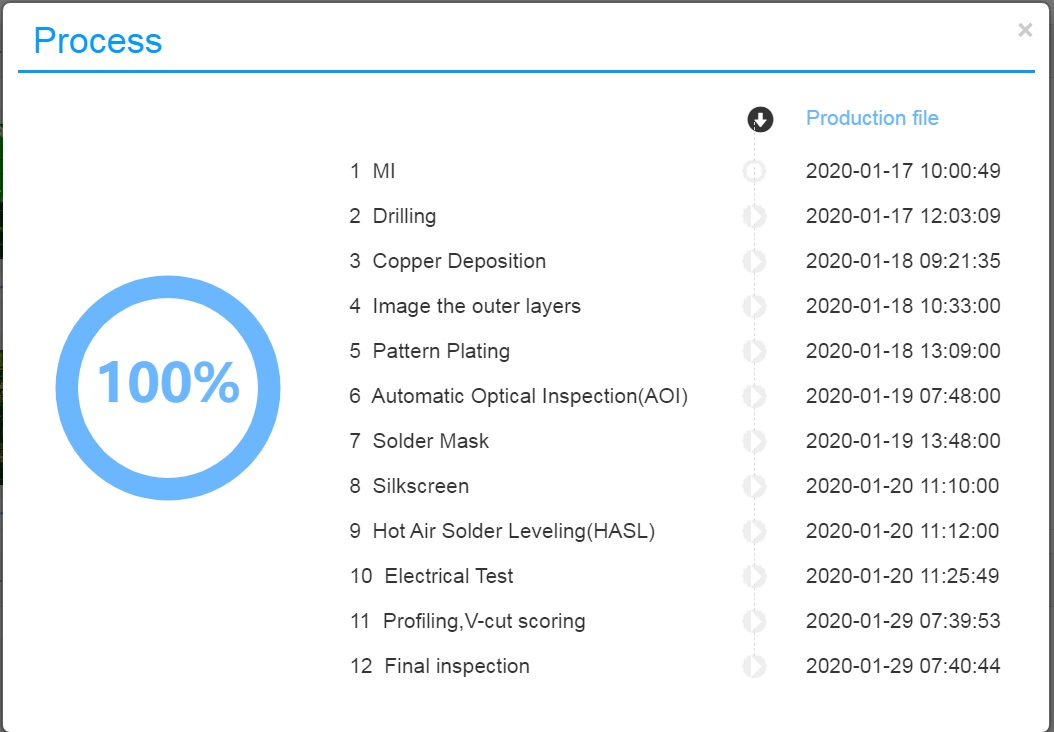

My PCB did for a long time

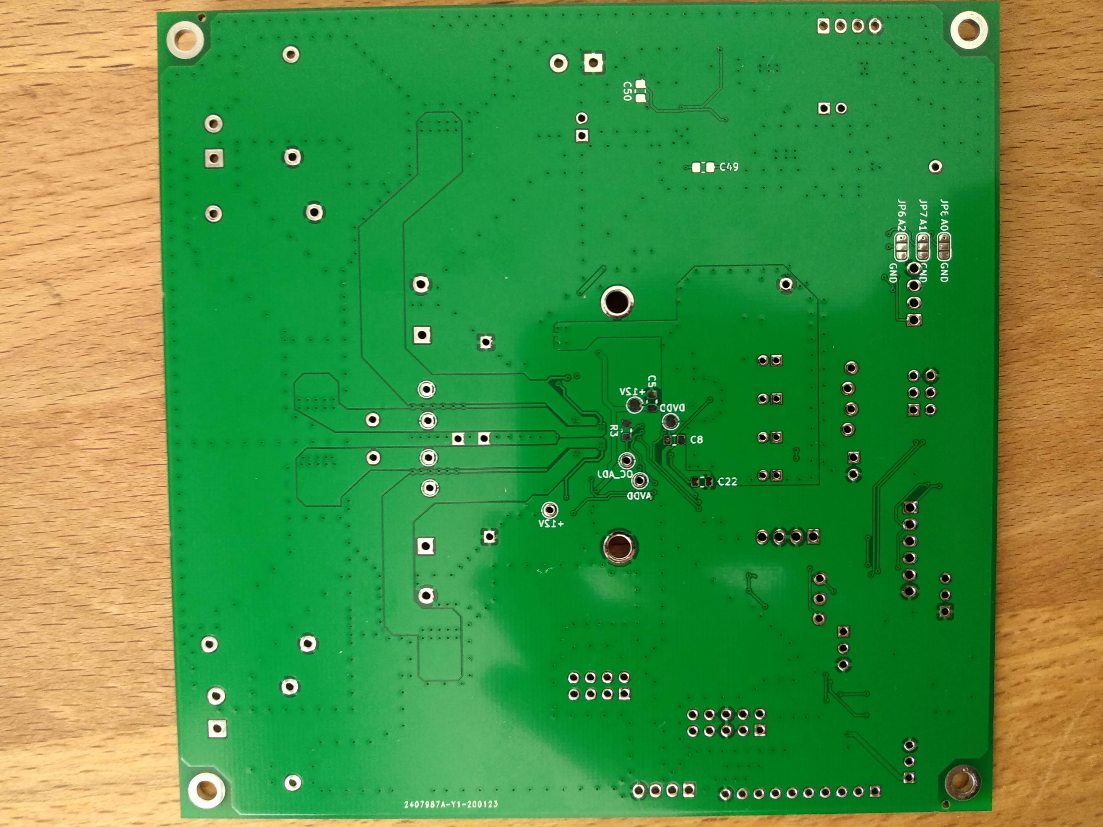

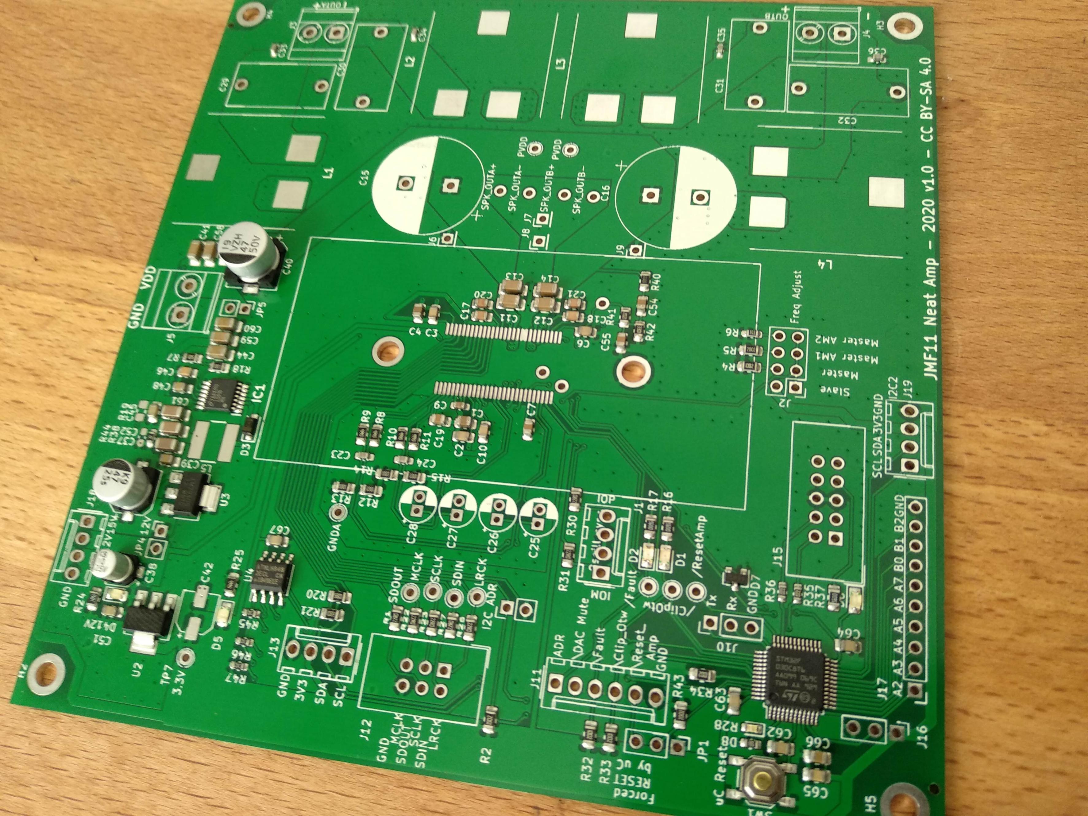

Here they are. Nice work from JLCPCB. Some pictures just out of the box. Somehow rewarding to see the physical result of this up to now rather abstract work.
Time now to order the remaining components and ship to who has booked boards and are still interested.
JMF

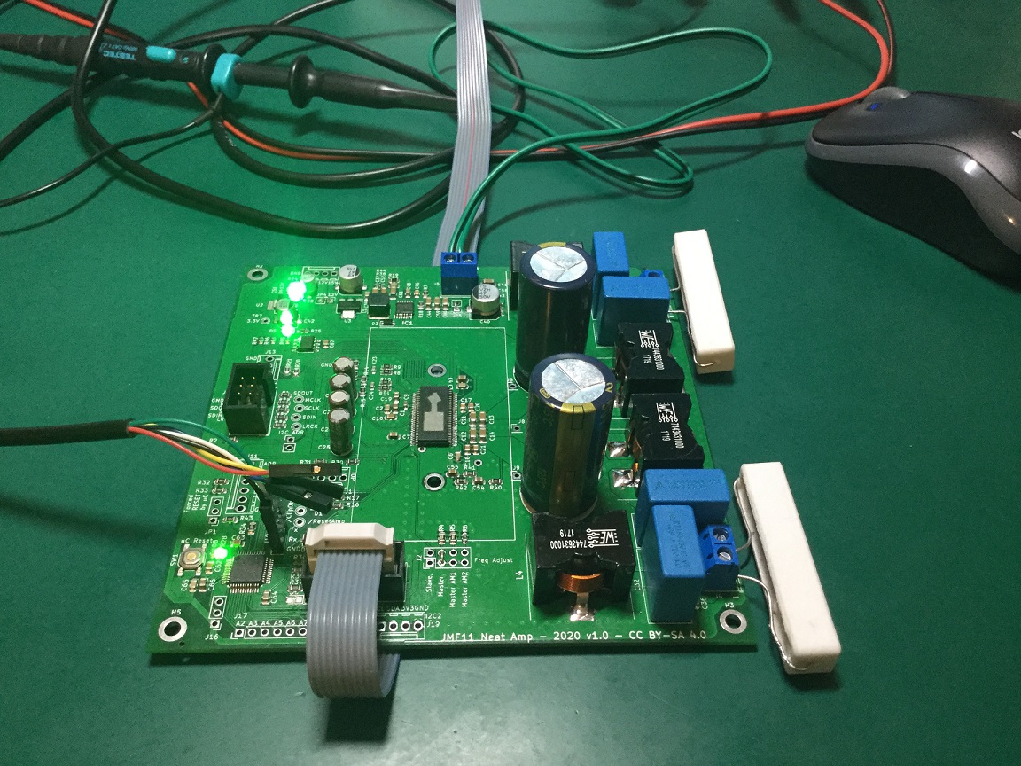

Update
As the software is now well advanced, it’s time to test if some sound is produced by the amp !
All the parts are now soldered (c17 and c9 were too close of the TAS, I had to remove them while soldering the TAS). Next step consist to be able to write the configuration into the TAS to get basic confirmation of operation.
Currently the software provide:
  • The main structure to handle the events
  • A serial monitor to handle commands
  • A Ymodem file downloader
  • A parser to handle the content of the files with TI Pure Path Console 3 format; I’ll later add a custom format to easily load biquad coefficient calculated without ppc3.
  • A basic management of preset (uploaded) memories of process flow and of filtersets which will allows to easily change behaviour of the amp on the fly : without having to upload a file. 6 process flows and 6 filtersets are available for now.
Remaining parts to write:
  • TAS loader of config and filtersets stored in memory Exception handling : TAS errors and power supply watchdog
  • On board management of basic process flow parameters : mono/stereo; Left/right swap; volume control
  • Direct console to I2C write (same as in ppc3)
A first sound test is expected this week, but as lockdown doesn’t mean less professionnal work, there's no garantee on delay…
