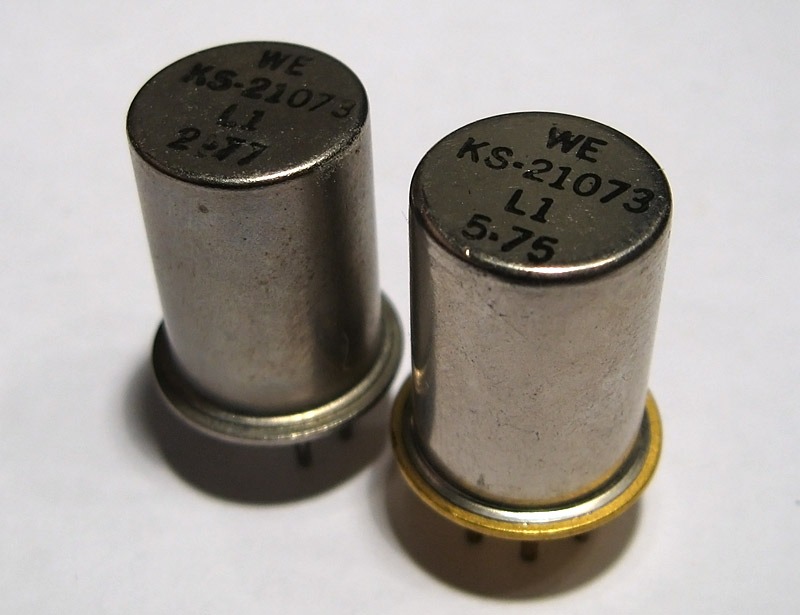

Well, that one 😄, because it has a dual gate which can be used to simulate a triode internal NFB.
But not 99.998% of Fets or MosFets out there, including the new darling being discussed here: LND150 😫
1. I was pretty sure that the dual gate MOSFETs now are either Un-Obtain-ium, Obsolete-ium, Rareified-ium, or only found in Museums.
