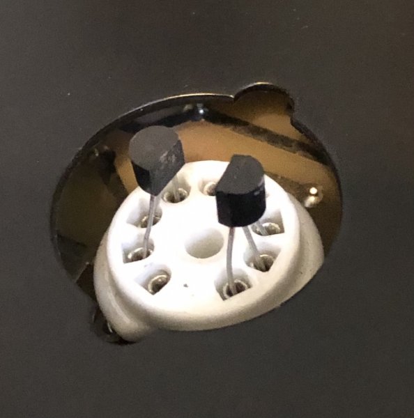

Some experiments here from UK Vintage Radio
ECC83 from a broken ECC81 plus two FETs
I still find this concept fascinating, due no doubt to my lack of deeper electronics knowledge, thanks! I have an etracer tube tracer, I wonder what the curves and characteristics of this LND150 dual triode "tube" might look like compared to other dual triodes? I know this is all an intellectual exercise, expecting drop-in "SS tube" replacements to work in all contexts is far fetched. But in a simple example that splits a dual triode as input stage followed by a concertina inverter... How far fetched can it be to have a real vs. "fake" plug in option; as a part of the whole tube rolling experience?. Two amber grain of wheat bulbs could impersonate the filament.

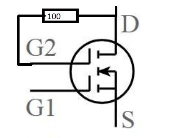

Long ago, when dual gate MOSFETs first came out, I never noticed any application that "Triode Wired" it.
But that long ago, I did not notice any Pentodes and Beam Power tubes that were used in Triode Wired mode, either.
(but we know that "Triode Wired tubes" preceded JFETs, MOSFETs, and dual gate MOSFETs.).
I wonder if anybody still has any dual gate MOSFETs. I remember them as small RF devices.
Has anybody Triode Wired them, and used a curve tracer?
What are the curves like in that mode?

The LND150 (and many other mosfets) makes a good concertina phase splitter. I have used them in this capacity with both low and high voltage.
George (Tubelab) has posted that he has put them in a 12ax7 socket setup as concertina and used the without any changes to the circuit.
Steve
Steve
