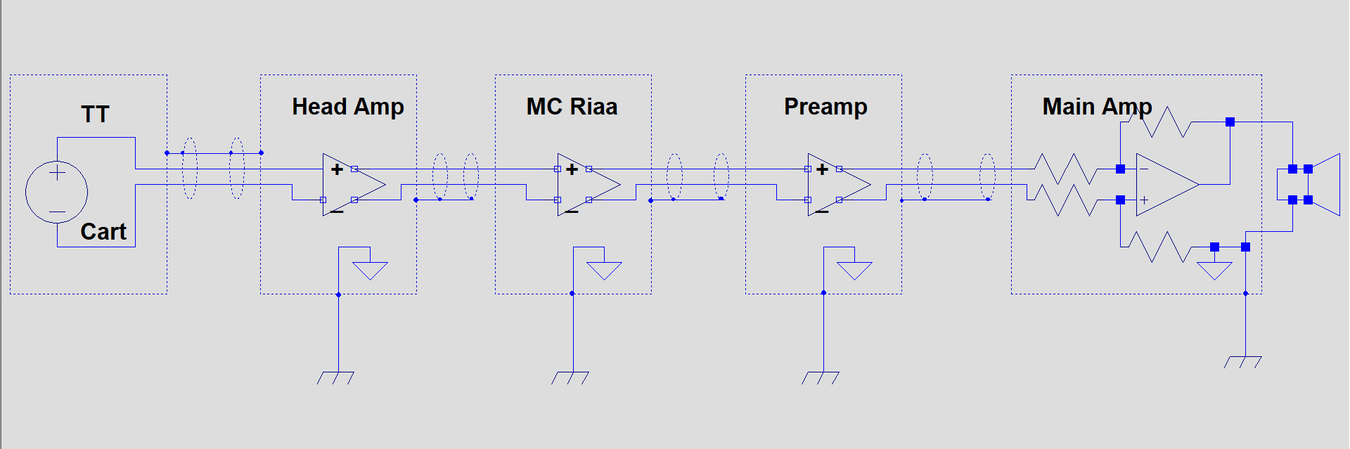

Hans, if you were going to box this up how would you do the grounding? For normal balanced operation there would be a STP cable from the tonearm with +/- connected and the screen as 'pin1' straight to the box with same on the output. The Nokia wall wart is not connected to PE (if it's anything like the ones I have) so it is floating as would be on battery? Is this howyou would do it?
Bill,in the image below I have tried to sketch how I connect my equipment.Hans, if you were going to box this up how would you do the grounding? For normal balanced operation there would be a STP cable from the tonearm with +/- connected and the screen as 'pin1' straight to the box with same on the output. The Nokia wall wart is not connected to PE (if it's anything like the ones I have) so it is floating as would be on battery? Is this howyou would do it?
Every individual part is diff-in / diff-out.
Since you only need two wires to transfer a signal and not three, Pin 1 on the receiving side is not connected and every box is individually connected to mains gnd.
This way of connecting, called OEO (for one end only), prevents ground loops and equalisation currents between the different chassis, since the chassis all have slightly different voltages with different pollution.
The CMRR of all modules are well able to suppress these differences.
As a matter of fact, at this very moment, the Head Amp is not even connected to Mains Earth and is fully floating, but no sign of any 50Hz hum with the Power Bank or with the Wal Wart.
But when I have finalised my listening tests, I will pay some attention to this aspect, because the output can also be switched to SE.
In that case the Head Amp box will automatically be connected to the box of the MM amp. In Case of using a DSP, the differential connection is to be preferred.
Hans

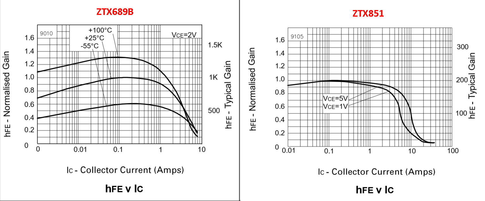

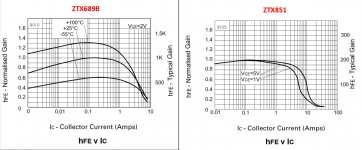

Hans - Remember this sim? A Low Noise Balanced Input Moving Coil Preamp Using the ZTX851 - Page 44 - Pro Audio Design Forum
Would you mind running it again and increasing rbb for both transistors until it becomes 2.7 dB noisier?
That's the approximate noise increase switching from a ZTX851 to the higher gain ZTX689B.
I'd like to confrim my rbb estimates. The ZTX689B (and ZTX789A PNP) will make good mic preamp input transistors.
Thanks in advance - Wayne.

So for 0.32nV/rtHz equivalent input noise, you only need a Head Amp with a flat equivalent input noise of 0.64nV/rtHz.
The ZTX689 measures around 0.6nV√Hz flat...
Hi Wayne,Hans - Remember this sim? A Low Noise Balanced Input Moving Coil Preamp Using the ZTX851 - Page 44 - Pro Audio Design Forum
EDIT:

I have calculated the input noise of your amp with Rg=1R and Rcart=10R with an Rb of 1.5R
After subtracting the noise from Rg+Rcart=11R I got 55.5nV RTI from 20Hz to 20Khz for the bare amp.
2.7 extra noise means an increase to 75.5nV RTI from 20Hz to 20Khz.
I had to raise the Rb in my ZTX81 model from 1.5R to 5.3R to achieve this target.
I hope this is what you had in mind with your question.
Hans
(corrected part number typo)I had to raise the Rb in my ZTX851 model from 1.5R to 5.3R to achieve this target.
Thanks Hans. That was pretty close to my guestimate based on working backwards form the noise measurements.
Looks like we have another winner in the ZTX689B. (And ZTX789A.)

This is only part of the story.
Looking at the ZTX689B, one can see in the image below that the hfe at Ic=5.5mA will be reduced from 500 to the same level as the ZTX851.
This implies that when wanting to take profit of the high hfe, Ic must be reduced to 1mA.
This has an adverse effect on the noise, because the 1/2gm noise component goes from 2.3R to 12.5R.
I have simulated again with Rb=5.3R but now with Ic=1mA for the ZTX689B.
The effect is a 6.2dB raise in noise compared to your ZTX851 design running at 5.5mA.
Hans
