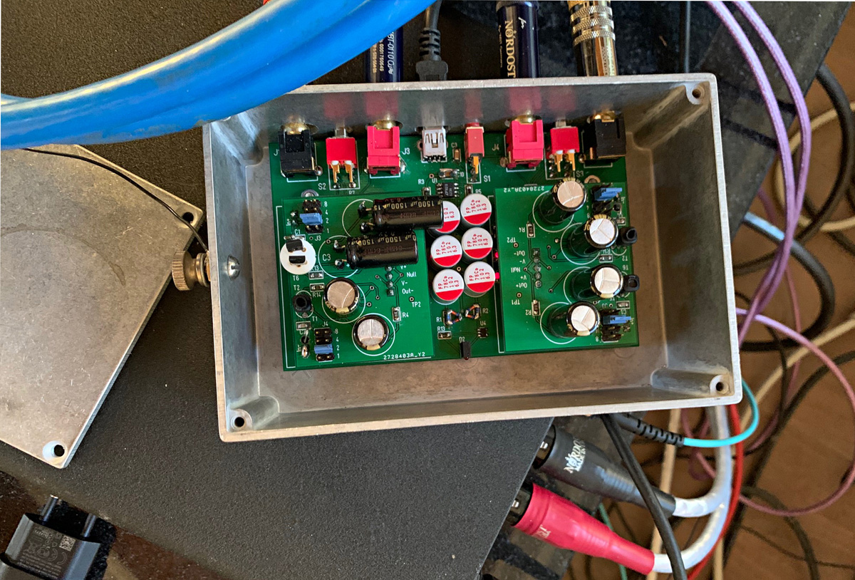

I just noticed R1 and R2 on the mainboard in the photo above [#227]. I've never seen parts like that. What are those?
As with the two electrolytic caps lying horizontally and the sockets for two ZTX transistors, this amp is the prototype for the final version.
R1 and R2 were paralleled with two diodes as test to accelerate power on, but since this did not bring any improvement and they do no harm, I just left them so please don't pay it any attention.

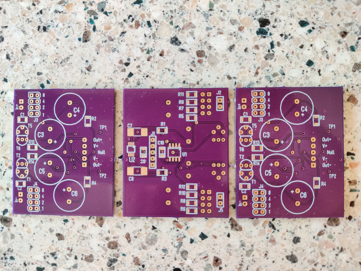

I have reached the point of no return on this project. The initial three transimpedance amp boards arrived in the mail today. I didn't order the main boards yet, because I switched to a new supplier and wanted to see their results first. They look good to me so far.

..... 1) The two emitter resistances have been removed, resulting in less noise. The reason they were there in the first place was to relax the Vbe differences between the two input transistors. But because U1, the LT1884 takes fully care of correcting these differences, we no longer need them .....

Does the transimpedance amp benefit in any way from matching the input transistors after this change - within each pair and/or between the two pairs?
Hans
Hans
I started with matched transistors, but after having socketed one pair, I could plug in any non matched transistor without any effect on noise or input offset voltage.
Differences are completely corrected by the servo.
At the same time my experience was that all transistors from various batches where quite close within a few mV Vbe.
Hans
Update on previous information, with pictures added to the Dropbox link.
This universal Diff In / Diff or SE Out Head Amp, as its name suggest, can be used in many ways to amplify the signal from almost every MC Cart, both as a Voltage Amplifier but also as a Current Amplifier.
With its independent power supply and low output impedance, the Head-Amp can be used to steer a high quality 47K MM phono amp, but also a DSP without having to use its Phantom supply.
When having changed to a new very low output MC Cart, the Universal Head Amp can also be used between this new Cart and the existing MC phonoamp.
For power supply, a small 10A/hr Power Bank has enough energy for 300 hrs of operation between reloads, but also a 5Watt USB mains adapter can be used.
