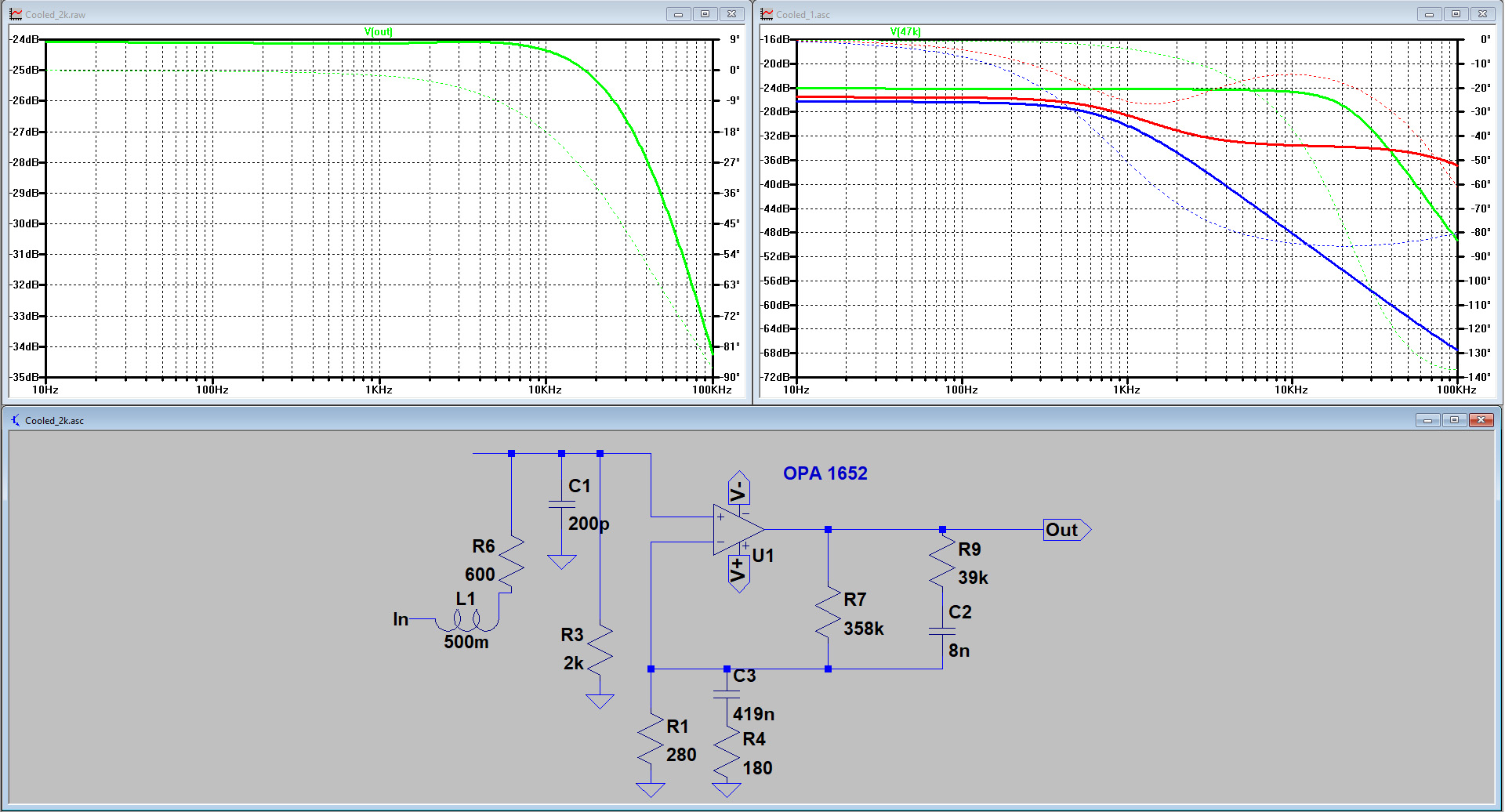

And just when I thought I would start with the easy one (mic input) first step is the manual. The spec for mic input impedance in the manual is 2kOhms. I'm not sure I want to blindly accept that but trying to think of an easy way that someone with minimal test tools could do.

Here you can see what happens with Rin=2K. I suppose you will be using a DAC and a digital correction.
The image top right shows a FR when Rin=47K in Green, when Rin=2K in Blue and when you discard the 75usec Riaa time contstanr with Rin=2K in Red.
Left image above shows the FR for an adjusted Riaa correction with Rin=2k, the circuit diagram is shown below.
Hans

To get the 75usec pole, depending on your Cart you should aim for a load around 6K or L/R=75usec.Hi Hans,

With the in between buffer your solution can use the full set of Riaa time constants in the digital filter and it is still possible to experiment with a lower Cart termination giving a pole at 75usec and leaving this time contant in the digital filter.
