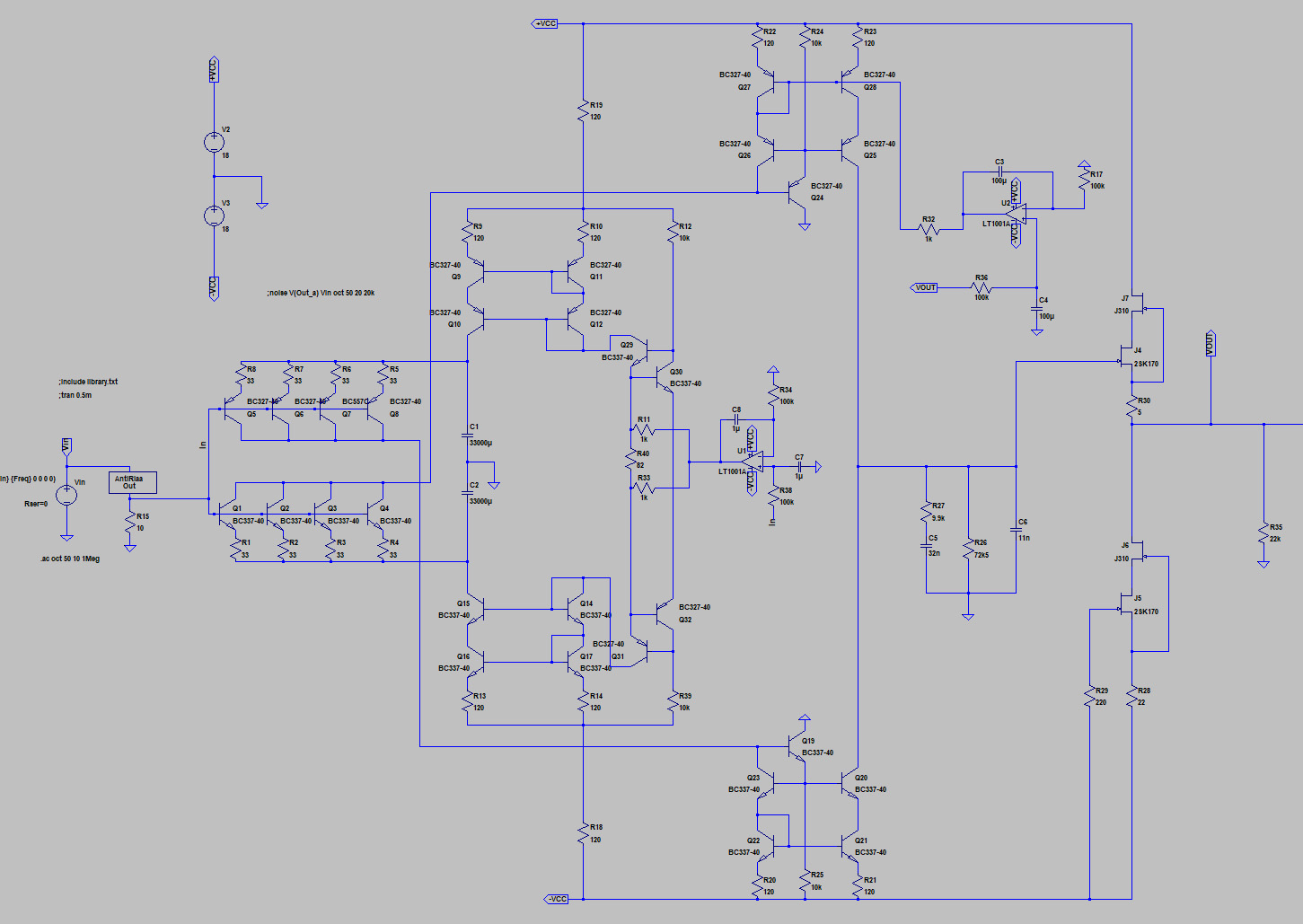

You are right, I didn't understand what you asked.I see you misunderstood my question... what I wondered about was the possibility to place an opamp on the paradise IPS so to null the current flowing in the cart.
I was not asking how to mod the IPS of the paradise.
As a matter of fact , the meaning of IPS is still a mystery to me.
But since the paradise is openloop, you can separately put a servo on the input and the output.
See the example below.
DC input voltage is 3uV and DC output voltage is 16uV.
And that even with transistor Q7 being of a different type, whatever the reason may be.

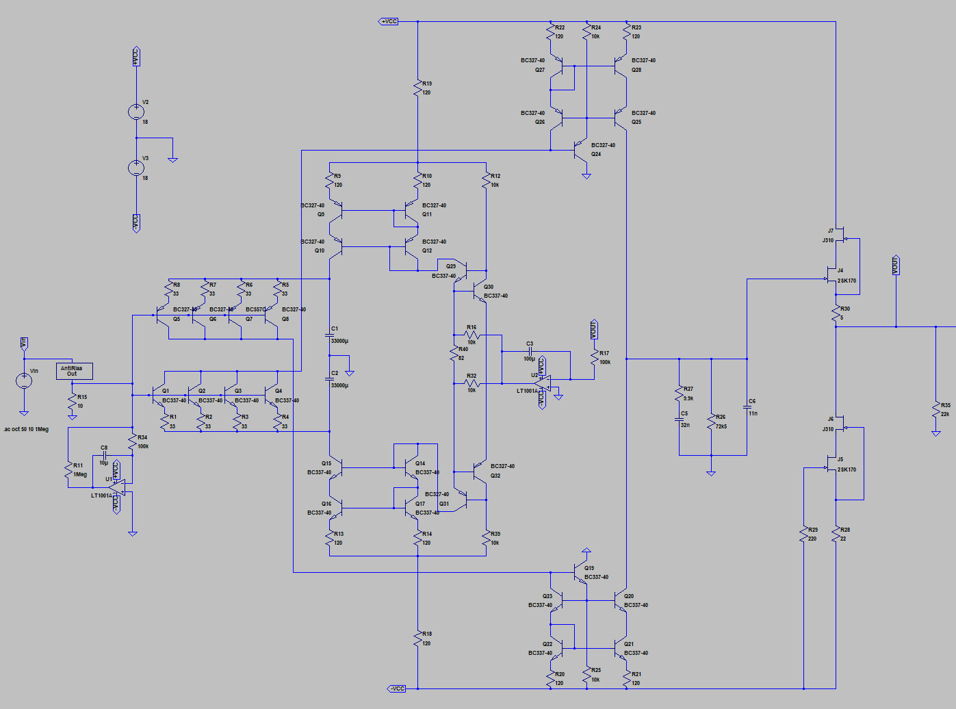

Ricardo,
Here is a much better solution.
Current through the input pair remains the same for both sides as in the original design, and only a current is injected at the input to compensate for the Hfe differences of the various resistors.
Input offset voltage is now below 6 uV.
To control the output offset voltage, the originally existing mechanism has been used.
So in effect the three resistors at the input have been replaced by a simple servo, doing a much better job, that's all.
Hans

In Put Stage. You could always null the input current after warm up once and hope that it does not drift much over time.
Thank you... that was what I was asking about relative to the original Paradise.
I left Q7 different because I wanted to see if I could mimic an input current due to different hfe between transistors. It must be a bc327-40 for the final sch.
And yes IPS (Input stage)

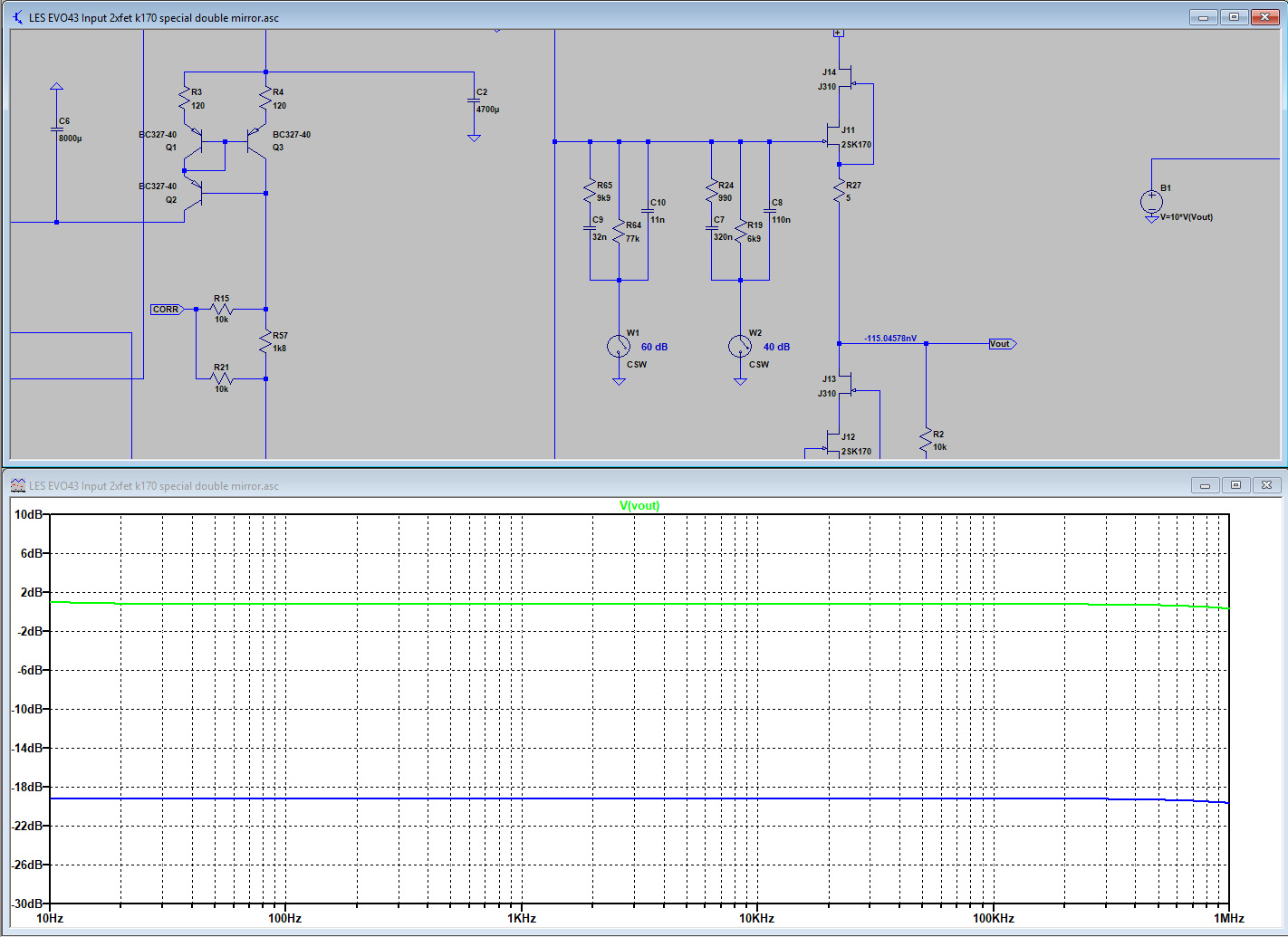

First of all, your so called "reincarnation" does a wonderfull job for MC with exceptional low input noise.Now back to the incarnation.... do you believe I could use your head amp before the jfet MM version so I can have a phono compatible with MM and MC ?

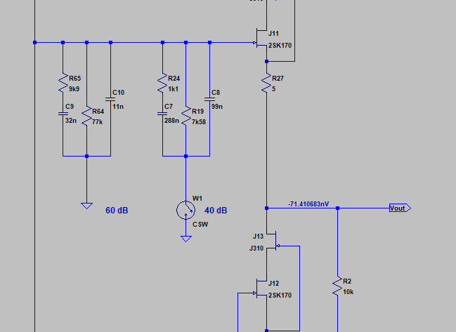

Since overall gain is only determined by four components in the Riaa network, I would opt for using two Riaa networks, one giving 60dB and the other giving 40dB overall gain, by switching between one of both to Gnd,
This will give you by far the easiest and most elegant way to have both options available.
Using an extra head amp as proposed in this thread will be theoretically possible, but this design is differential in/ differential out, so you will also have to add a differential to SE converter, making things a lot more complicated as the solution proposed above with your "reincarnation".
Hans

Green 61dB for MC, Blue 41 dB gain for MM.
Hans
The solution is not that complex, see below.Thank you so much Hans... now I must add a circuit that enables switching without causing noises in the output.
The 60 dB network can stay connected to earth all time.
The second network, resulting in 40dB, should be switched in parallel when using MM.
I don't think that much drama will happen when switching.
Hans
