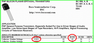

Hi Carlos,
I was just looking through the "substitute transistor" list and was wondering about the input transistors. With the standard rail voltage of plus and minus 35 volts, which transistors are suitable.
Is Vceo > rail voltage the criteria?
Does your simulation show the actual voltage across c and e of Q1 and Q2?

Emitters are near zero volt...and colector is -36 Vdc
Yes...Vce bigger than the rail will be enougth...better beeing twice the rail...to enter linear region.
So.... the transistor will hold a rail voltage, not from rail to rail.
Vce max beeing under that voltage will work fine there... the one that hold all voltage swing is the voltage amplifier.
The current swing in those input ones is very small..and voltage is also very small there.... as a consequence, power is small too.
The rail voltage more half the voltage swing (1.2 volts) will fit... (read Eva)
I think that all transistor suggested will work fine, and many of those were tested in my prototype....no problems Greg.
Selecting transistors that can hold twice the voltage you will have in your circuit, probably will fit, as the linear region use to be not so far away related half of max Vce.
Gain is very important for those ones...but even beeing this way..i could have very good results replacing 400 of gain to 120 of gain... even the colector load did not need adjustment.
Have you found something strange?.... go ahead....
Read Eva.... "Eva es la mejor"

Re: Emitters are near zero volt...and colector is -36 Vdc
Thanks Carlos,
No I haven't found anything. I was just looking at the wide range of Vceo in the substitute list and noting the lead orientation. Some will fit the same way as the 2N5401, some rotated and other will need 2 of their leads twisted.
