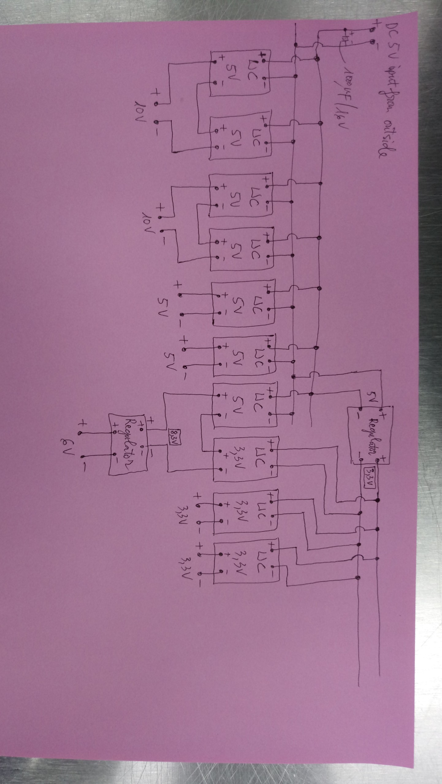

Hi Ian,
Me and one my friend we are struggling to understand how to properly use the universal uCaps to power up my DAC.
The idea is to have an external linear or switching PSU at 5V that will power up a set of your uCap circuit to have the following voltages:
- 2 x 10V 400mA for the analogic side
- 2 x 3.3V 100mA for the digital side
- 1 x 5V 100mA for the motherboard
- 1 x 5V 500mA for the EDEL NMR renderer
- 1 x 6V 200mA for the display
I attached here a schematic with the solution that based on what we understand from the datasheet we are supposing it's working.
Any though and suggestion are welcome
Thanks and Regards,
Enrico

Hi Enrico,
Your schematic shows that you shorted all the input together.
UcCoditioners need independent/isolated DC input if they don't share ground at negative output.
Ian
