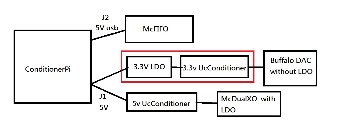

You can refer to the plan I mentioned earlier that ConditionerPi’s 5VDC to charge the ultra capacitors on other UcConditioners.
Among the chips that stably output 1A current, the LT1963A is the best in performance. LT1963A is less heat generation and can charge the ultra capacitor stably for a long time. The LT3045 has a relatively high heat so four LT3045 in parallel to output a stable 1A current.
@Ian,
The 3.3V output current of the ConditionerPi is still based on the current characteristics of the external LDO board, but the 5V output current is dependent on ultra capacitors, is that right?
If so, when I need 3.3V power supply to charge 3.3v UcConditioner, should not be installed 3.3v LDO board on the ConditionerPi, because the space is too narrow and heat dissipation is problems. When you need to charge 3.3v UcConditioner, you should use 3.3v LDO board in other space with better heat dissipation and get 5VDC power from ConditionerPi. If the power supplies of all digital circuit board, such as Buffalo DAC, McDualXO or McFIFO, come from 5VDC ConditionerPi, shouldn’t the burden be too great? I mean that ConditionerPi’s 5VDC to charge the ultra capacitors on other UcConditioners, the burden should not be too great? After all, UcConditioner has a current limit function.
The power quality of the 3.3v LDO board, which is the existence of LDO, on ConditionerPi should not be as good as 3.3v UcConditioner, so I don’t quite understand what can be done by installing 3.3v LDO board on ConditionerPi? Most digital circuit boards have built-in LDOs, so the required power supply is 5V, not 3.3V.
I'm a bit confusing about your questions. Please just let me know what's your configuration and then I'll let you know if it is possible.
