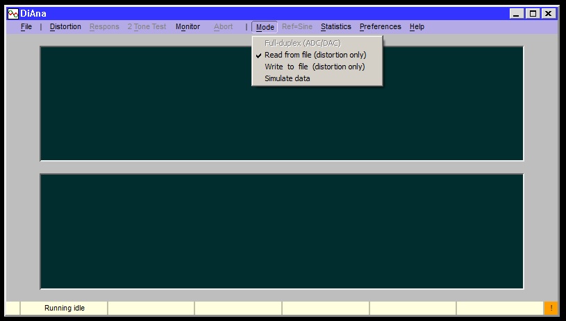

however the software does not work for me!- user interface requires work as well as error message
What kind of error msg. Does it show an error code?
Cheers, E.
I'm trying to reproduce this error, but till now to no avail.
When you get "Warning - Set Mode to Read from ADC", where and when exactly was it in the Preference form? Perhaps the "Sound Card" page?
Maybe it helps when you delete the DiAnaDemo-xx.ini file and start all over again. Set mode to "Read from file (....) first, and then initialize the sound card under Preferences->Sound Card.
BTW, I couldn't find the text "Warning - Set Mode to Read from ADC" in my source listings. Are you sure it was exactly this error msg?
edit: I finally found the error msg. It was: "Warning: Set mode to 'Read from ADC' first". Now I can dig further in the listings and find out why it went wrong.
Out of curiosity: What happened if you set Mode to "Simulate data" and then run distortion?
Cheers, E.
NB: Which sound card do you have and is the ASIO driver fully functional?

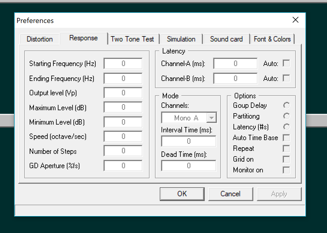

One needs step by step manual to run just Loop back test for this application. Also needs explanation of various options in Preference window. I do not find its functioning easy as it hangs or does nothing, even when you press the OK button. I tried this with RTX 6001 . If you can showcase an user friendly Loop back test to setup a Sound card, it will help. I find it difficult to use this application at this point without clear user manual.
Sure, I'm well aware that a user manual is badly needed. But the difficulty is that that I don't see the wood for the trees any longer, so to speak, as I'm involved with this project for a long time. So to me everything is clear and obvious. Not so with someone who is new to this application. But which parameters are not clear? I don't know. Therefore, it would be very helpful if other people told me that.

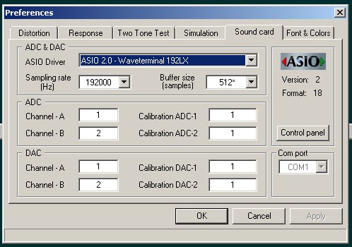

Going back to the 1st warning msg, did you get it when you clicked on the "Control panel" button in the Sound card menu? If so, forget this button for the moment. Also ignore that warning. Most important is that you can select the sampling rate and buffer size. The rest of parameters comes later. If the sound card initialization succeeded, you should see something like the picture below.

As for the rest of the sound card parameters: Channel A and B are the two stereo channels of the analyzer, while the figures in the edit boxes are the corresponding channel numbers of the sound card. Remember that sound cards can have more than just two channels.
Then we have the calibration factors. When just 1, a full scale ADC input respectively a full scale DAC output is represented by a value of 1.0. But maybe you want calibrate the ADC and DAC in such a way that the numerical values as shown by the analyzer are voltages instead of FS values. Needless to say that you will need a voltmeter to fill in the correct calibration values.
Regarding that pesky "Warning: Set mode to 'Read from ADC' first" once again, probably it is a bug in the demo version and should be: "ASIO control panel not supported". In the coming days I will correct this erroneous warning. Note that with most sound cards you don't need this control panel at all, except, for example, Xonar Essence cards to set the bit depth. Also note that the buffer size in the ASIO control panel will be overruled by the value as specified in the preference page. Perhaps I should disable this panel when no Xonar Essence card is detected.

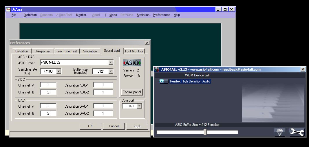

ASIO4ALL
Hi Dimitri,
Yes, it works also with ASIO4ALL (at least on my PC and on the one of my GF, using the on board sound thingy), though initialization might be a bit tricky and fickle. So don't get desperate when it doesn't run immediately during a first try.

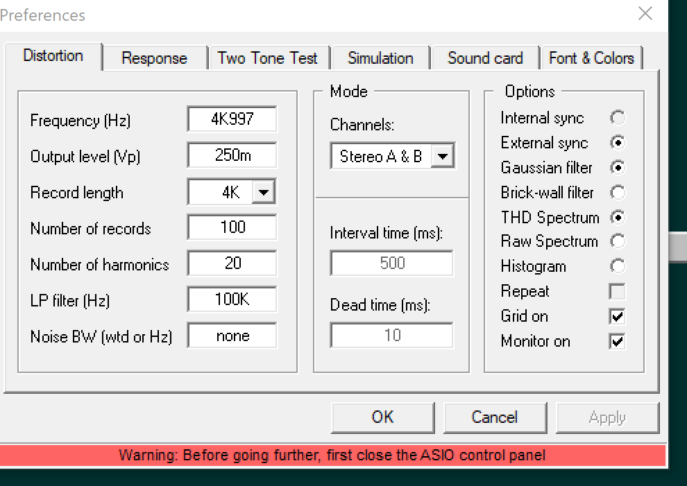

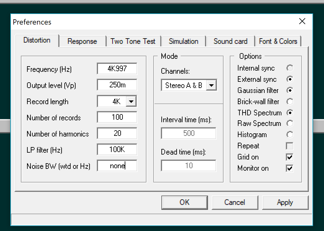

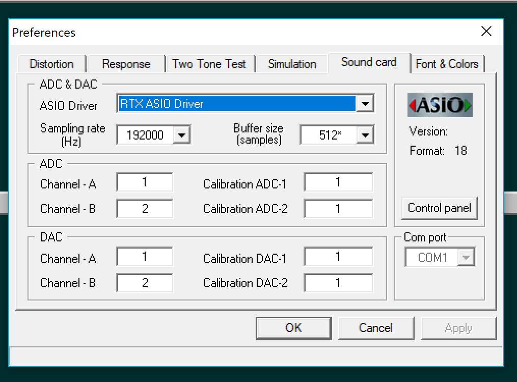

same issue - RTX 6001 uses Asio control panel - does not initialize ADC. error 108 - also new warning Close Asio control panel!

Hi Edmond,
A few hints to get started:
First set Mode to "Read from ADC (...)"
Then initialize the sound card, go to 'Preferences' -> 'Sound Card'
It looks that internal sound card is recognized by ASIO4all but where is "Read from ADC"?
Thank you
Hi kannan,
I'm afraid the ASIO control panel (ACP) is making troubles again. You pushed that button again, didn't you?
This ACP is really a PITA, as every sound card provider implements it differently, because the specification from Steinberg for this item is rather vague. As a result, there exist no full proof method to determine whether the ACP has been closed (by clicking on the "OK" button inside the ACP window). Apparently, DiAna fails in this respect and sends a warning. But don't blame me. It is a serious omission in the ASIO specifications and not a bug in DiAna, or should I call it a "blameless bug"? 😉
Anyhow DiAna needs to know the state of the ACP, otherwise, when you start an analysis, while the ACP is still open, it might crash.
Of course I could have prevented all these troubles if I had an RTX6001 to my disposal and test the software before "going public", but I missed the deadline to order one.
So, if you haven't give up yet, would you try to initialize the RTX6001 again, but now without touching that pesky ACP button at any time?
In the meantime I've disabled (grayed) the ACP button. However, if you really need it, you can enable it again by setting "AcpEnable" parameter in the ini file to a non zero value.
Cheers, E.
edit: Could you upload a picture of the ACP?
