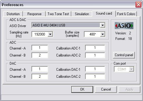

I tried on Windows XP-32bit and follow the steps of link DiAna
Unfortunately, just I press the Distortion button "Click on the 'Distortion' button to start the ADC", I have "error ADC not initilalized, error code 108".
I deleted the configuration file and tried from begging but I have the same error again!
On preferences I have the EMU0404.
Any suggestion?
Any suggestion?
@lemon, What are the following values in the ini file for: NoADC, SampleRate and AsioBufLen? If NoADC is non zero or SampleRate is zero or AsioBufLen is zero, you will get this error msg.
Did you hit the control panel button?
PS: The sound card preference page looks OK.
edit: Did you hit the control panel button?
The sound card preference page looks okay.

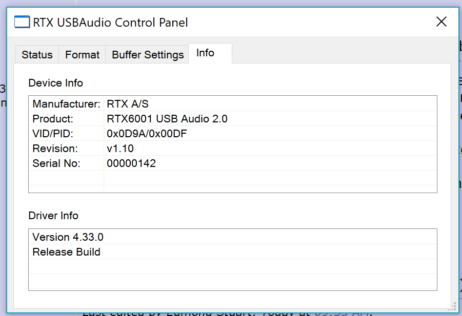

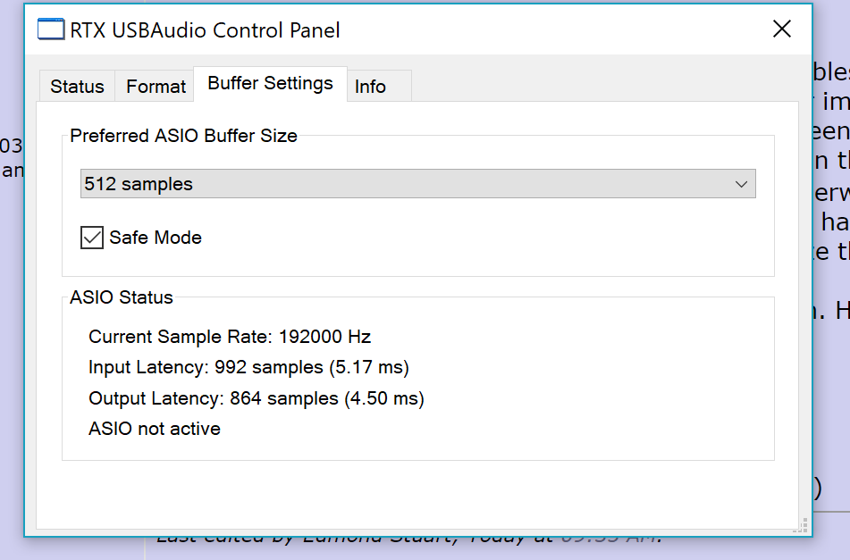

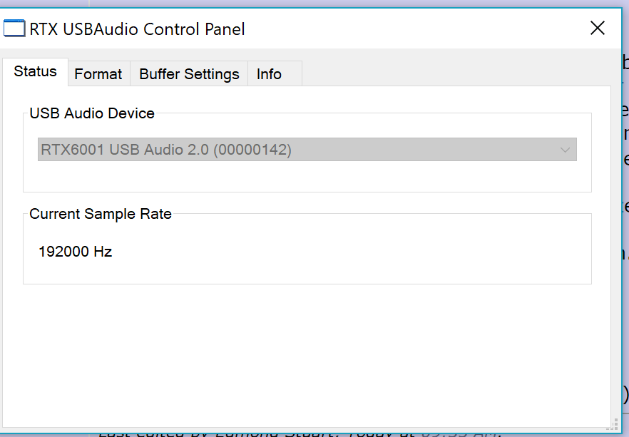

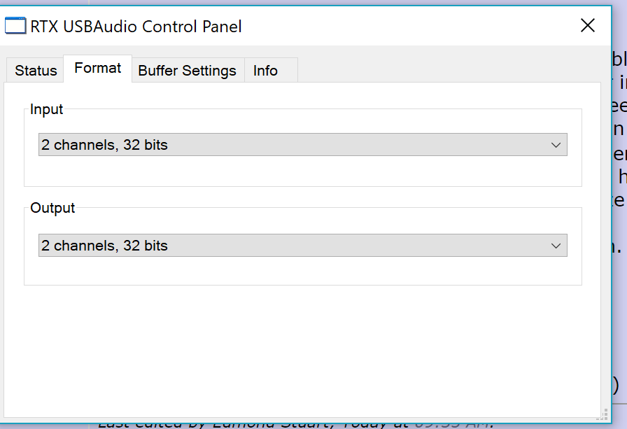

Hi kannan,
I'm afraid the ASIO control panel (ACP) is making troubles again. <snip>
Cheers, E.
edit: Could you upload a picture of the ACP?
here it is - pictures and ini

Great ! How you did it? Did you modify the ini file manually?Yes all had wrong values (NoADC=-2, SampleRate=0, AsioBufLen=0)
Now, it is working.
I suppose it works, but you have to supply the correct figures by yourself.The calibration works? I didn't at Preferences Menu.
Do you know the full scale voltages of the ADC and DAC?
I changed manually the NoADC=0 and SampleRate=48000 and run the DiAna.
I took an error that I did't note, close the program, run again and works (choose the Replace...something in memory).

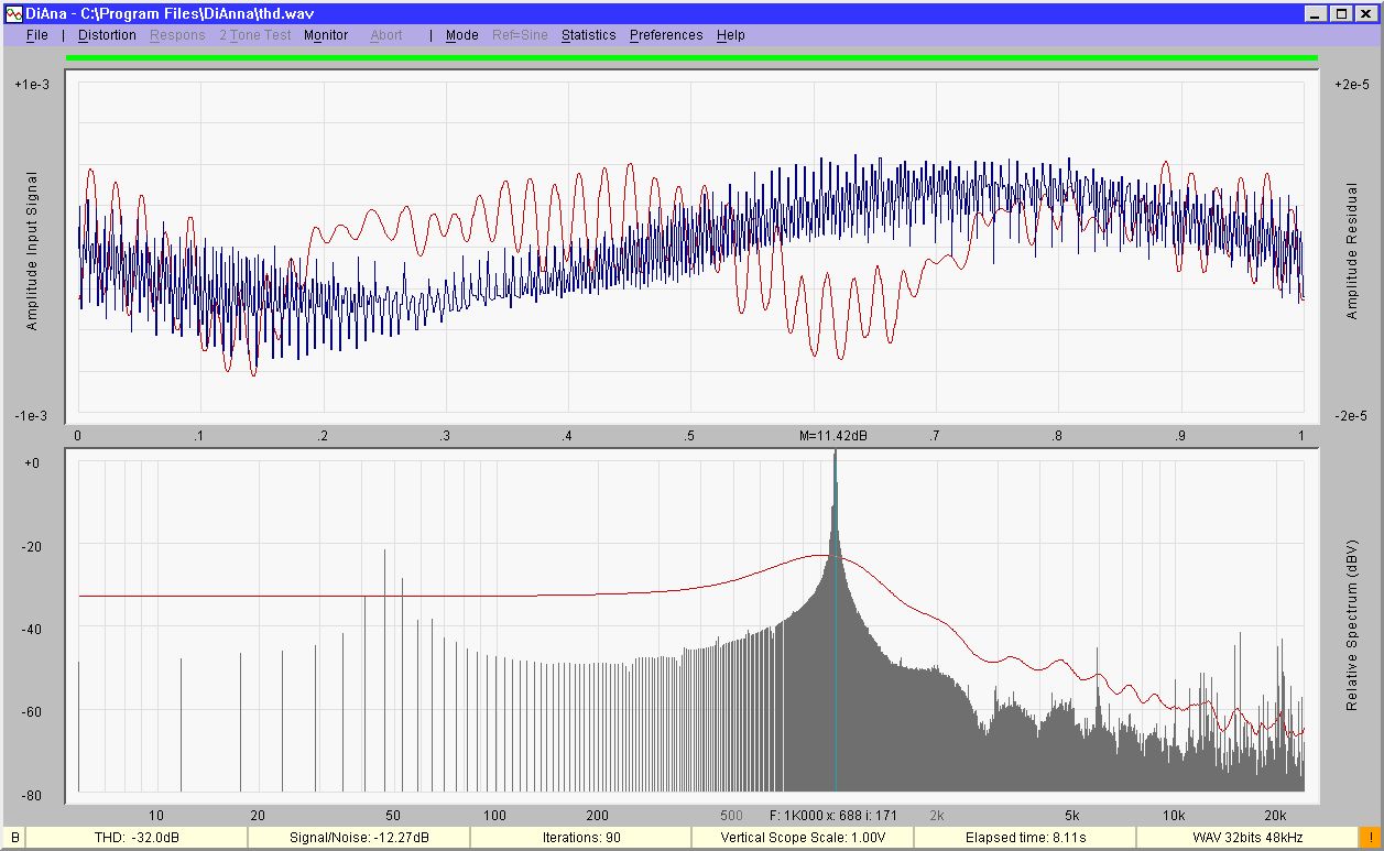

I don't know if the following method is good but I have done these steps for the input calibration.
I set the Output Level to 1 (what is that finally, rms, average or peak to peak).
Run the generator pressing the distortion, I set the volume EMU output until to read 1Vrms at EMU input.
Finally, the DiAna gives -11.66dB the level of basic frequency that it is very closed to the real value, I think.

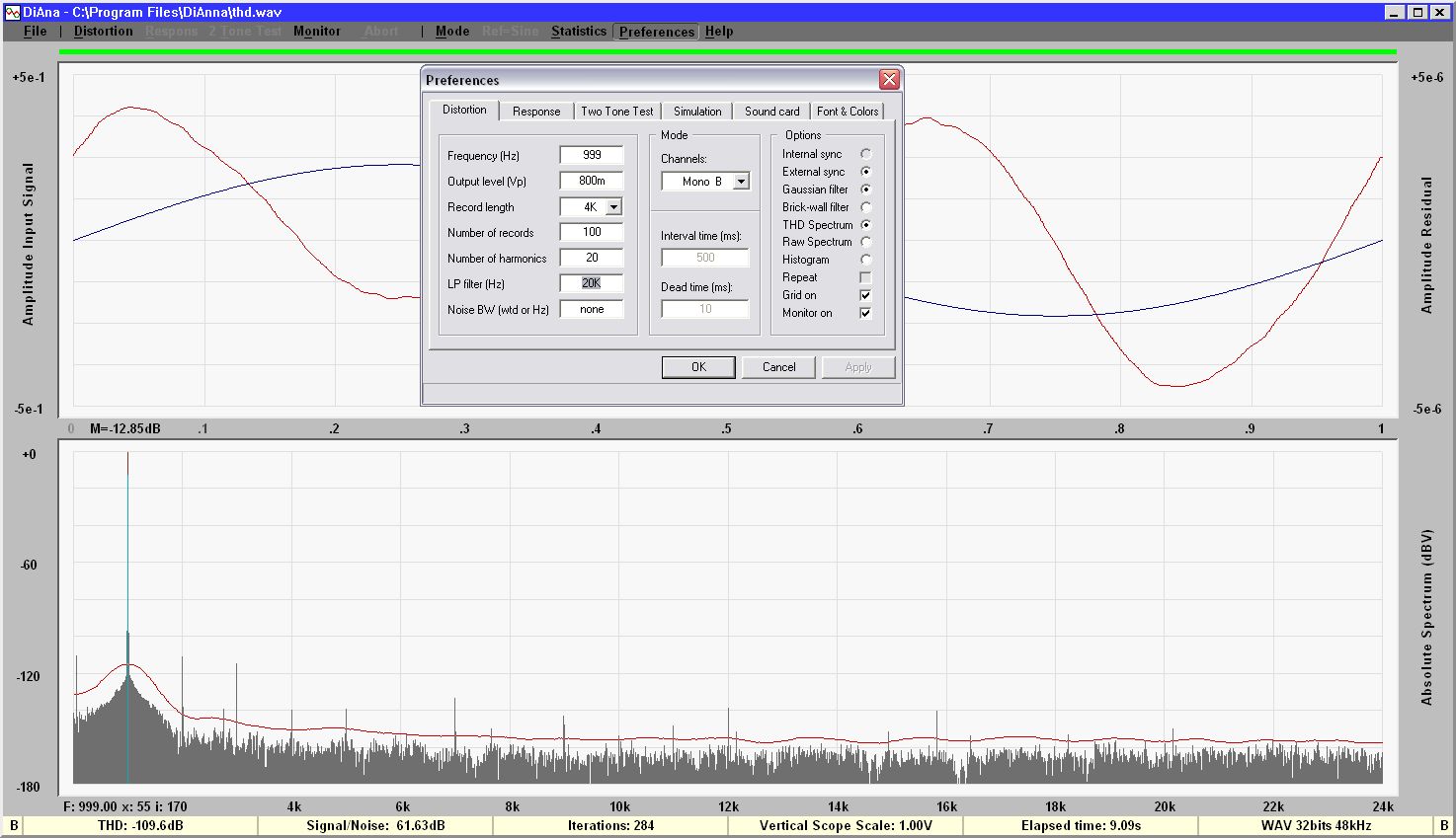

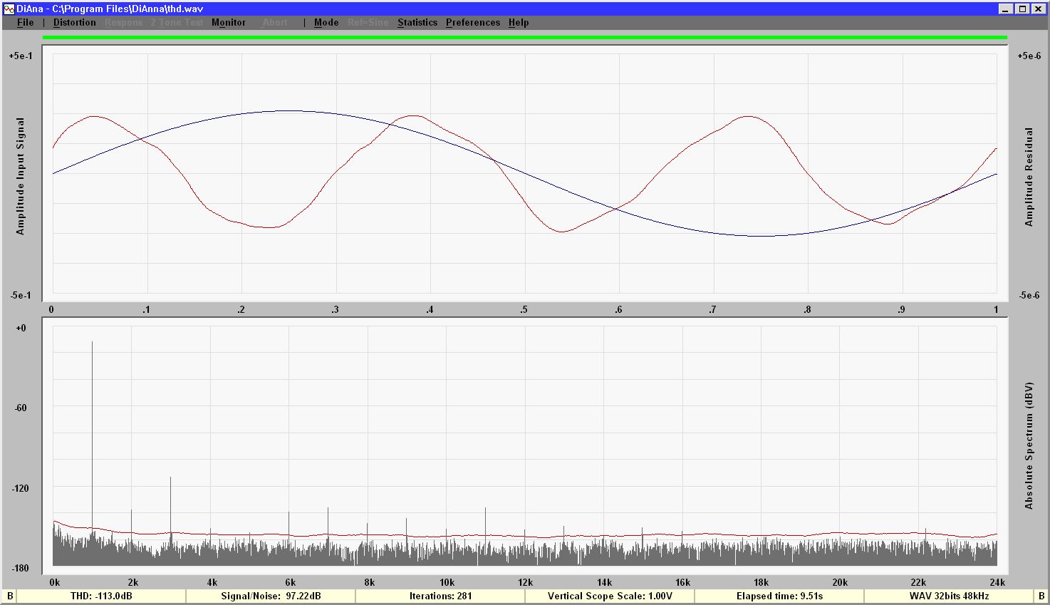

With a calibration factor of just 1 , the "voltages" as shown are no real voltages, instead, they are fractions of the full scale value.From what I saw, at the Preferences->Distortion, the Output Level is the gen. output level in Vpp.
At my capture this set to 800mVpp, but when read distortion the Amplitude is 0.23V, how are these correlated?
Is that way to adapt the FFT values?
So, during capture 800mVp (it's not mVpp) means that the DAC peak signal is 0.8 of full scale (FS). At the same time this signal is fed to the ADC, but apparently the FS voltage is about three time higher, more precisely 0.8/0.23= 3.478 times higher. That's weird, as the specs of the emu card say that the levels of both line input and line output are +12dB. Is there perhaps a mixer with faders who aren't put in the highest position?
