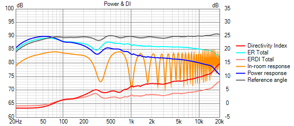

Included in the research that Olive presents are the preferred in-room (e.g. steady-stage) response curves for a variety of listener types and loudspeakers, all on one plot. This paper is not easy to get, so instead I suggest that anyone interested download this other paper by Toole in which he cites that work and presents the same data along with some other related info in Figure 14:
Please download the article, see Figure 14, and read the accompanying text in section 4.1. The preferred responses all show an increase around ~100Hz of between 3dB and 6dB. This "bass bump" is what the listeners preferred in the steady-state in room response.
I relate the data of Figure 14 to OB/dipole systems in the following way:
A true dipole system has constant directivity, and therefore also has a constant power response.
The in-room steady-state response reported by Olive and Toole will be very similar to the power response of the loudspeaker and is not flat!
This is the same result you see time and time again from Klippel testing of loudspeaker e.g. see Erins Audio Corner, reported as the estimated in-room response.
Therefore some equalization/correction of the dipole should be made to better mimic this response. Above 100Hz I do this via EQ of the input signal to "tilt" it down.
Below 100Hz we can obtain the "bass bump" for free just by crossing over to a monopole. This is because a monopole radiates 4.75dB more power into the room than a dipole for the same on-axis SPL.
So I just cross over around 80Hz to a sealed sub. The power response will naturally rise through the crossover point by almost 5dB, exactly like the preferred listening curves from Olive. The monopole sub can also deliver a better low bass response and room pressurization at very low frequency.
This also greatly reduces the demand on the dipole woofer, which now only needs to work well down to 80Hz. By reducing the LF requirements the dipole loudspeaker can be made physically smaller, or use a smaller woofer(s), etc.

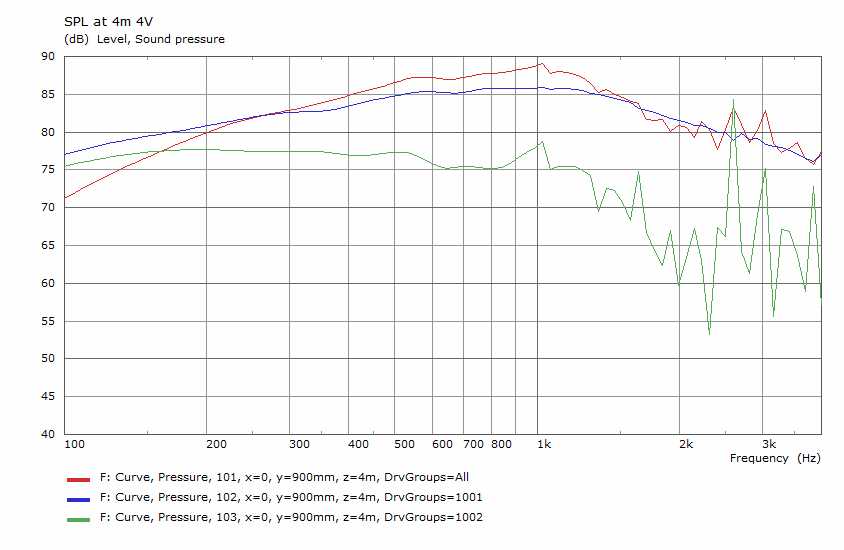

In terms of comprehending the relationships between all the variables - that is what simulation is for. To tell the truth, my head is still spinning from all the variations I've run trying to optimize the 5208's response and it will take me a little time for me to sort it out.
A nude coax is little different that a coax on a small or narrow baffle. The OD of the driver's frame defines the minimum baffle. My narrow baffle is less than 50% larger in width than that minimum diameter. Its just a question of degree; EQ can deal with it. The max SPL is a little bit lower, the frequency range over which you get the desired directivity extends a bit higher. The choice has more to do with aesthetics or preferred construction methodology than anything else.I seem to be a slow study on this aspect. With the nude coax, would you be able to EQ out the frequency response, possibly with a shift of XO to the woofer if needed (and possible)?

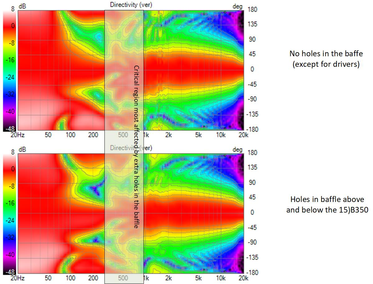

My very first attempts had very little baffle across the top of the coax driver. I found I needed to provide more space between the rim of the driver and the top edge of the baffle to prevent the vertical dipole null from being tilted forward. In my latest iteration, 36 mm seems to work. The prior art that I reviewed that had zero baffle around the entire top half of its coax driver seems like a bad idea from this perspective.
In a conventional baffle with no extra holes, no dipole cancellation can occur on the floor side of drivers. With the holes in the baffle I showed earlier the vertical directivity is definitely improved by holes to allow that cancellation. The attached drawing shows the difference. The differences aren't great and I am able to equalize them away in the system simulation but I had to work harder on the manual equalization for the no holes in baffle version. The end result was just as good until the 2nd decimal place of Vituix's preference rating.

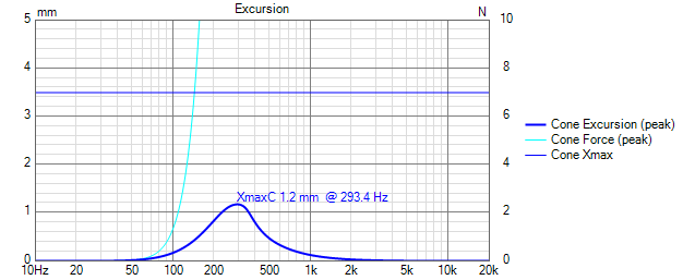

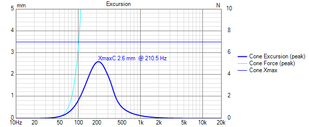

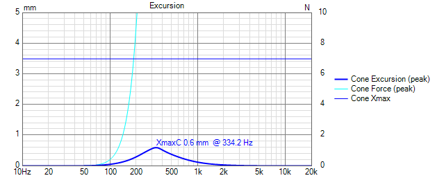

My latest sims give a good idea of how low the 5208 can reach with the narrow baffle I'm providing it. The answer of course depends on how loud you want to play. The SPL is only 6 db lower at 100 Hz than at 400 Hz .

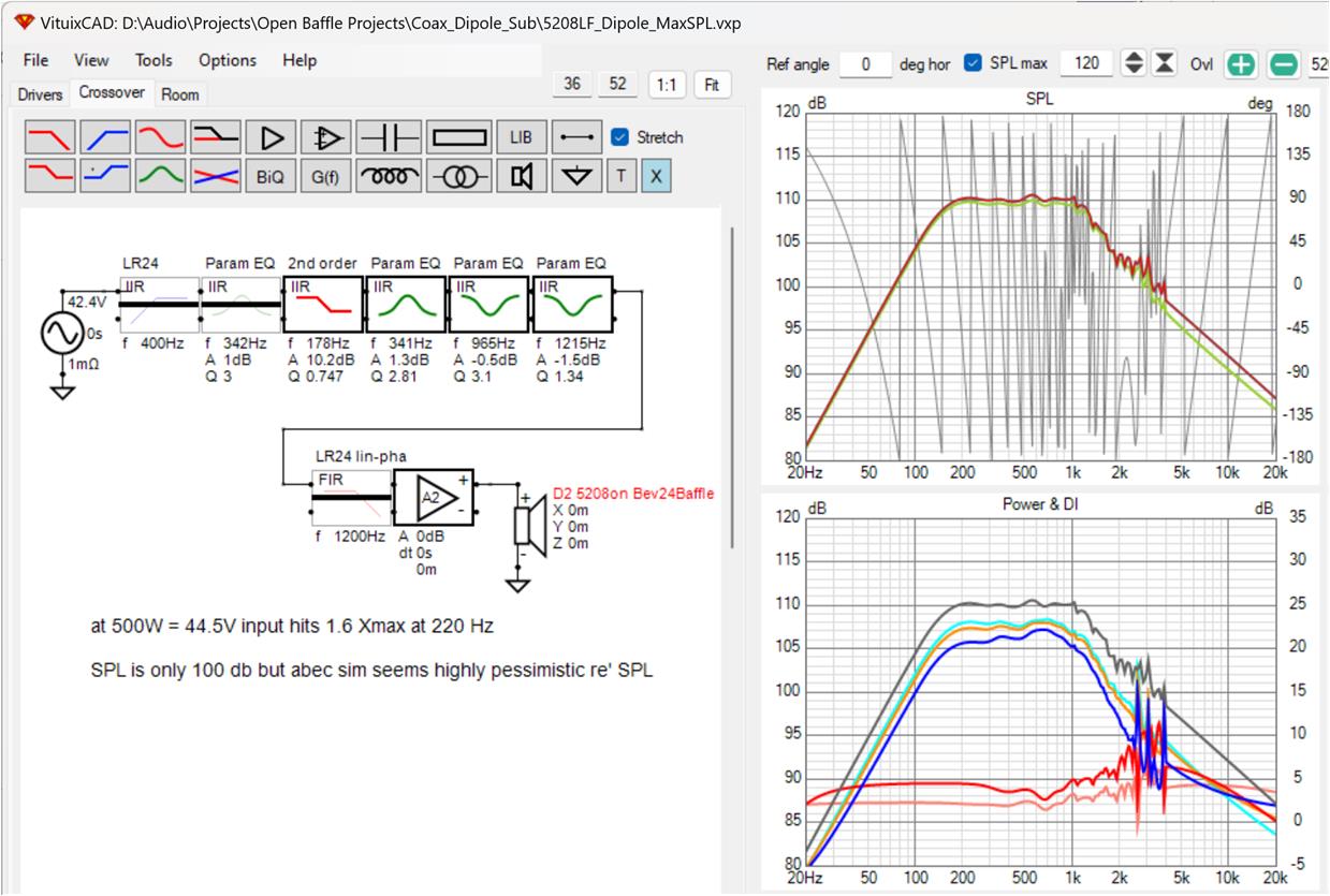

Those are the SPL levels at 2.83V pk, 1m. We need to look at excursion and driver power limits before reaching a conclusion.

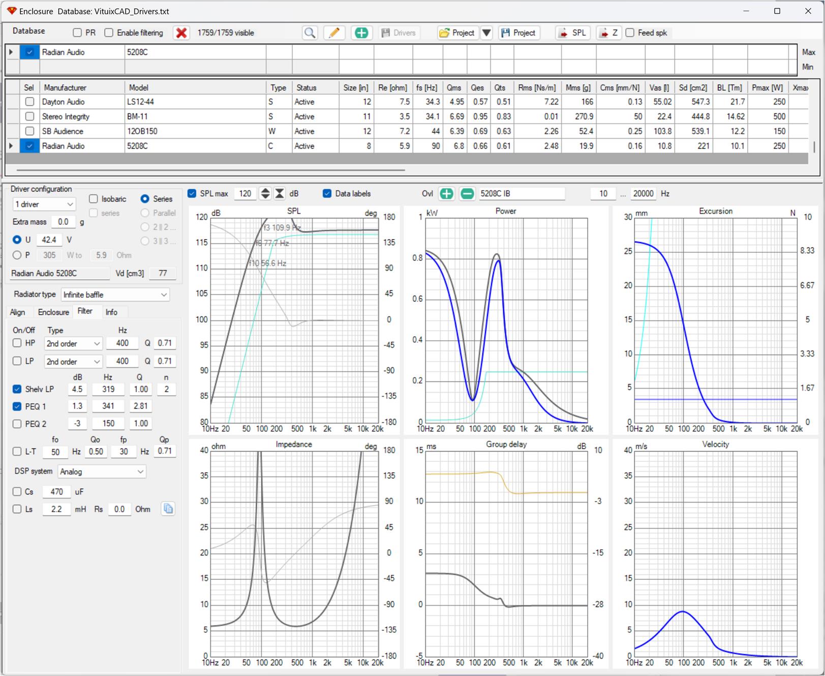

I next created a simulation in which I equalized the 5208 for an XO at 100 hz with the source cranked up to 110 db SPL
I then opened a Vituix Enclosure simulation of the 5208 and transferred the filters and source voltage from the above simulation to the enclosure simulation.
The 5208 can't reach down to 100 Hz open baffle at such a high SPL. In the top right curve, you can see its crossing Xmax at around 270 Hz. We have to add a crossover high pass filter to see where the limit is. I next applied LR24 high pass filters at 200, 300, and 400 Hz. You can read the maximum excursions on the graphs.

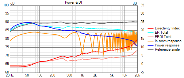

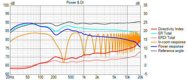

The XO is a tradoff between the range over which we have a point source and managing the depth of the floor reflection null. Center to center distance also matters and i'm pushing the limit at 400 Hz. The Vertical polar map shows a >20 degree vertical window so it should be OK.
Clearly this driver in OB, can be used down to 200 Hz. At 400 Hz, its not the least bit strained.
Here are the floor nulls for those crossover points. These are taken from my Vituix system simulation. Its EQed optimally for 400 Hz. I did no re-EQ for the other XO frequencies, should changed the high pass and low pass filter frequencies. The orange trace is the in-room response. What I mean by the floor null is the first dip in the orange trace. The remaining dips are comb filtering with the floor, which likely won't show up in an in-room measurement. The miniscule dip at 400 Hz speaks for itself.

first 200 Hz
300Hz
400Hz

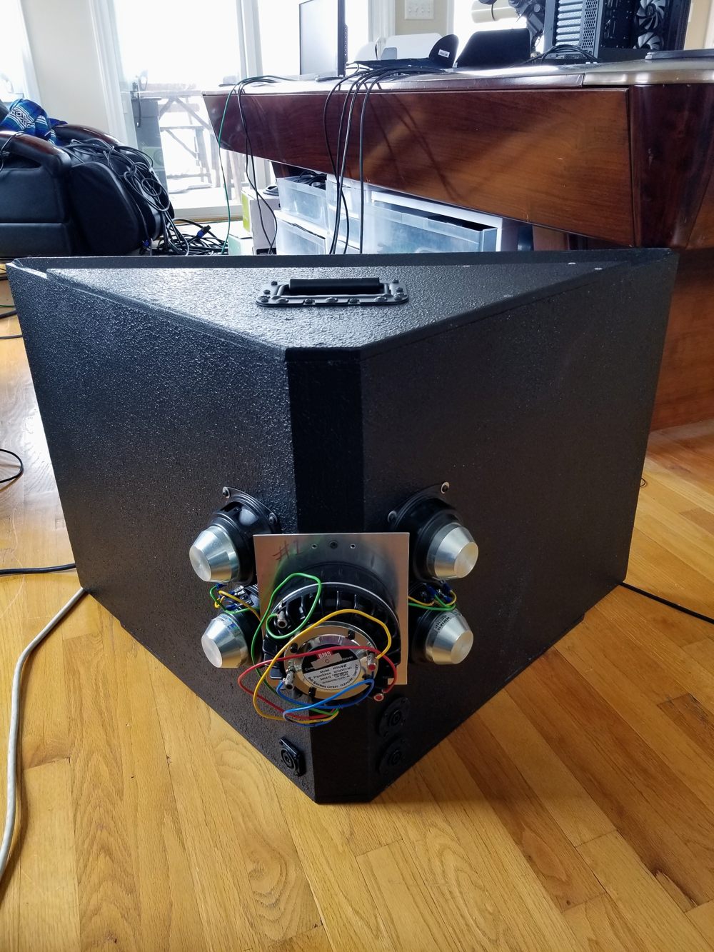

The OB posts have me thinking about an unusual project...a combination OB and unity/synergy.
One of my favorite builds, showing the back side is the is this guy.....
The four 4" mids are already "open baffle" in that they radiate backwards openly, albeit at a 45 degree angle. (horn is 90 degree H)
I'm thinking about putting two 15" drivers on the horn walls, butting up close to the mids, and being open back just like the mids.
What do you think?

Iirc, that large horn controls directives down to 300hz or so. If so, leaving the 4ndf34s open won't create dipole-like directivity. Might add some ambience but that should include HF. You probably could get a dipole effect from the 15s, plus save some weight. In a small horn, ob mids might well allow the directivity to be controlled to a lower frequency

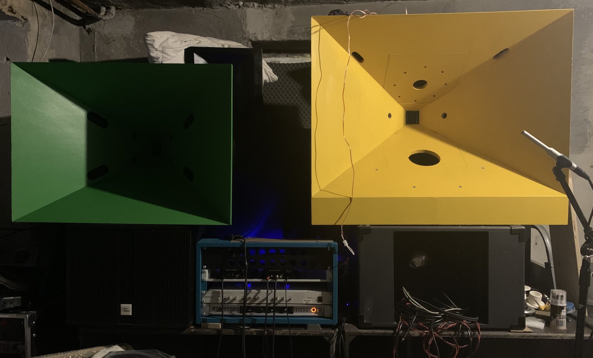

My two prototypes have open backs for mids and LF. Yellow one is 2x 3" and 1x18" at the bottom, the green one 4x 3" and 2x 12". It is because I was too lazy to build the box around them - and I quite like the open backs. Even the planar tweeter can be open backed. I would say there is added ambience due to the open backs. I also equalized the bottom end so both play down to 30 Hz at my home listening volume.

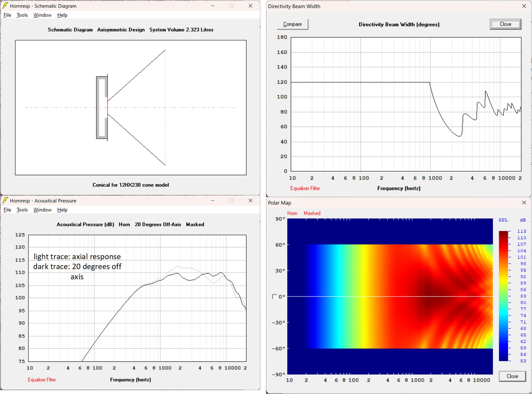

The question is whether or not perfect polars are necessary. Its not so much whether our ears can discriminate between the sounds of perfect/imperfect polars but whether or not differences are so great as to affect our enjoyment of the music. I do know that one can get the sound of a simple conical equalized quite enjoyably within a listening window. the more controlled the directivity, the wider that listening window can be.
polars of a simple, axisymmetric conical can be produced in HornResp quite easily and I just happen to have a model around. The DI has wild variations. Comparing on axis with 20 degrees off axis shows a 5db difference. This is a potential problem for me in this design as well because the coax's mid cone is a conical. Hopefully the baffle tames this to some extent and i can get something of a termination by rear mounting the driver on a thick baffle and beveling in front of the cone.
It would be interesting to see how much better that would be with a secondary flare; a question that ABEC should be able to answer.

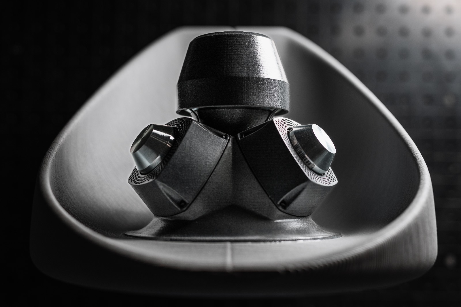

I wish I could replace the coax driver with a small ROSSE derived (ATH) synergy with open back mids. I'm still hoping that someone with more CAD and 3D printing skills than me will design one I can use.
