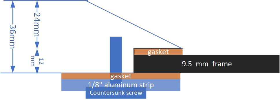

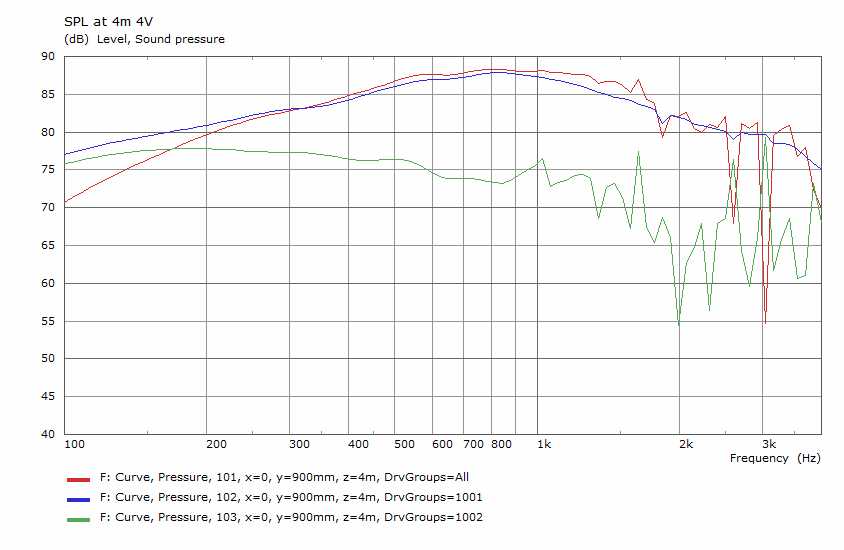

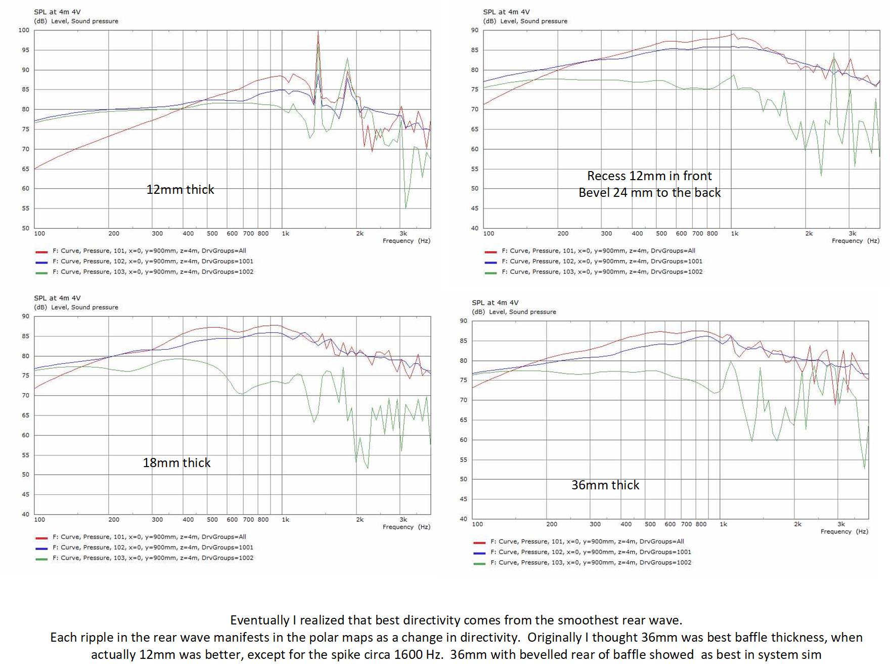

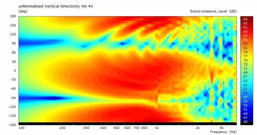

The issue of the baffle shape and thickness for my OB project still isn't resolved. I was concerned about the 5208 response circa 1 khz, where directivity changes for some as then unknown reason. This is how it looked in the system simulation post equalization:
so I ran a bunch of sims and compared results
The most telling trace is the (green) rear wave. Except for the spike around 1600 Hz, which is likely a simulation artifact. I'd say that the 12 mm result is the best. The upper right is for a front mounted driver recessed flush with a 45 degree backside bevel. Its almost as good as the 12 mm thick result and doesn't have the discontinuity at 1600 Hz.
The recess 12, bevel 24 on a 36mm baffle produced nice polars, the best so far:

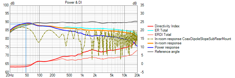

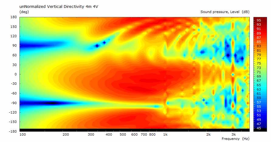

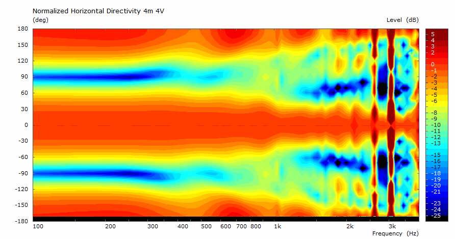

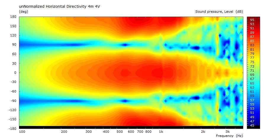

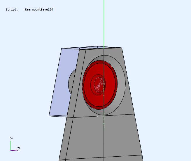

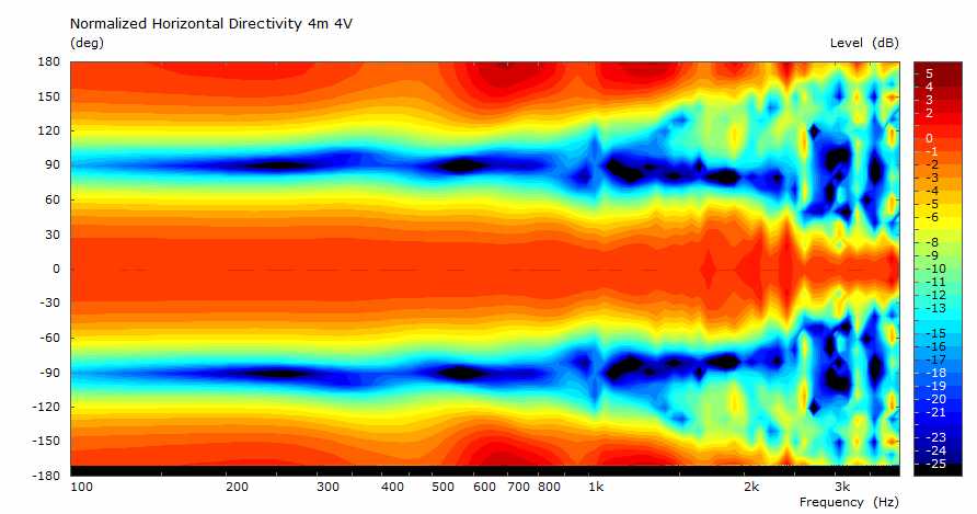

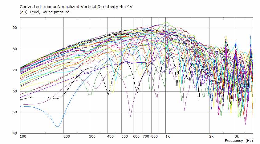

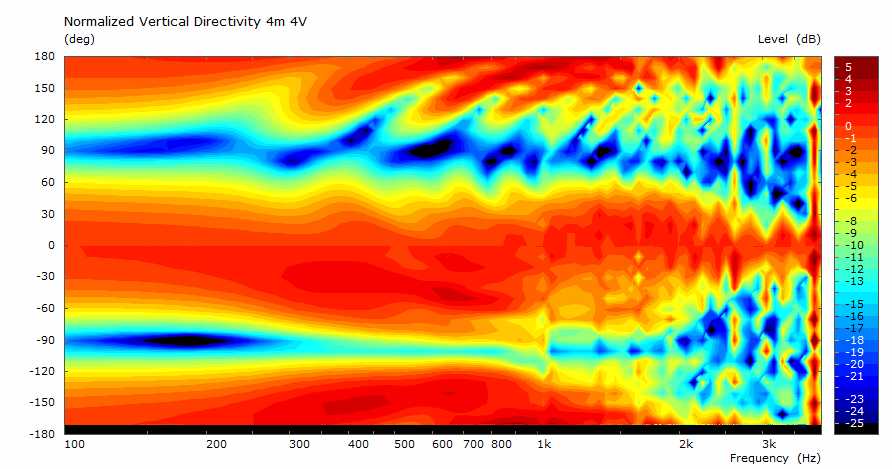

In light of last night's discussion, I just had to try mounting the driver flush on the rear of the baffle and then bevelling towards the front, which hopefully would provide a termination of sorts for the conical horn and further improve the results.
It only took a few minutes to rearrange the driver and bevel.
The SPL curve looks pretty much like the front mount/bevel rear SPL, except the rear wave trace slopes slightly downward towards HF:
The polar maps were a surprise in that the side nulls from 400 Hz up were not as deep
the decreased depth didn't prevent me from obtaining an pleasing smooth system simulation result but it does seem to have resulted in deeper boundary nulls (overlay trace below)
Rearmounting cleans up the front of the baffle and allows the driver to be isolated from it:
I like that but I would prefer not to lose the deep dipole side nulls so I have more work to do...

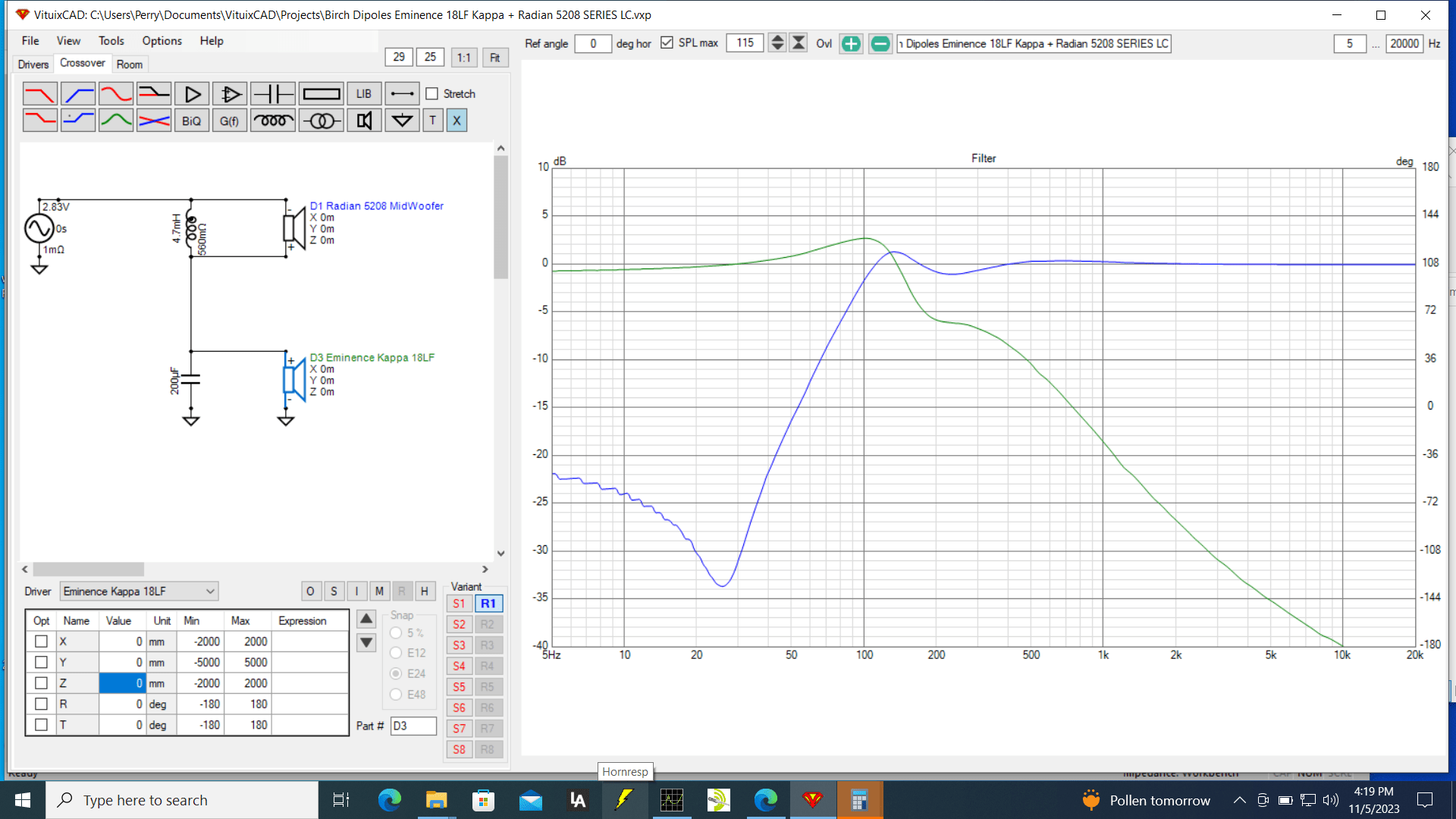

What is the advantage of coax over independent drivers such as the B&C 4NDF34s in a synergy?
live edge dipole 150hz crossover looks like thisCool to see the analysis. So, with @perrymarshall's Live Edge I believe he's crossing over at 200 Hz with a... hmmm, not sure which slope,
https://www.diyaudio.com/community/...ion-updated-design.405104/page-2#post-7500040
The only advantage is that you can buy one off the shelf, as opposed to DIYing a synergy. I expect that a well-done synergy would have better polars but I'm with Mark100 on whether that would make the music more enjoyable - not sure that it would.What is the advantage of coax over independent drivers such as the B&C 4NDF34s in a synergy?
and...What is the advantage of coax over independent drivers such as the B&C 4NDF34s in a synergy?
Ok, I was wondering why Danley uses a 1x5" coaxial in their SM-60M. I guess it's just the manufacturing advantage like you pointed out.
I think there is are pattern control & SPL & low freq extension goal differences, in a synergy that uses 4NDF34's, and one that uses a only a 1x5" coaxial.
Small mids like the B&C's are a bridge between a powerful CD, and large cones pulling low-mid /upper bass duty. Higher SPL design.
A 1x5" coax is going to limited by the 5" section, and isn't really aiming to be more than an excellent small box design.
Personally, i use small-mids like the 4NDF34's not so much for SPL, but because I think using them sounds better than asking a CD to span too many octaves.
Seems to me that taking a CD too low, diminishes the presumed benefit of going as low as possible. (some form of modulation distortion perhaps??)
Anyway, like mentioned earlier..I'm focused on musical enjoyment..pretty much 100%....so my takes may well be entirely my own.
I have no doubt 4 4NDF34's in a synergy of similar size could replace the coax driver here. Together they have about 10% more volume displacement than the coax's woofer.

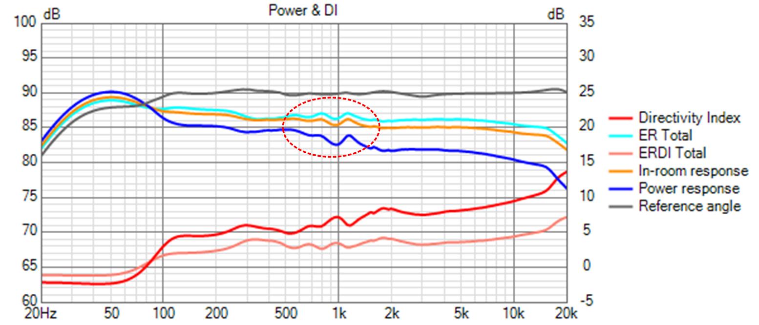

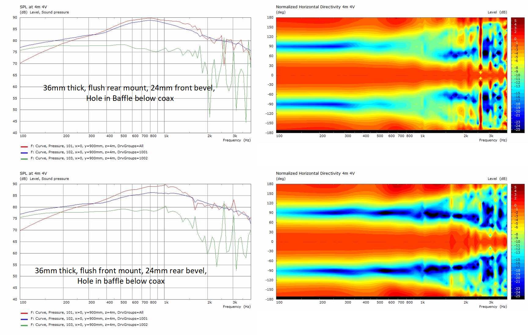

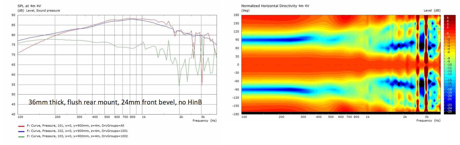

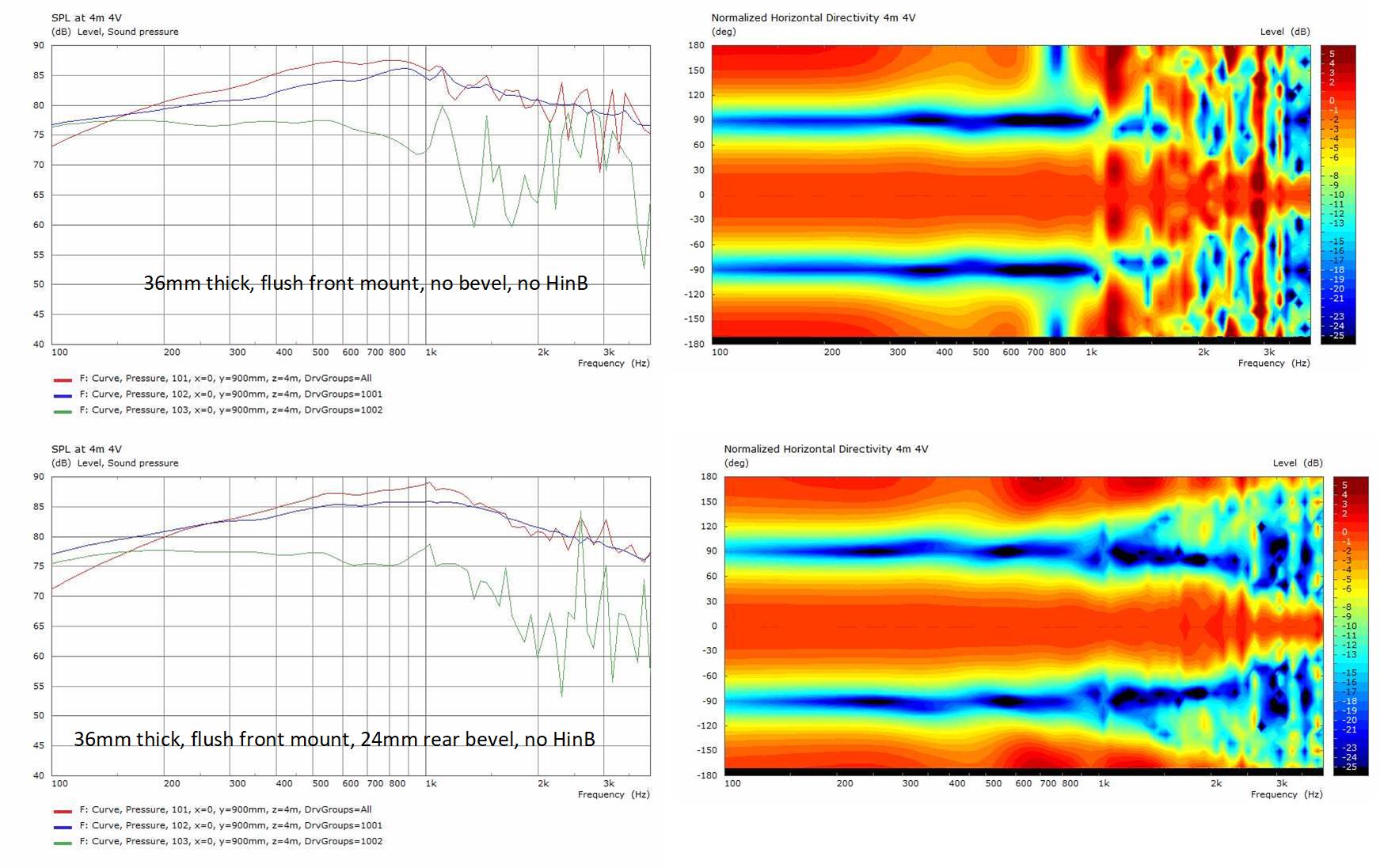

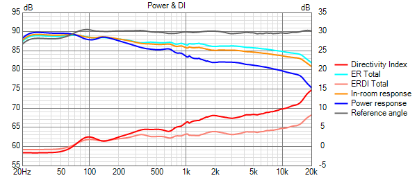

I'm still reviewing baffle thickness, front vs rear mount, bevel options for the coax.
The rear mount, front bevel version of post #163 gave me the smoothest response through the problematic 1 khz region that I've seen but compromised the directivity. I'm hypothesizing that the front bevel extended the directivity or reduced the diffraction so that less radiation found its way towards the back of the baffle to be canceled. My efforts to try different bevel angles thwarted by meshing difficulties. One of the frustrations with this method of ABEC is that it often gives up trying to produce a mesh, forcing you to try multiple MeshFrequency and EdgeLength specifications within the code to help it through the problematic detail. Eventually, one has to resort to CAD and/or external mesh software to produce the mesh (like ATH does).
Instead of that, I stepped back and took a close look at the work I had already done.
The 36 mm thick, flush front mount, no bevel, no HinB, has a nice extended composite response but some "jaggies" on the rear wave circa 1 khz that compromise the system response and introduce an off axis null near 800 Hz. Introducing a rear bevel cleaned up most of this but there were still issues near 1 Khz, albeit reduced.
The SPL graph of a flush rear mount, front bevel version is smoother but has the same issues near 1 khz as well as compromised directivity, as discussed earlier

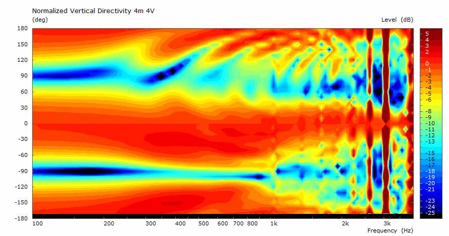

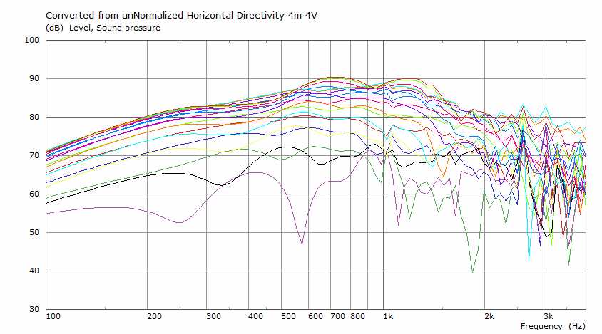

The issue around 1 Khz seemed to have something to do with the vertical response. I wondered if re-introducing a HinB below the coax would help.
It helped a little bit. The green trace ramp from 750 Hz to 1100 Hz is perhaps 30% less tall. Except for that ramp, the green rear radiation trace is quite flat.
That is worth looking at in the Vituix system simulation.
The preference score using equation 1 is 9.46 and using equation 3 is 9.85. The linearity is 1 db.
The 100 hz to 1.2 khz is as good as one could want. Its misleading smooth above the 1200 Hz XO because the directivity there isn't based on the woofer's cone shape or the unknown tweeter throat shape. PerryMarshall's work shows us what to expect there.

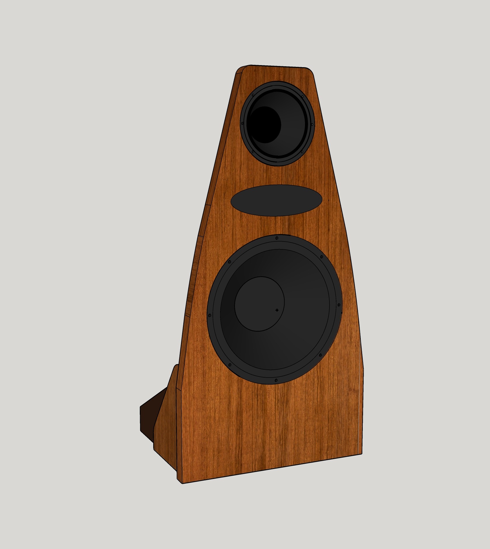

This is what it could look like rendered in Jatoba/Brazilian cherry:

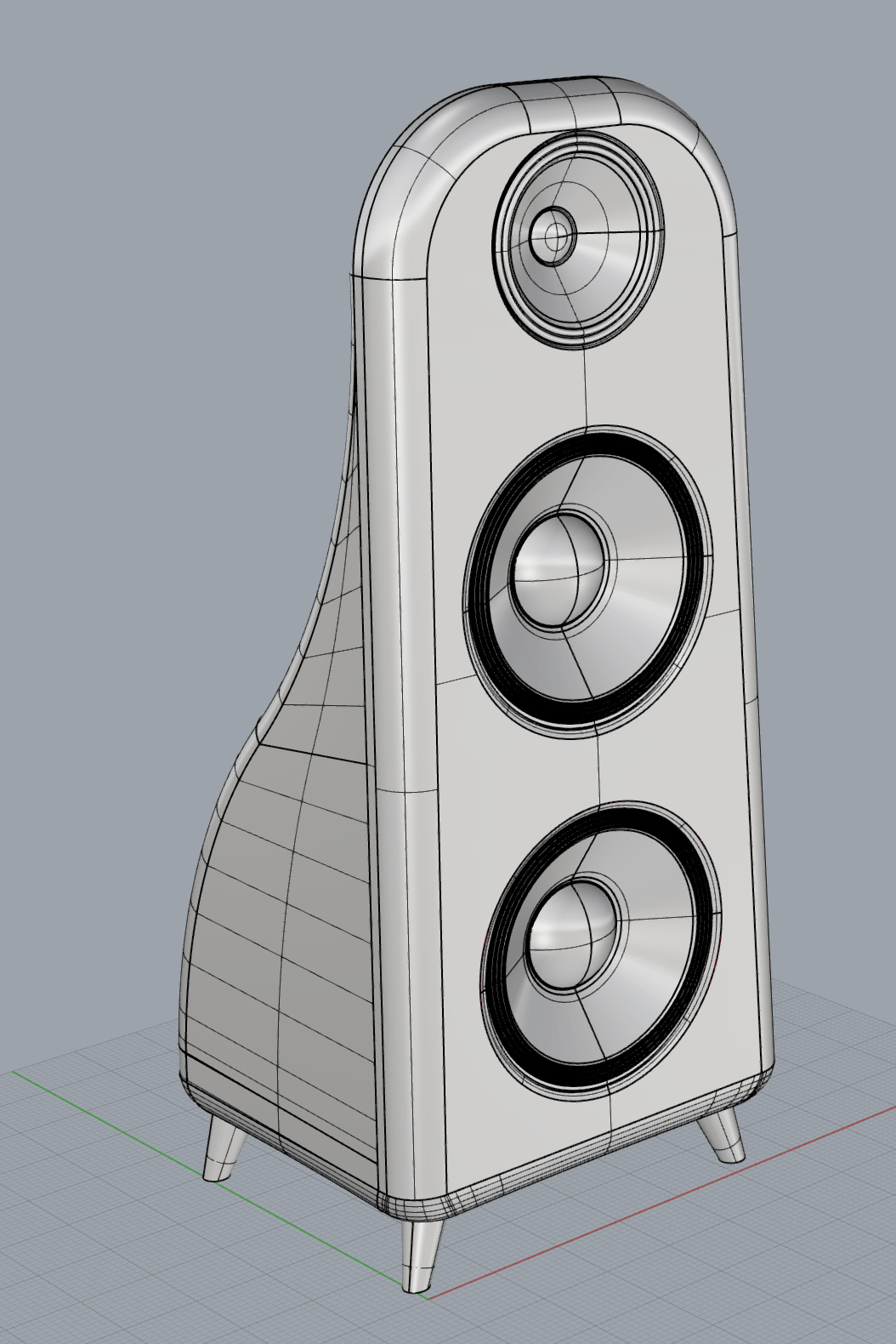

Excellent! Thank you for these hints, much appreciated.
My model is indeed curved.
I already stumble with the meshing and import. The application seriously lacks feedback in the import process.
I'll do what you suggest Thanks a bunch.
For my sims here, I did a simple piece wise linear approximation to the curve - just 4 points along the curved portion.
