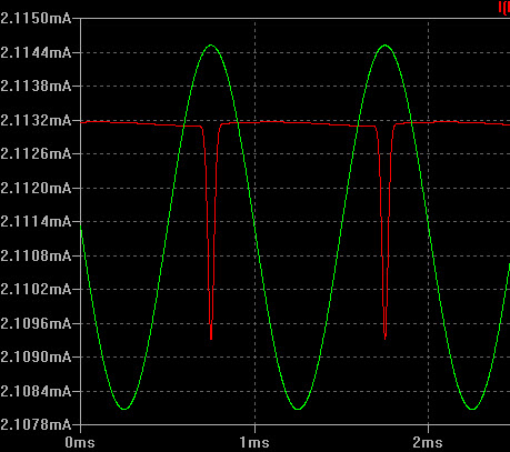

It's not really clear to me what the graph shows but if the red line plots the collector/drain current of a CCS which saturates at the positive peak of the output voltage (green line), then yes. Of course what we see here is just the onset of saturation--the 3.6 uA difference (relative to the 2.1 mA nominal current) won't make gross distortion.
