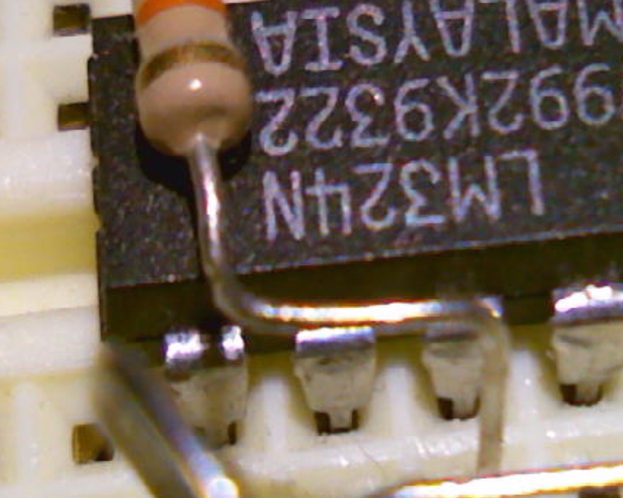

I have a "P2V" USB webcam from IPEVO (see http://www.ipevo.com/prods/Point-2-View-USB-Camera ). It can auto-focus down to about an inch on an object that's essentially planar. The software application can do digital zoom up to 3x.
The atch image is a standard DIP package and 1/4W resistor on a solderless breadboard, from about 1.5" and 3x digital zoom.
I think I paid US$60 about 2 years ago. The company runs specials pricing, package deals, etc from time to time. There's now a 2x clip-on lens for it with built-in light that I haven't tried.

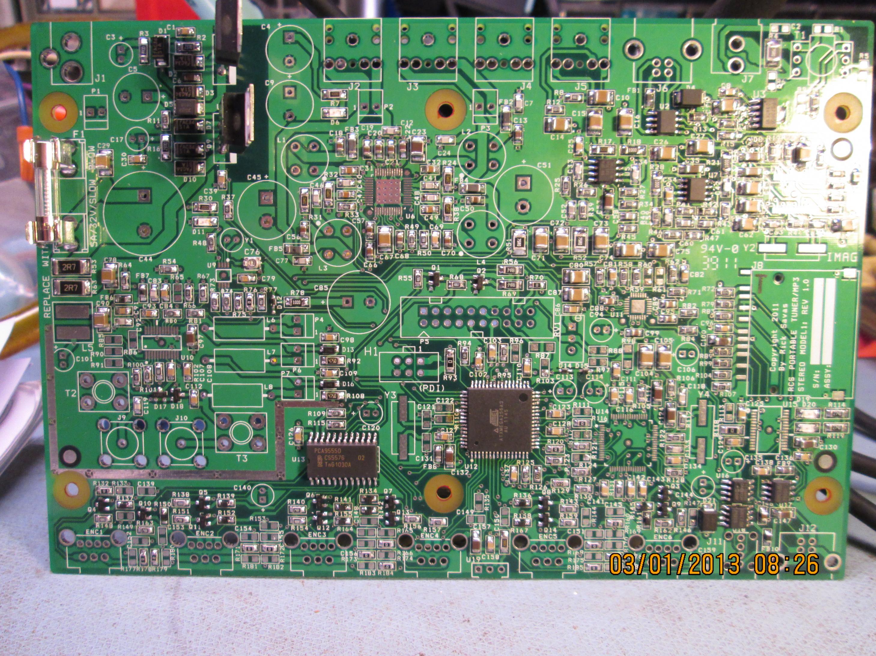

Hear is a picture of my latest creation, soldered using a 10x Loupe and my new magnifying head band from Amidon, no stereo microscope needed, although I have used a Leica in the past and they do help to speed things up, make sure to get one with the small circular fluorescent ring lamp.
I think Scott's suggestion of a USB based camera is the way to go.
You need two soldering irons as a must, it is the easiest way to remove/replace a two pad passive SMT part.
Good luck all, I am waiting to see what creations the members can come up with. I liked Scott's prototype as well.
