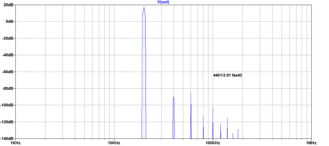

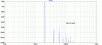

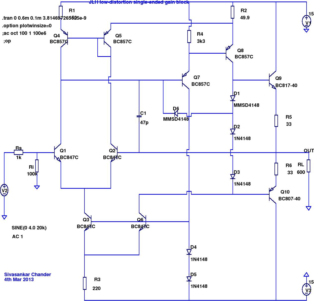

Folks, just a brief interruption from the regular scheduled program: Here's a 10-BJT single-ended variant of a JLH gain-block design posted earlier on this thread or elsewhere on this forum.
The JLH was FET-input, symmetrical and had a cascoded VAS. I have added the PNP buffer (aka Blameless/JE990), and retained the LTP current-mirror. The new trick is a matched differential current source for the LTP and the VAS, with a 1:1 current ratio between the LTP (combined legs) and the VAS.
Various other circuit elaborations are possible - cascoded VAS, cascoded JFET LTP, etc., but the minimal circuit shown above simulates pretty well as-is. It appears to work OK at fairly low rails as well as low bias currents in the gain block - down to 200 uA and below.
Edit: Added missing attachments. THD20 FFT shown is for 4V output amplitude into 600R - about -105 dBr, mostly H2 with the Class-A biased output stage shown.

what is the purpose of the series diodes in the circuit D4 and D5 going to the rail. Why do you need two diodes there...
Just a voltage reference of about 1.2 V. One could use an LED or a low-noise band-gap reference of 1.25V if noise is a concern. Two diodes are needed to ensure that the Vbe drop of Q3 and Q6 are exceeded.

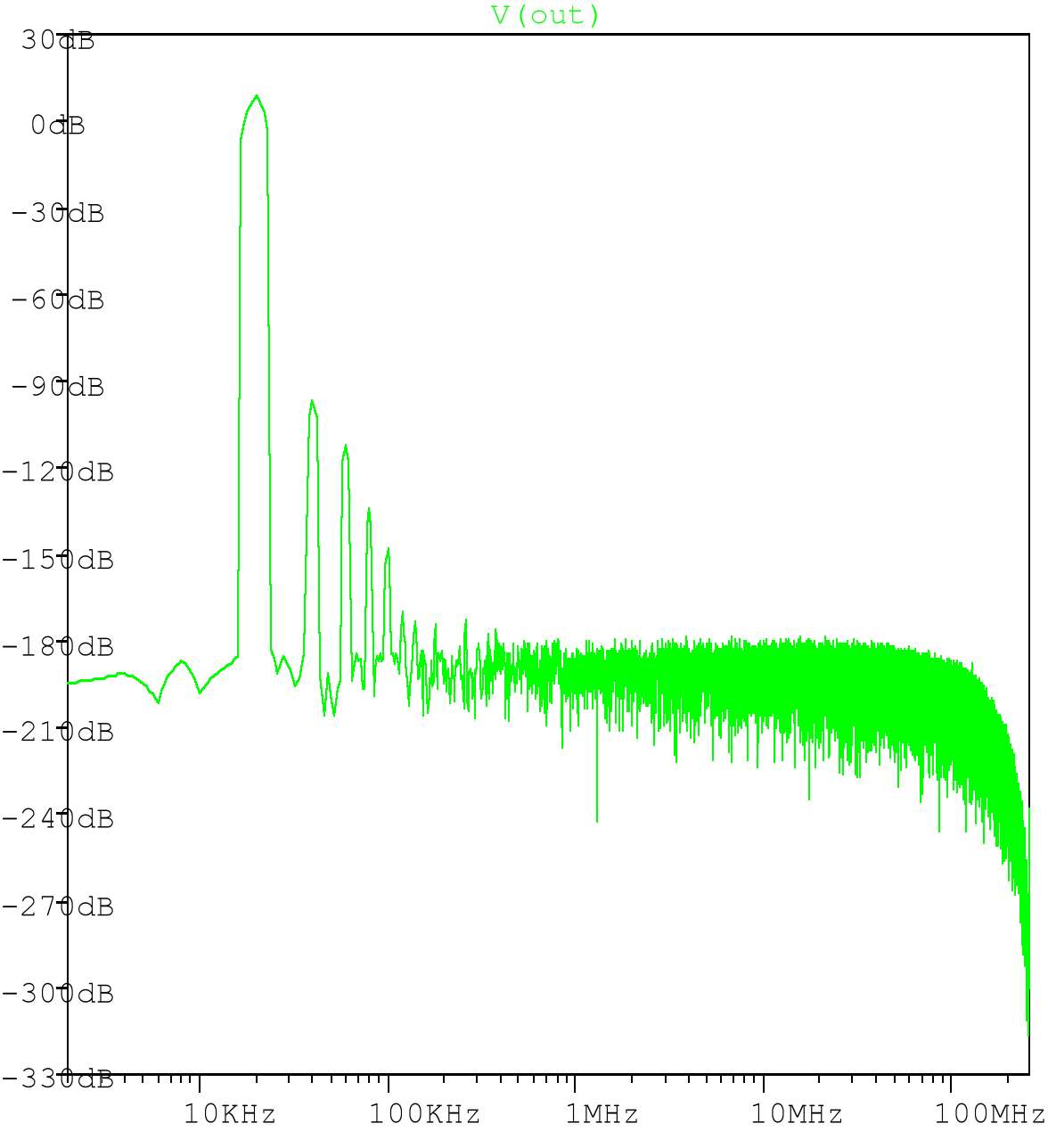

The circuit I posted at #2060 should do this. The attached curve is distortion @ 20kHz 10Vp into 600R. About -104dB for 2nd.Do you have a circuit that will be -140 THD+N ? Or greater than -130?
The gain is 40dB. This is in fact similar to the "distortion magnification" method that the uber makers use to get numbers for their uber OPAs. So I expect 2nd to be less than -140dB at unity gain. eg fig2 LME49710 datasheet
Of course, at these levels, decoupling, layout, earthing & other factors have as much, if not more, influence on THD. eg C5, which ostensibly is to reduce +ve PSR will also reduce THD in real life .. even with supa dupa power rails.
I pontificate further at

My Q9 makes it easy to select output bias current. The sim is for 7mA so Class B for 10Vp 600R
But you can't do 7) Omitting your D6 gives really nasty overload. BAV199 won't do much to help. It's not leakage but modulation of the junction capacitance that introduces the distortion. Unfortunately, ANY diode in that position will give THD only about that of the original 990.
