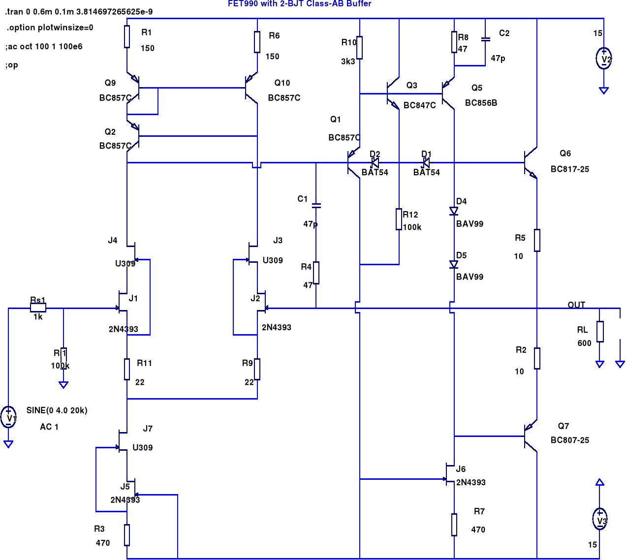

...in my composite op amp circuits I have used series diodes with bootstrapped center node

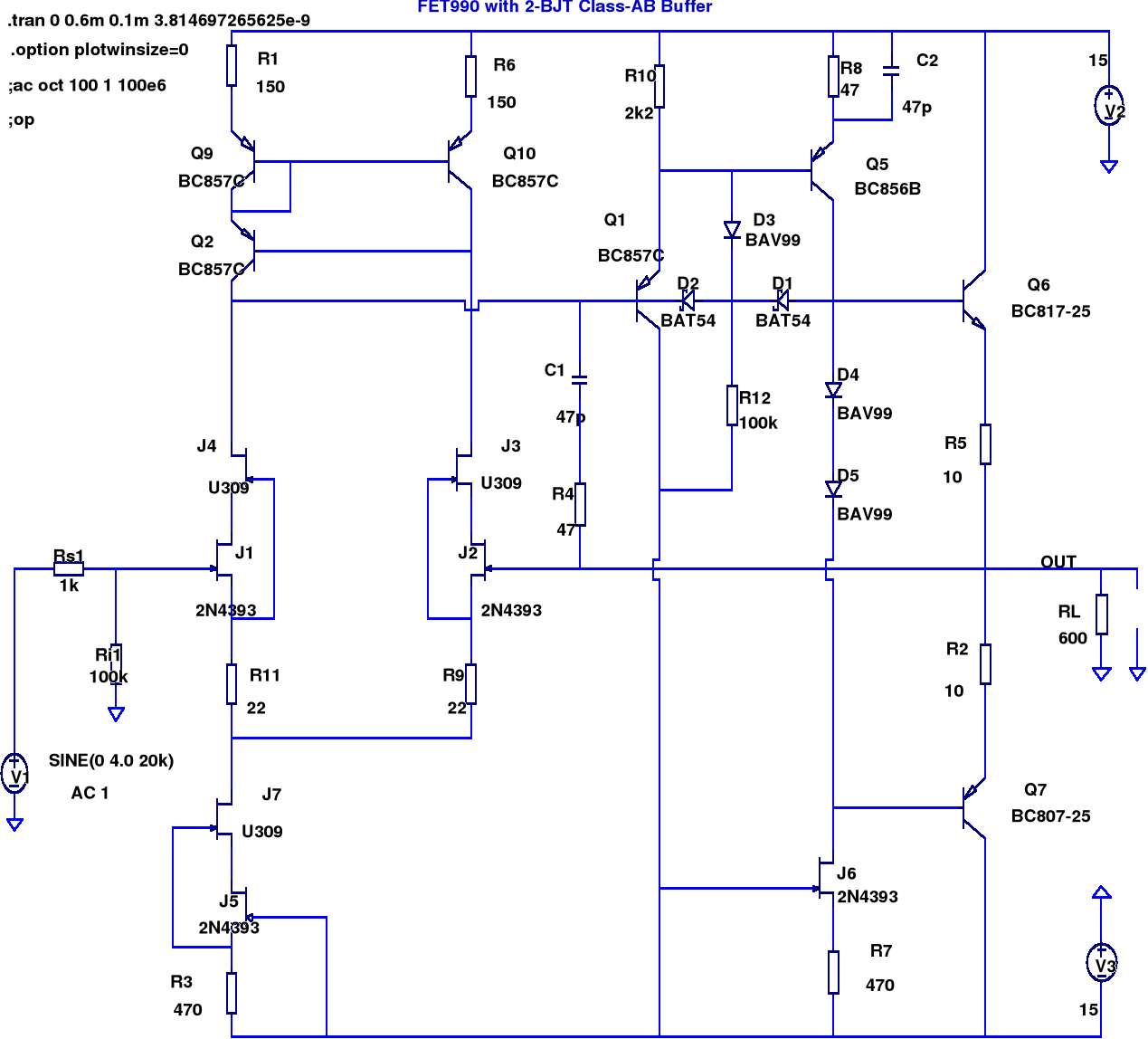

Thanks, great idea and works even in rudimentary form - bootstrapped a single diode-drop below the emitter of the emitter follower. A dual-diode bootstrapped from the emitter of the VAS may do better - I'll check it later.

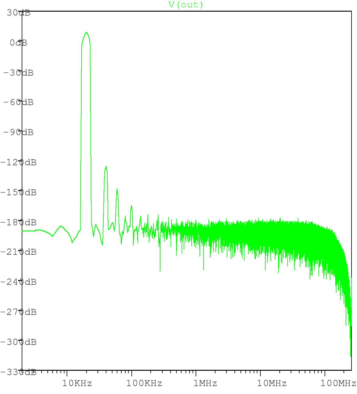

The simulation schematic below gets unity-gain THD20 down to about -135 dBr at an output amplitude of 4V into 600R - within shouting distance of -140 dB. Biasing the output stage to Class-A and a few other tweaks will probably help close the gap.
Unfortunately, I didn't squeeze the LTP Wilson CM into the board I'm expecting back shortly. However, the bootstrapping mod requires just two parts, and can probably be kludged in by piggy-backing the diode and resistor with some super-glue, etc.
Edit: At an output amplitude of 1V into 600R, H2 comes in at an even -150 dB, exceeding RNM's requirement comfortably, even with the Class-AB output stage biased at 3.5 mA.

...for my op amp multiloop circuits - I haven't simmed Scott's discrete front endjcx, have you've got something similar or even a sketch of such an application?
looking back over the thread I see that ultra low leakage was seen as desirable for the D3 diode - Pease article warned that leakage tempco caused huge increase in zero bias conductance - why I speculated that additional measures like bootstrapping series diode may be useful
but I don't have anything but handwaving for Scott's application
may be less important with "audio" mostly being "shirt sleeves" environment, discrete separates output Q heat from rest of circuit - not like monolithic op amp speced for industrial/automotive use

I've attached the .asc file - everything is stock LTspice library stuff, except the BAV99. In this case, they're all forward biased only, so the stock 1N4148 model should give nearly identical results in place of the BAV99s.
I don't know the specifics of jcx's implementation, only the general principle.
It's not necessary to limit the reverse leakage or charge-current into the junction capacitance of both D1 and D2. Only the one facing the base of the voltage follower Q1 needs to be bootstrapped - it's the non-linear current diverted away from the base of Q1 and into D2 that contributes to distortion. The other one (D1) can have relatively high charge/discharge swings without too much impact, as long as it's charged from a relatively lower-Z source (here that comes from the emitter of Q1 through the bootstrap diode D3).
So we need D2 to have a close to constant, preferably small, reverse-bias in normal operation. This ensures that there won't be much incremental current going into the junction capacitance. A small reverse bias also ensures that the DC leakage current through D2 will be small, thus avoiding DC loading/imbalance of the LTP stage. It also makes the the task of the clamp (D1) easier when necessary.
The potential for the bootstrap has to be drawn from some node which is at a similar AC potential to the base of Q1, but which *does not load* the base of Q1. The emitter of Q1 is a natural choice, and so also the emitter of Q5. The +Vcc rail is also a possibility, but it is a low-Z node, so it's not that useful. A voltage diff has to be generated for the reverse bias across D2, either capacitively or with a voltage reference. Here, forward-biased D3 acts as that voltage reference. R12 ensures that D3 stays forward-biased in normal operation. R12 could be replaced by a JFET CCS if there's a compelling need to keep D3 at a very constant forward-bias.
During overload/clipping, we want D2 to become forward-biased, which happens when the combined potential across D2 + D1 turns sufficiently positive. It shouldn't be too high, i.e. more than 2 Vbe, or Q5 will go into saturation without the clamping action of D1 + D2. Hence the need for at least one Schottky in series in D1 and D2. I tried it with two Schottkys, and it still shows acceptably low charge/discharge currents into D2, so I left it unchanged. D2 could be a standard or low-leakage Silicon like a BAV99 also, in which case Q5 will go further into saturation before clamping begins. If both are Schottkys, it probably helps to go with a pair with relatively high reverse-breakdown voltage (maybe a bit higher than the 30V specified for the BAT54).
During normal operation, the AC impedance to ground at the junction of D1 and D2 includes (R10 || R12), which is fairly low - around 2k as shown. However, during clamping, D3 switches off and D1 is looking only at R12 to AC ground, which is relatively high-Z (100k) so the clamping action of D1 + D2 is relatively unhindered (as jcx mentioned in post #2811).
..Here, forward-biased D3 acts as that voltage reference.
Upon reflection, an NPN emitter-follower probably works better than D3 as the bootstrap reference. A diode in series with the emitter may be even better.
